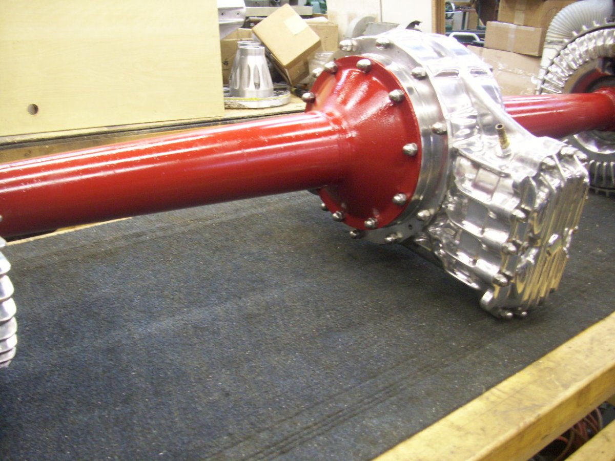

    This is an 11 bolt Halibrand Champ with H852 side plates. It is fully polished and has Buick finned drums, Wilson Welding backing plates, stainless acorn nuts, and all good stuff inside. The axle trumpets are just spray canned for now until the brackets are welded on and they get powder coated or chromed.
    The pictures could be a lot better because the background is cluttered and I couldn't get the angles I wanted. When I get it out of the shop I'll take some more.
    If you see Johnny Porter, tell him his rear end is prettier than John Cato's.
    I hope this puts to rest any questions as to whether a guy should have a 100_5235.JPG 100_5236.JPG 100_5237.JPG 100_5239.JPG 100_5240.JPG Quickchange or settle for a Ford 9".

    You have really nailed it. That sets a new standard for hot rod rear ends. I want mine to be exactly like that. I'm sure more orders will come.
    By the way, I looked it up last week. Someone is reproducing those Ford trumpet housings. Can't remember where right now.

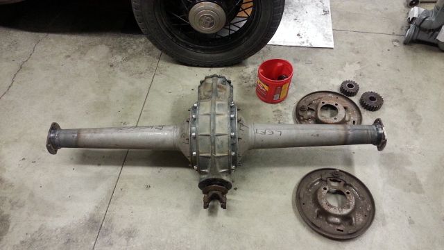

    I received a lead on one from the HAMB post and I will see where that leads me. I have never found any in recent years that were good and inexpensive. I used to pay $250 for a bare case sometimes with a lower shaft but not always. I only purchase excellent cases no welded pinions, snouts or broken holes in the bolt circle. You did my first QC in the 80's and it is still doing well under my heavy foot.
    I did this one my self after retiring in 2001.
    You did this one for me in the 80's. Note the Allen head countersunk bolts on the side plates. Your Trademark!

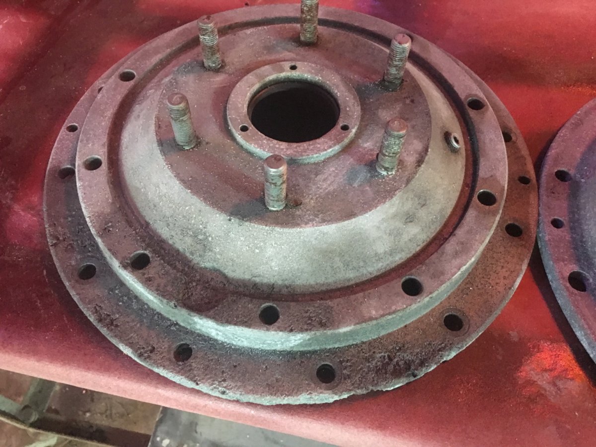

    Here's a few pics of what 500 will get ya for the halibrand side plate adapters IF you can find them. I've seen some nicer pairs for 7-800. But I haven't seen another pair anywhere since I bought this pair almost a year ago ImageUploadedByH.A.M.B.1460485828.484611.jpg ImageUploadedByH.A.M.B.1460485843.686548.jpg ImageUploadedByH.A.M.B.1460485865.606214.jpg ImageUploadedByH.A.M.B.1460485877.924458.jpg
    These will get the job done but the corrosion on em is pretty gnarly. Be awesome to have a fresh shiny pair. I hope some more of those checks have come in Bruce.

    Yeah, those are rough. The brand new adaptors from GearheadsQCE are better and less expensive!

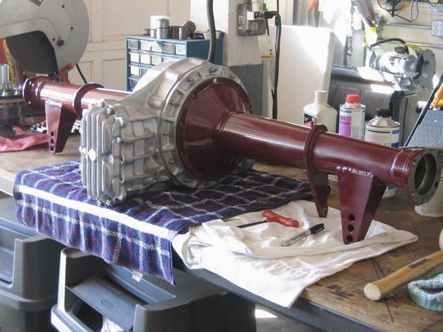

    I came up with this cut-n-paste of the Champ style vs the V8.

    Two completely different looks under a hot rod are achieved with the Champ and V8 quick changes. Normally, the V8 looks better (smaller) under a Deuce while the Champ (larger) looks better under a 33/4 Ford. I prefer the Champ but that is just me. The V8, either a Halibrand or Winters, really are the choices of most builders today. The quality upgrades of the Winters is the way to go if you want serviceability and support from the manufacturer. Here are some photos to compare the looks of the two types.
    My favorite is the Champ with the adapters for the early Ford axle housings. Today, this set up can be costly.
    The new Winters is ready to go out of the box under $2500 with axles.​
    The V8 just peeks out from under the gas tank on a Deuce.​
    The Champ stands out for some serious HP.​
    The V8 is by far more popular than the Champ.
    AMBR has the V8 installed and looks sexy in my mind.​
