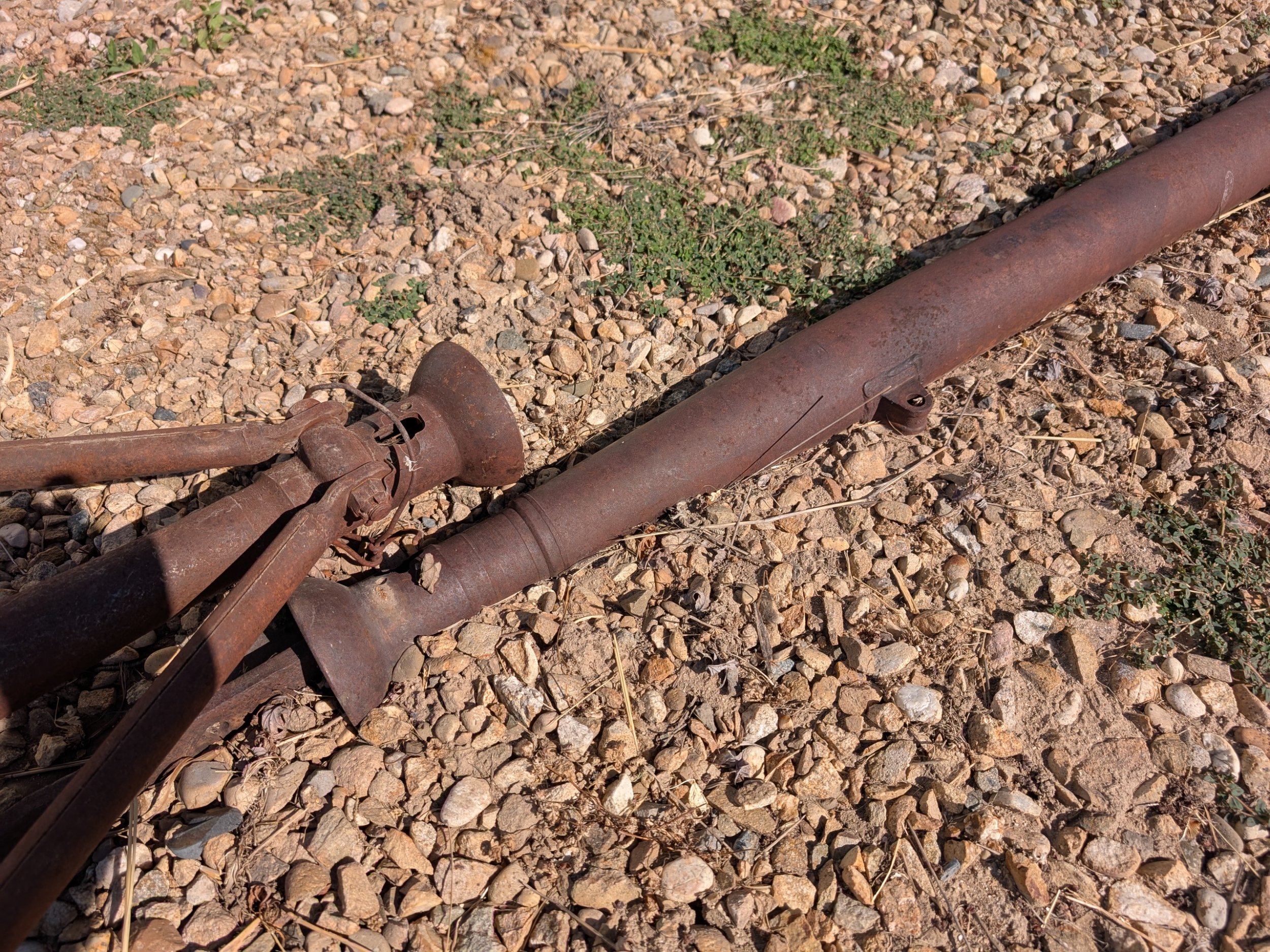

    I found a Hilabrand Quick change that my Model A bells fit but the torque tube stud holes do not match the Quick Change banjo. Does anyone know of a fix for this? Would a later model torque tube work?

    No it won't. Elongate the holes in the model a torque tube.

    Or turn the torque tube 30 degrees and redrill the Quicky case. I'm sure Gearhead has a solution. I've seen Sprint Car cases with 12 holes and half of those with pulled threads.

    Not real easy to relocate the radius rod mount on a Model A torque tube like it is on a V8 torque tube.

    Whenever I chop up a torquetube I always save the radius rod boss. If you need one I can get you one.

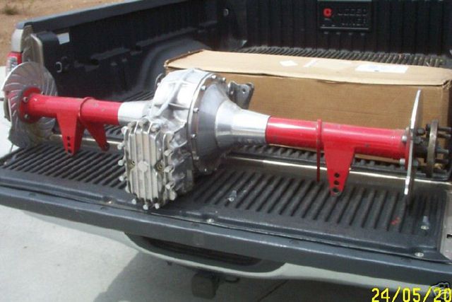

    Note to anyone interested. I have the rearend pictured here by Pewsplace, removed fromVic Edelbrock's roadster. It is for sale. Send me a PM if interested. Apology's to Gearheads QCE
    for interrupying this thread.
