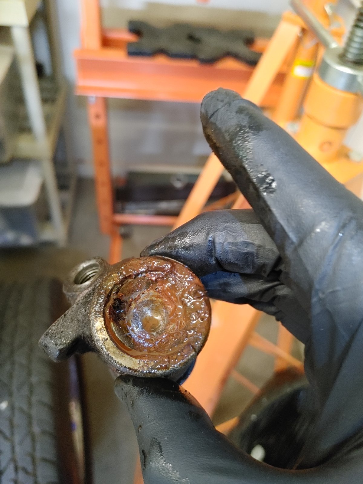

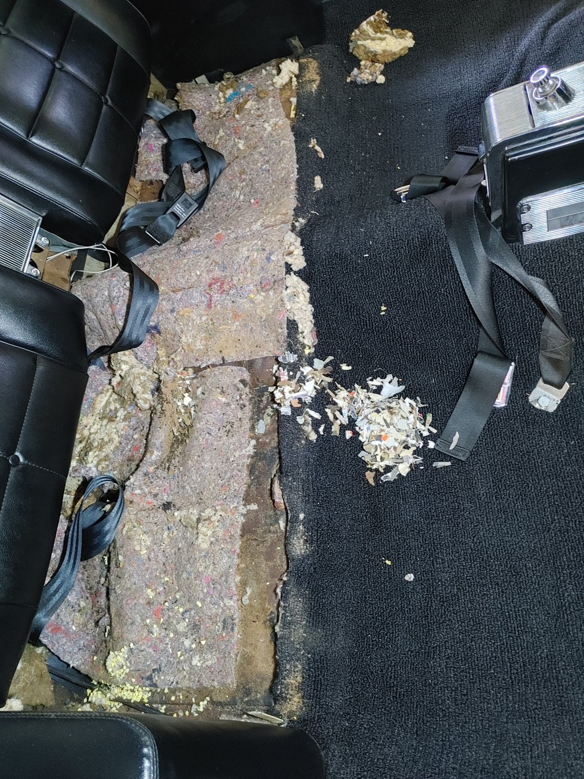

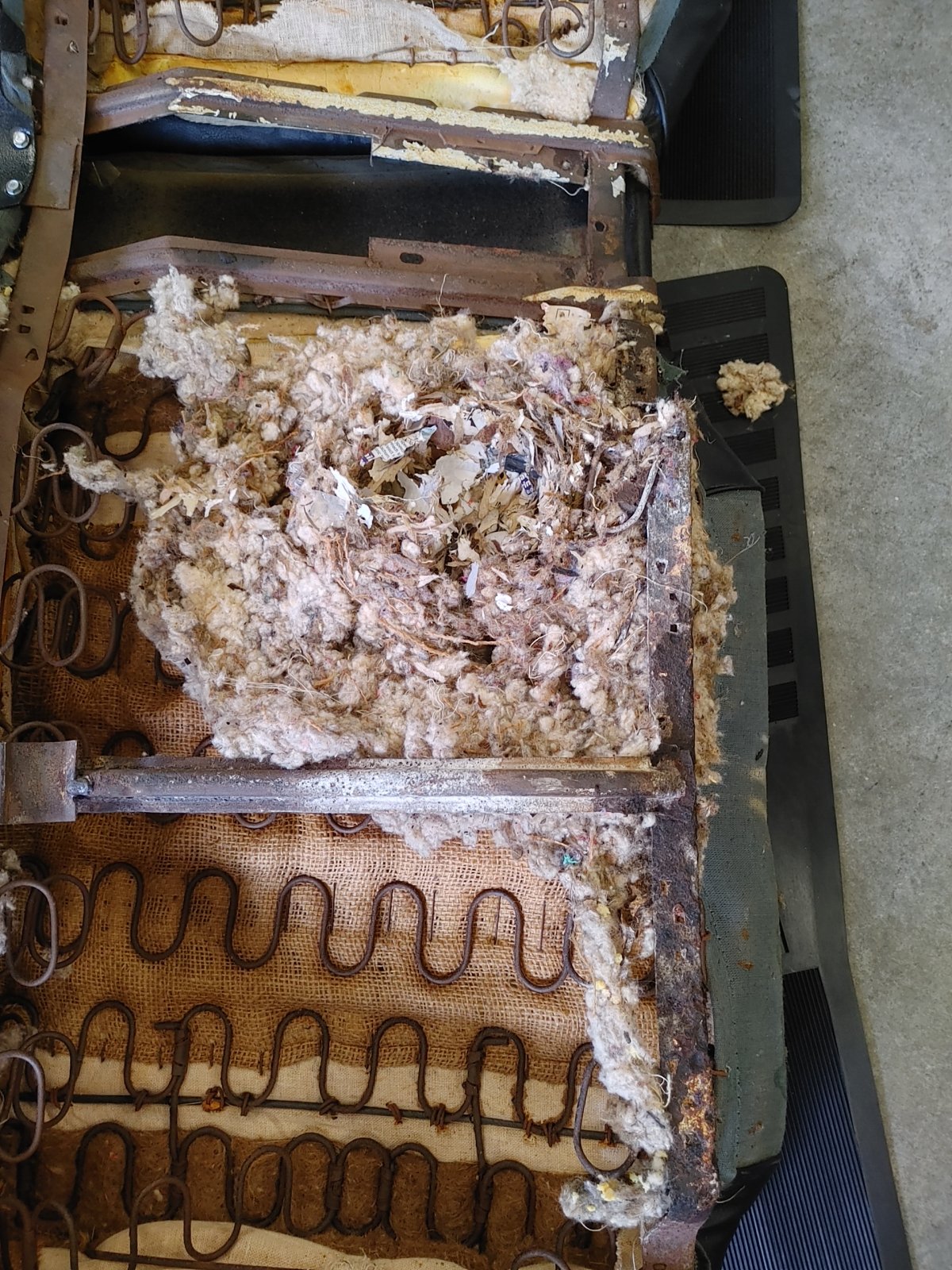

    De-mousing is complete, except for the headliner. It will be late July before it arrives. Meanwhile, there is no shortage of things to do. I rebuilt the original AFB because it has linkage that works the switches for the switch pitch ST400 transmission.
    The engine had a tick in it, so I removed the valve covers, intake and valley cover to inspect. I found absolutely nothing wrong. So, while it's dis***embled, I sandblasted all those pieces and am now waiting on favorable weather to paint them.
    Since I couldn't paint, I decided to inspect the brake system. Yikes! The MC had about 1/4" of rusty brake fluid in it. I sure am glad I didn't drive it home that way. After checking several other things, I decided that I am going to leave the brake system stock. So, I ordered wheel cylinders, hoses, master cylinder, front wheel bearings, etc. Everything but the steel tubing and the vacuum booster will be replaced. Fortunately, the drums and shoes are great. Unfortunately, I won't have parts until next Tuesday.
    The cooling system is going to require major flushing action, as well. I cannot believe how someone will own a nice car like this and do absolutely no maintenance on it for over 11 years. Some people just have no clue, I guess. I also ordered new tires to replace the new 13 year old ones that are on the car.

    I never cease to be amazed with what people get away with on their cars. Brake maintenance has got to be one of the most important things in owning a car. This one was pathetic. The drums and shoes are great but I am replacing all of the hydraulic components. If I drove a car like this, is would be in a wreck in short order. How do they survive? Glad I didn't drive it home.
