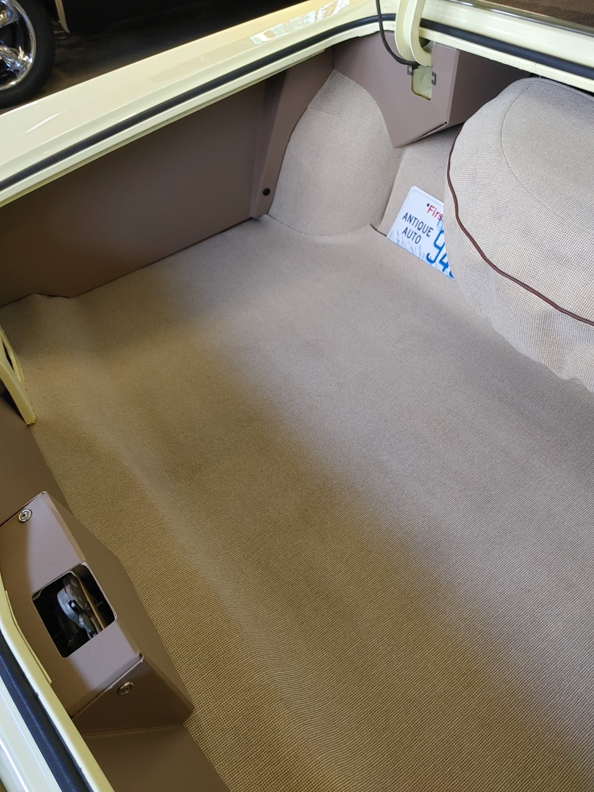

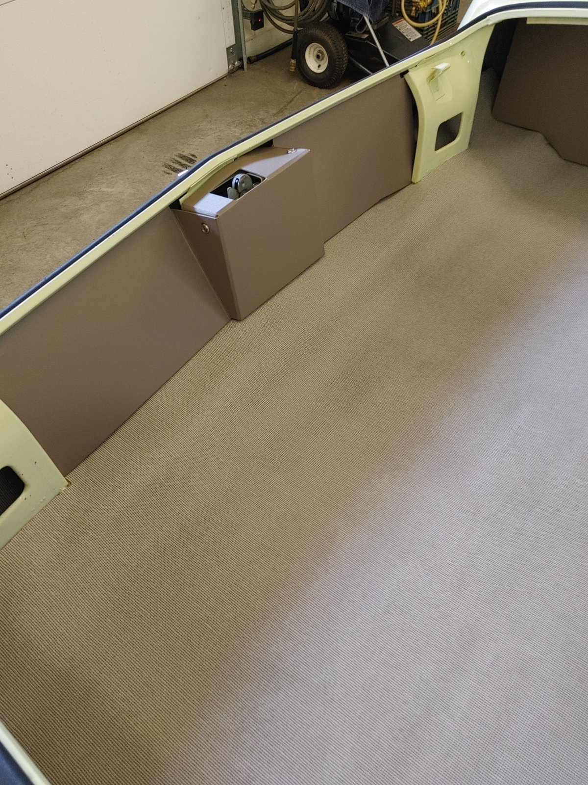

    Installed new cardboard panels and cleaned up the original trunk liner.

    That's going to be so nice you won't want to drive it!

    Oh yes, I will. Drove it 100 miles this afternoon! If you've got a cool car and don't drive it, it's like having a hot girlfriend and saving her for the next guy!

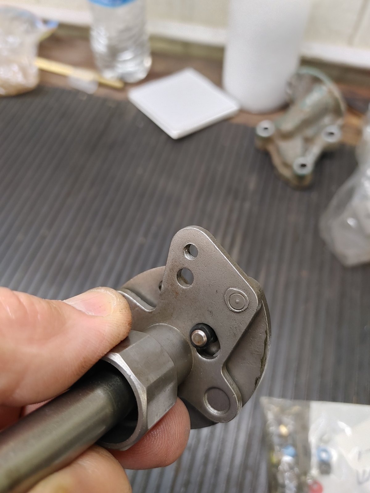

    In an attempt to improve gas mileage, I recurved my distributor. This requires disassembling the distributor. Be sure you know how to put it back together.
    First, you must replace the plastic bushing that deteriorates and falls out. This restores your initial idle timing. I used a piece of plastic tubing that is a snug fit over the pun.
    Next, you need to limit the vacuum advance. I measured 18 degrees of additional advance and that was more than I wanted. So, after some careful measuring I determined I needed 5/32 travel to give me 12 degrees. I made a small stop out of sheet metal, tapped a 6-32 hole in the vac can bracket and put it together for a trial fit. After some filing and sanding, I snuck up on 5/32".
    The distributor was reassembled and springs added. Prior to disassembly, I had experimented with different springs and got a combination that gets my mechanical advance all in by 2500 rpm.
    I stabbed the distributor back in and set the timing at 30 degrees btdc with all mechanical advance in and vacuum disconnected. I tested my mechanical advance using a hand vacuum pump. It starts coming in at 7 degrees and is all in at 13 degrees.
    All you need to do this are your hand tools, a digital timing light (displays rpm, as well as timing) and a hand vacuum pump with a gauge.
