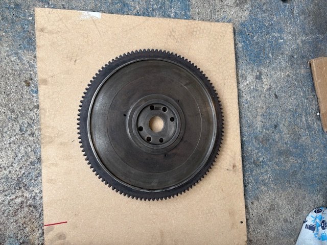

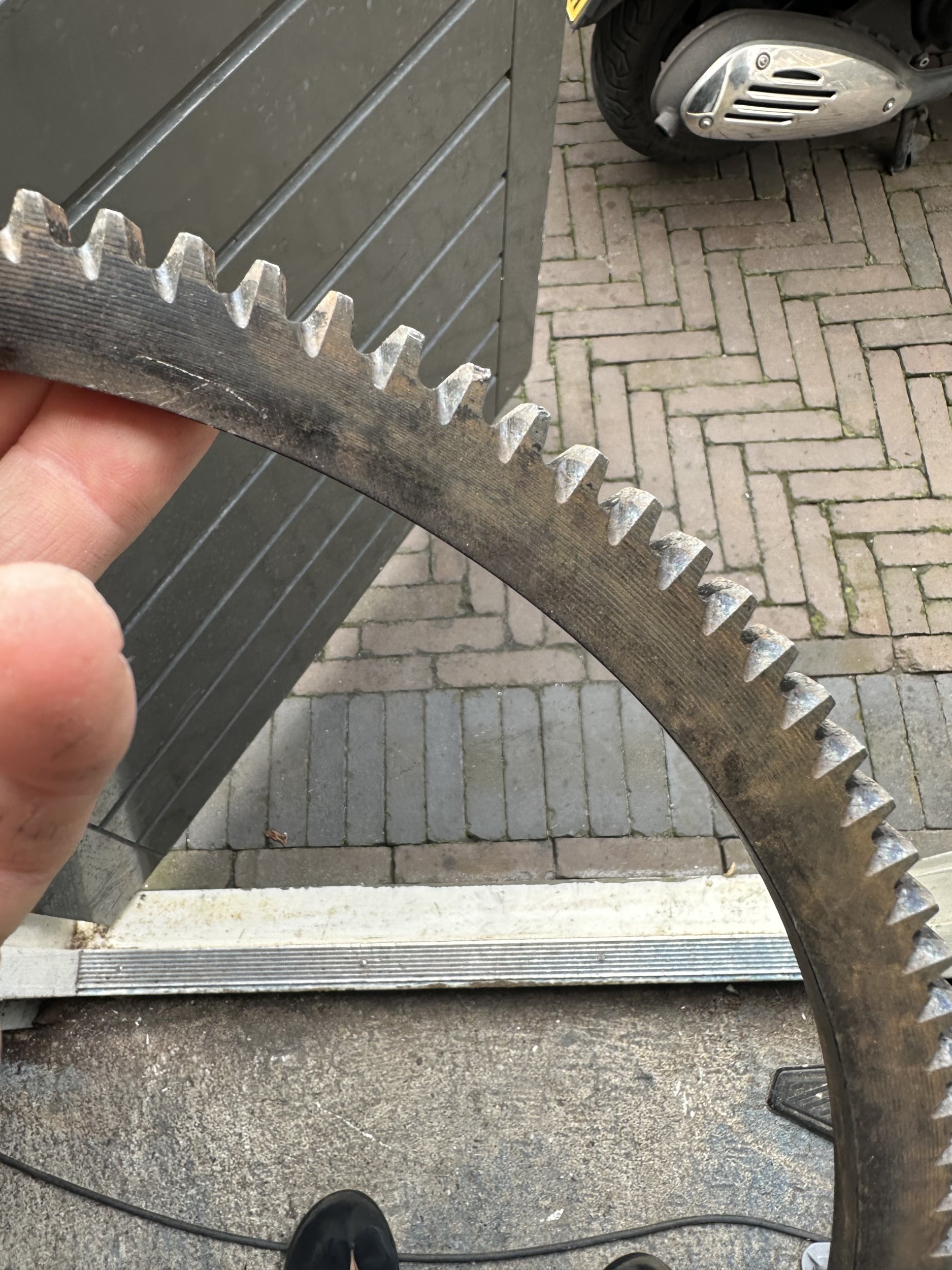

    I'm gonna replace the worn ring gear on my French flatty.
    I have one that is the right diameter inside and outside and the correct number of teeth.
    It seems It has a front and back side , I guess the side with the little diagonal surface goes to the transmission side since the starter is a pull style ?
    Do i have this right or ??
    And if I want to use a mini starter do a place the ring gear "backwards" since a mini starter is a push type.?
    This will be the first time for me to replace a ring gear and the old is to worn to seen. anything about placement .
    I want to get this right.
    ring gear.
    Pull type ?

  2. I would install it depending which starter you go with. The teeth on both the ring and pinion have bevels ground in them to help the two gears mesh together upon starting the engine.

    So the beveled side faces the side of where the starter gear comes from ?
    Algoma56 likes this.
  4. Yes. The direction will dependent on which starter you choose. Standard bendix will have the ring gear bevel facing the transmission, mini starter will have the ring gear bevel facing the engine.

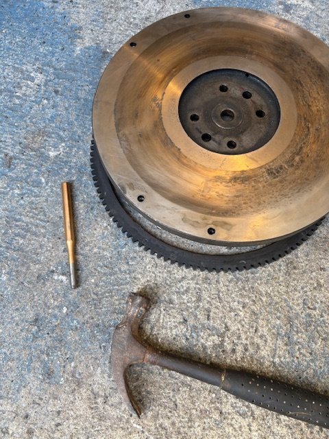

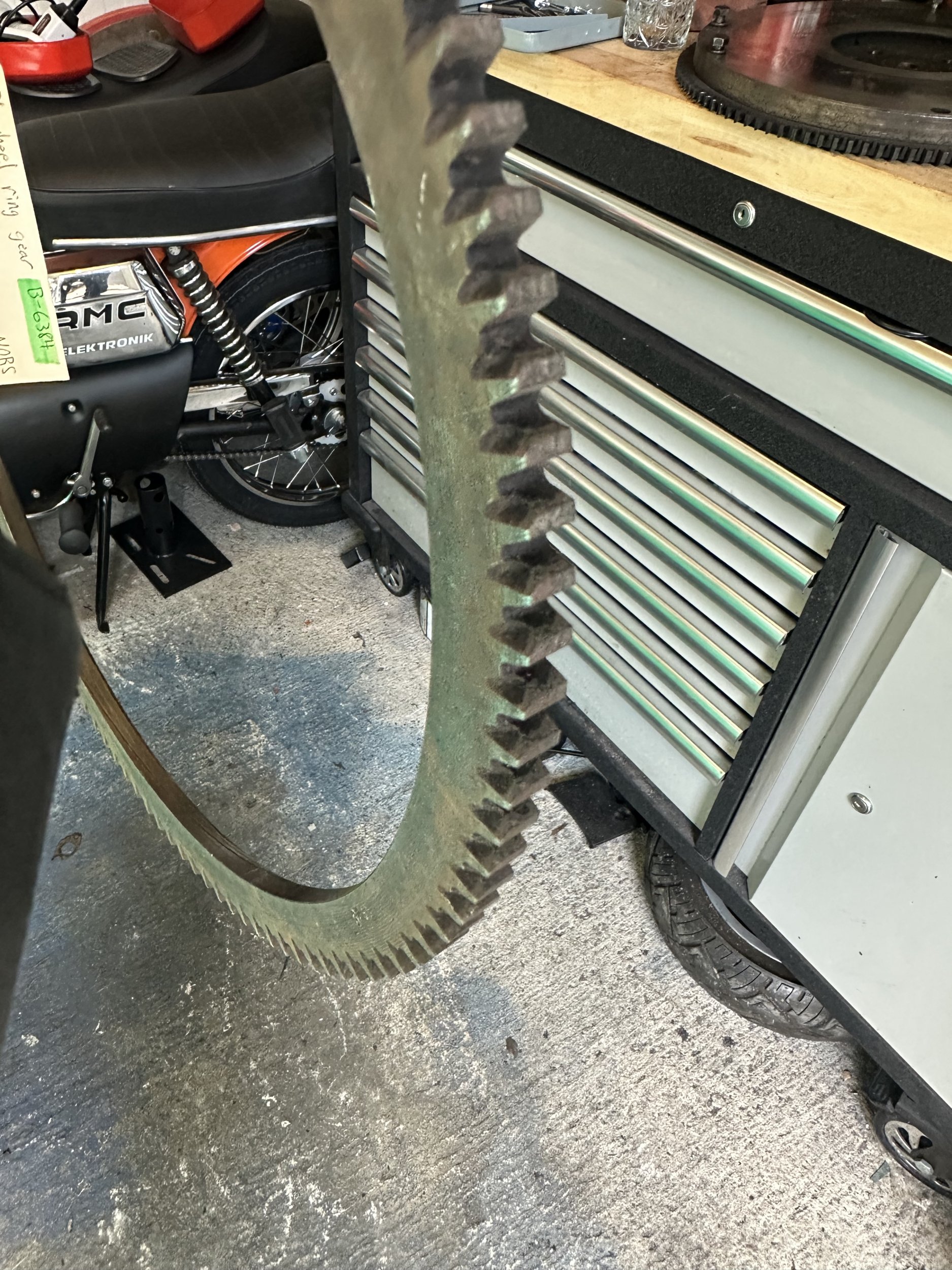

    This was real easy , the old ring gear i could get of cold with a punch and light hammer tapping around a few rounds.

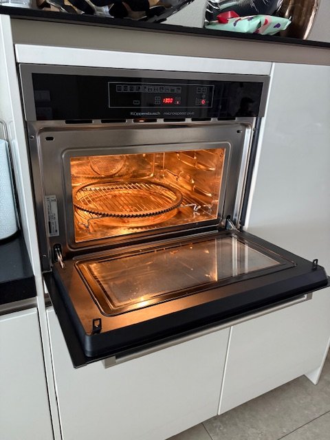

    The flywheel in the fridge and ring gear in the oven on 200 celcius for 30 minutes.
    The ring just slid on , no tapping needed.
