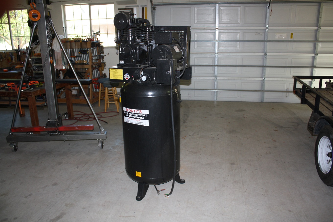

    My compressor is a combination of two different swap meet buys and one craigslist purchase. The swap meet tank is an upright 8o gallon from a "Black Max" (Sanborn) that had been in a flood, ruined the motor and compressor. The compressor is a swap meet two stage Kellogg that I put new poppet valves and springs in. It still had a crosshatch in the cylinders. The motor is a 240 volt Siemens 5HP that some old pants pisser had for sale on Craigslist. The motor cost me twice as much as the tank and compressor combined, but it's one hell of a machine.
    vtx1800, carpok, Algoma56 and 2 others like this.
