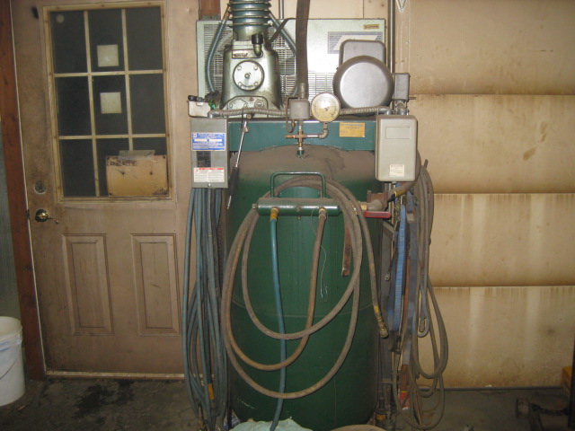

  10. I have a Ingersol Rand vertacle 60 gallon 22 year old compressor. It is rated 15CFM @ 175 PSI. Has been a great compressor. I paid $1,700.00 for it back then. I have just sold my place and the new owner wants the compressor . I am going to keep it and take it to my new place. I am afraid of buying a new one and it goes south in a couple of years .

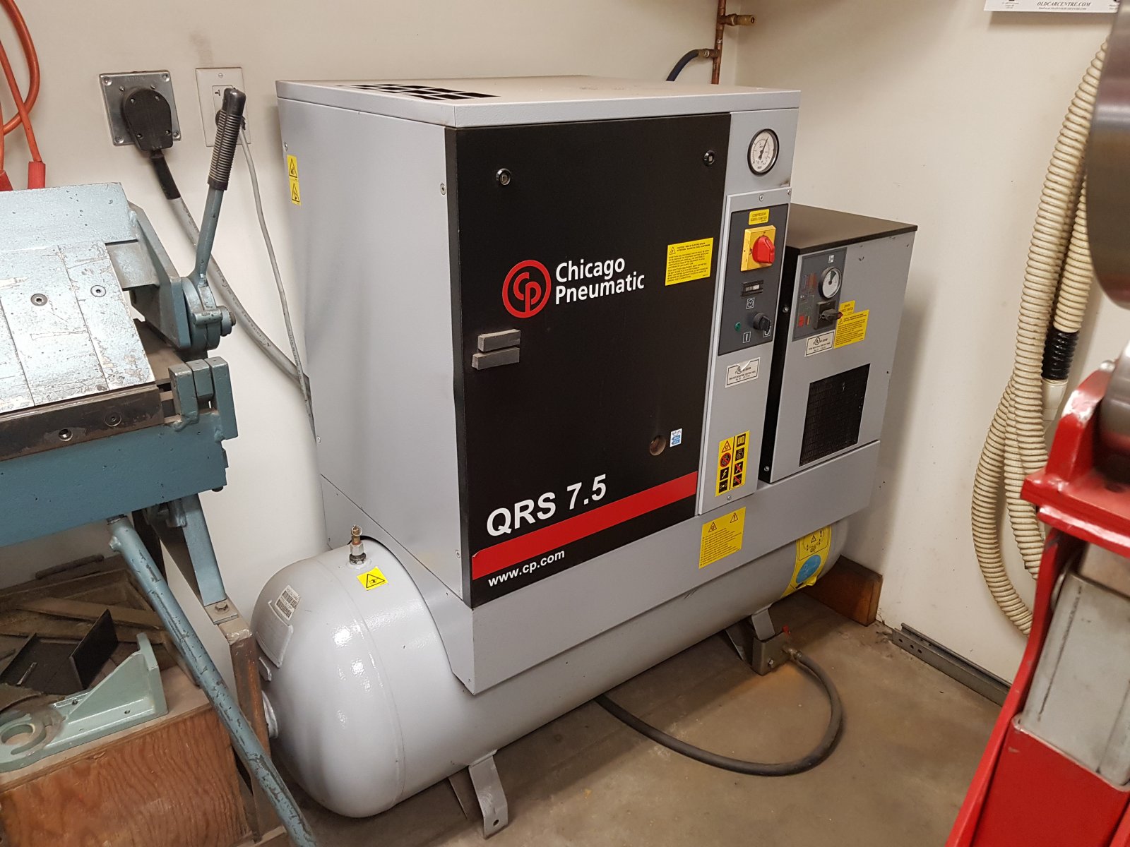

    This is mine...7.5 hp, screw, with built in dryer (for painting). Lots of air and quiet (can hear and talk on the phone when its running). I wore out 2 Eagle brand 3 cylinder compressor heads before going this direction. Very happy with it.
    rusty valley and nochop like this.

    Very nice, looks expensive though !
