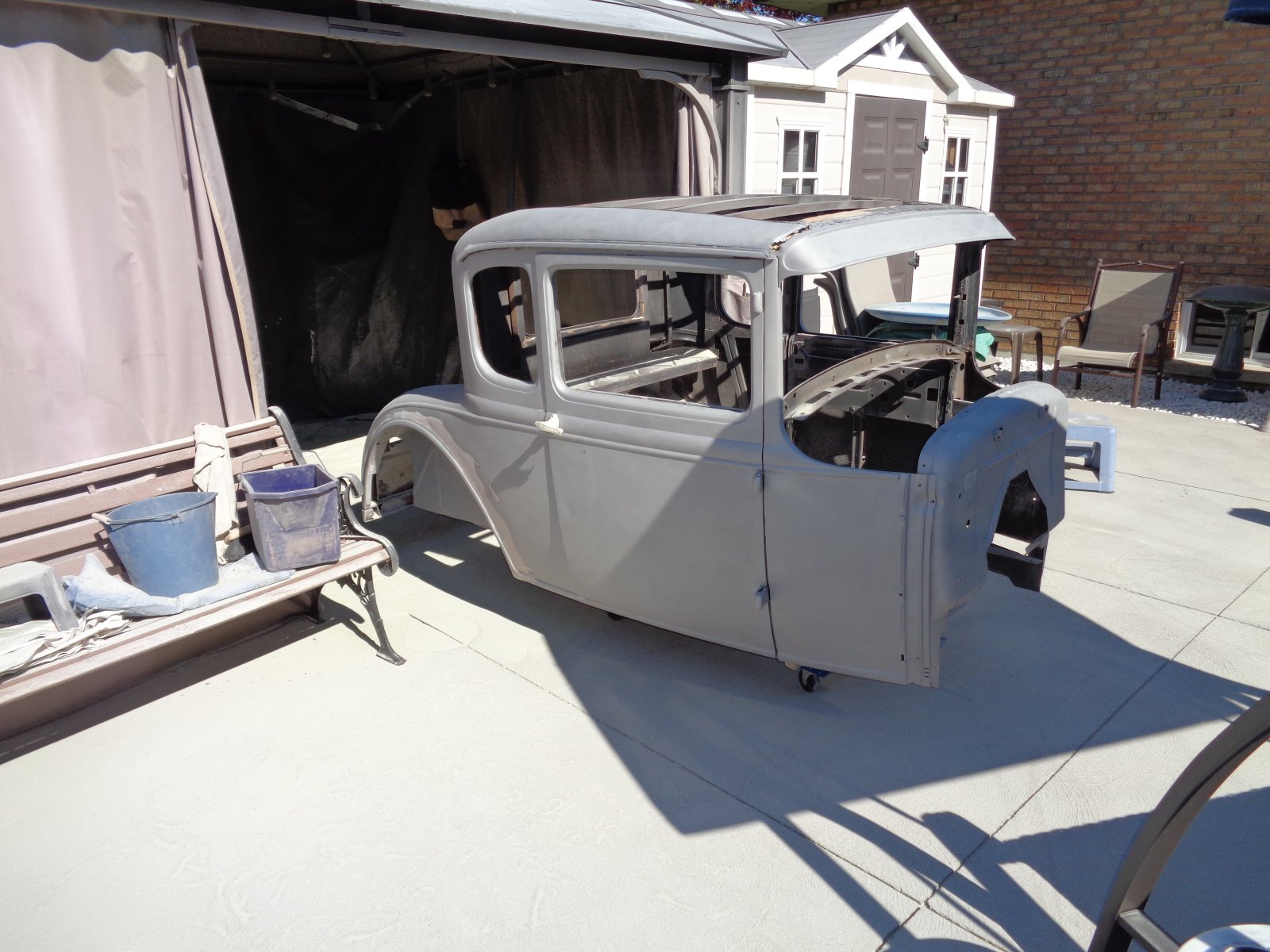

    Wow!!! What a terrific encyclopedia of responses! My tired old brain will be 2sizes bigger by the time I digest all of them. I would like to get in the car and come shake hands with all of you. Also love all of the photos. My heart goes out to those who served in Viet Nam. I served an extended tour 64 & 65 with MACV & was exposed to Agent Purple for 6 months & then to the “safer” Agent Orange for 9 months. That is why I’ve had 30 heart operations since 96. I also have PTSD (80%) & poor memory which is why I will save all of your responses. Many Thanks, Rod
