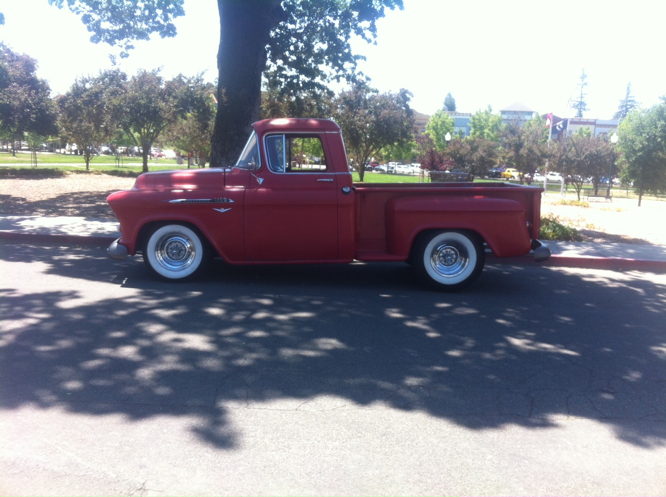

    Time for a change up.... Torq Thrust TTO's with 215/70 on the front and 255/70's on the rear! OMG it so killer! Rides and drives great... Here's a snappy for ya.

    Sorry for not getting back to you earlier on this. I thought the ride was really great on smooth roads when the truck had Mono-Leafs front and back. My commute in the AM is fairly easy and heads straight down the HWY so for the most part I was pleased, but in Sonoma County anything other than the newly re-paved HWY is SHIT.... So I opted for the new Posies Dual Slide fronts and their multi-leaf rear spring. Still rides like a truck on rough roads but it's much improved vs where I started. I will admit that it kinda killed the look a little but switching out to the radials and TTO's last night has helped the stance and regained a little coolness. If you are going to keep the Mono's in the back, make sure you C-Notch the frame. And if you are planning to haul a load here or there just make sure you have a air-bag assist or something along those lines to help the springs out.
