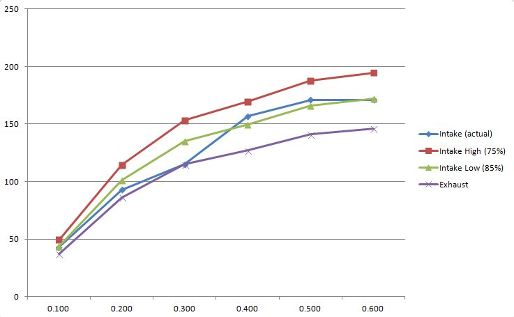

    Turns out the head flows between the middle and end cylinders were within a few CFM of each other. That tells me that the exhaust port, at least in the stock head, isn't really a big factor in the flow- the valve and seat area is probably where the most restriction lies.
    It also appears, and I'm no porting guru, that the intake is severely restricted (compared to the exhaust) at lower lift numbers. The shop is going to unshroud the intake valves as best they can and back-cut them to improve flow at low lift. We'll get the result flow tested again and see how much it helped.
    Maybe I should start a kick-starter campaign to pay the flow bench guy? :)
    The graph in the first attachment shows the flow result. In the second attachment I have added boundaries for where the intake valve should be compared to the exhaust. From what I have read, you want the exhaust to flow from 75% - 85% of what the intake flows. By these charts you can see how I developed my conclusion that the intake flow is the problem at the lower lifts. The intake flow is in the proper range above .400 lift. Below that it is deficient. The range where the intake flow should be is shown by the green and red curves in the second attachment.
    Once this is balanced (intake flow inside the green and red boundaries), it definitely doesn't mean that the flows are acceptable for the application, only that the relationship between the intake and exhaust is correct. The engine should at least be breathing efficiently. From there, both the intake and exhaust may need to be opened up further.
    And I'm not sure you can ever get there from here. We'll see what happens after they work on the intake a little. Could make things worse for all I know! Hopefully someone here that knows more than I do can chime in.

    Progress! Crank is done, including drilling the end of the crank for the bushing used with the manual transmission. Short block is ready to be ***embled.
    In the mean time we have finally had the head flowed after one of the ports was modified. The result is below.
    You'll note that at .300 valve lift, the intake really doesn't flow much more than the exhaust which is a problem (115 vs. 115 stock, 123 vs. 118 ported). With the stock ports the intake and exhaust flowed the same at .300. The head porter will continue to work on whatever the restriction is in the intake at .300. If he can fix that the intake flow will probably go up across the board.
    The rule of thumb is that the exhaust should be between 75-85% of the intake. That is what the red and green curves depict. If the blue line can stay between the red and green lines, this aspect should be optimized.
    At .600 a SBC 462 casting is at about 218 on the intake and 137 on the exhaust. The stock exhaust was about equivalent to the SBC, but the intake is where the work is really needed.
    I'll post again as soon as the results of the additional work on the intake port has been completed and flowed.

    In case you can't tell, I have a great interest in data, that's why I bothered to get the stock ports flowed for comparison purposes and make all these graphs.
    The porter told me that cutting the back of the valve might help and I figure that reducing the diameter of the valve stem might help too, but not sure if the valves have enough meat to do that.
    If they can solve the intake restriction at .300 lift the flow bench testing will have been very worthwhile I think.

    The head porting is finally done! You can see the numbers in the illustration above.
    The biggest concern was that at .300 lift the intake and exhaust flows were nearly identical. The exhaust flow should be between 75% and 85% of the intake flow according to the "experts." The porting was able to get it to 87.5%.
    The blue line is the actual intake flow, the purple line is the actual exhaust flow. The red and green lines may be confusing, but they show the upper and lower limits of the 75% - 85% range; that's where you want to be. As long as the blue line is in-between the red and green, flow rate is optimal.
