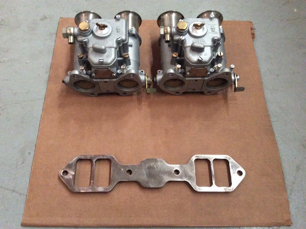

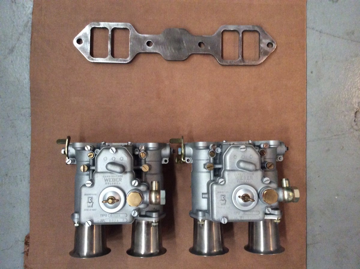

    Someone said I wasn't planning on enough carburetor for my build, so now I'm thinking about this: 4 antique eye-talian Weber 45 DCOEs.
    Good idea or bad? New, yet old...

    This car has a low hood-line, so the intake manifold design is a challenge. Working on it! :)

    Your four 45DCOEs should be plenty of carburation, and they will look and work great! I have three on the Jag (only about 240 cubic inches) making around 300 hp. Rob runs three on his 12 port GMC (320 cu in) making about 350.

    Getting near the end of the process finally! Still working on the intake manifold fabrication for the 4 Weber 45DCOE carbs.
