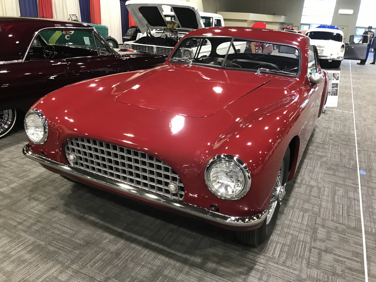

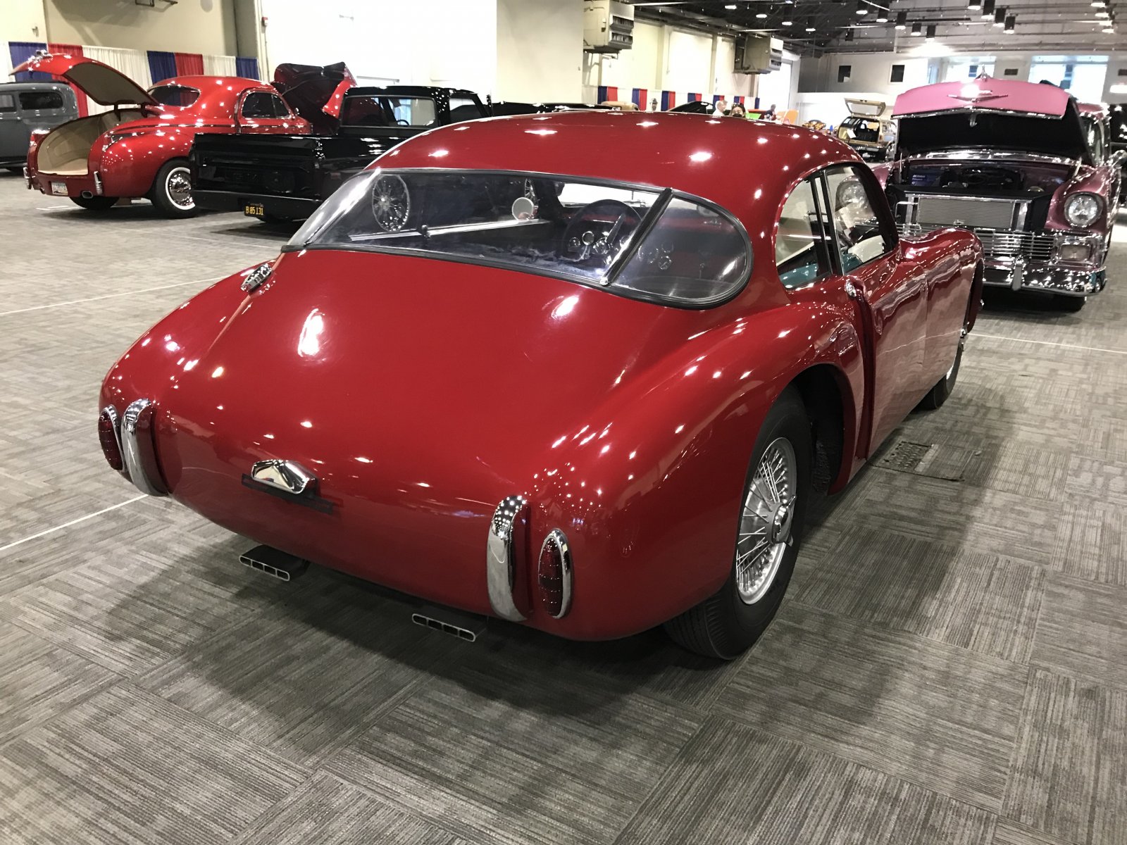

    Well, got the car to a couple of car shows over the past few months, the local Ruby's Whittier show around Halloween and the Grand National Roadster Show. I was fortunate to win plaques at both. This project has been fraught with delays for one reason or another.

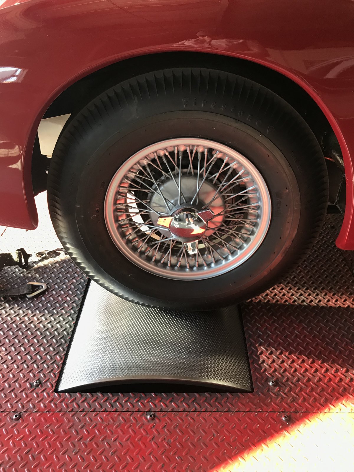

    One of course was getting the car ready for the engine installation. Last August we installed the engine and were getting it tuned up and it seemed to have a head gasket leak, coolant in the oil, with fewer than 10 minutes of running time at idle or slightly above. We pulled the engine and returned it to the engine shop to find out what went wrong. Turns out there was a pinhole in the bore and as the coolant warmed up it shot through the hole into the crankcase. One sleeve later we got the engine back whereupon I dropped it on my middle finger and broke it. Luckily the engine was unharmed.
    Just today I trailered the car to Superior Automotive in Placentia to get it dyno tuned. The car would start and idle OK, but upon acceleration it would pop and bang and want to quit. With the air/fuel probe attached to the dyno, we could see that it wasn't too small of an accelerator pump shot as I was thinking. Once the stock Caddy vacuum advance was disconnected and the port in the manifold plugged, it ran great and just needed a little fine tuning of the linkage and idle mixtures. Air/fuel ratio was between 11-13 once everything was adjusted.
    Now time for the power run. Part way into the first run it was clear that I had a detonation problem on 92 octane unleaded. Luckily I had a few gallons of 100/130 Avgas in my trailer which solved that problem. I had very high expectations for this engine but was thwarted once again. My skinny Coker/Firestone 6.70X15 tires just couldn't hold traction on the dyno drum! Max power to the wheels was 134 HP and 176 Ft-Lbs at about 4,100 RPM, or about 160 HP estimated at the flywheel. That was only at about 3/4 throttle though and the HP had been increasing at a constant slope from 2,300 RPM. Torque was level at about 170 Ft-Lbs from 3,500 RPM up to 4,100 RPM where I had to abort.
    Still a few more bugs to work out on the car, but the engine and quad-Weber log manifold setup work great.
