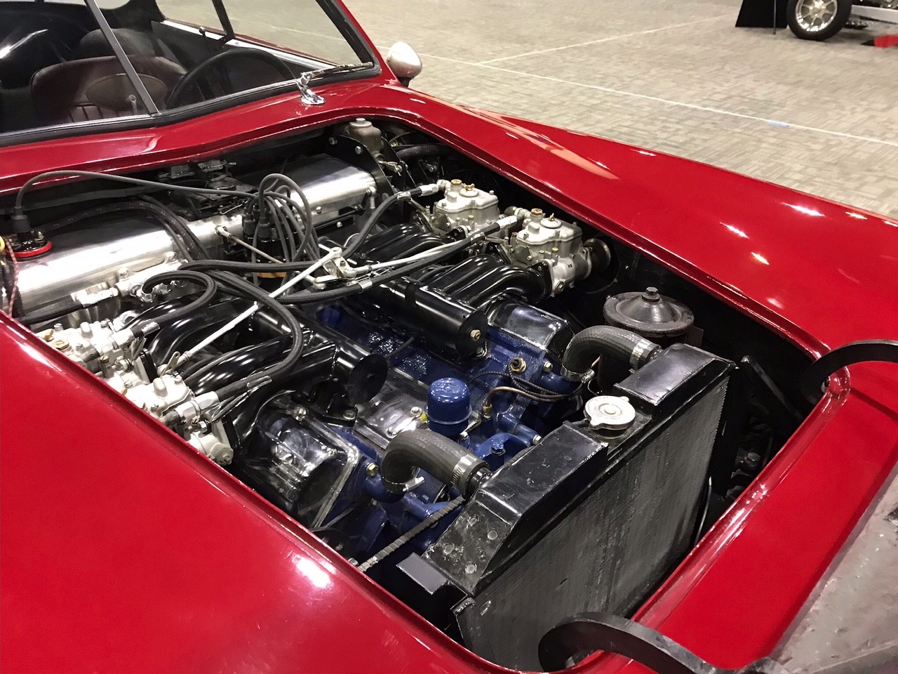

    I'm not sure where my custom dual log intake with 4 dual throat Webers fits into this intake manifold selection criteria but that is the real variable. The rotating ***embly should be good to at least 6500 RPM so that doesn't present a limitation.

    (4) 45 DCOE Webers on custom log manifold

    Here is my car pretty much done! Just a few small bugs to work out but it seems to run and drive OK now.
