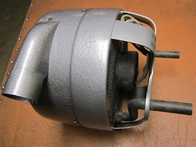

    Gotta have a heater now that im in the northeast....I've been looking for one for a couple of years for my 49 Dodge....I think my wait paid off..30s Goodyear heater...looks great , heater core p***ed pressure test and 6 volt motor runs quiet.....Flash Gordon look out.... image.jpg

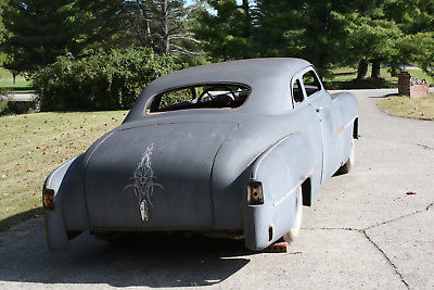

    Well , interesting things happen in life..selling my 50 Dodge coupe to a fellow in Tennessee who is picking up my 51 Chrysler coupe in Tennessee , delivering it upstate NY , and taking the 50 back to Tennessee.... image.jpeg image.jpeg

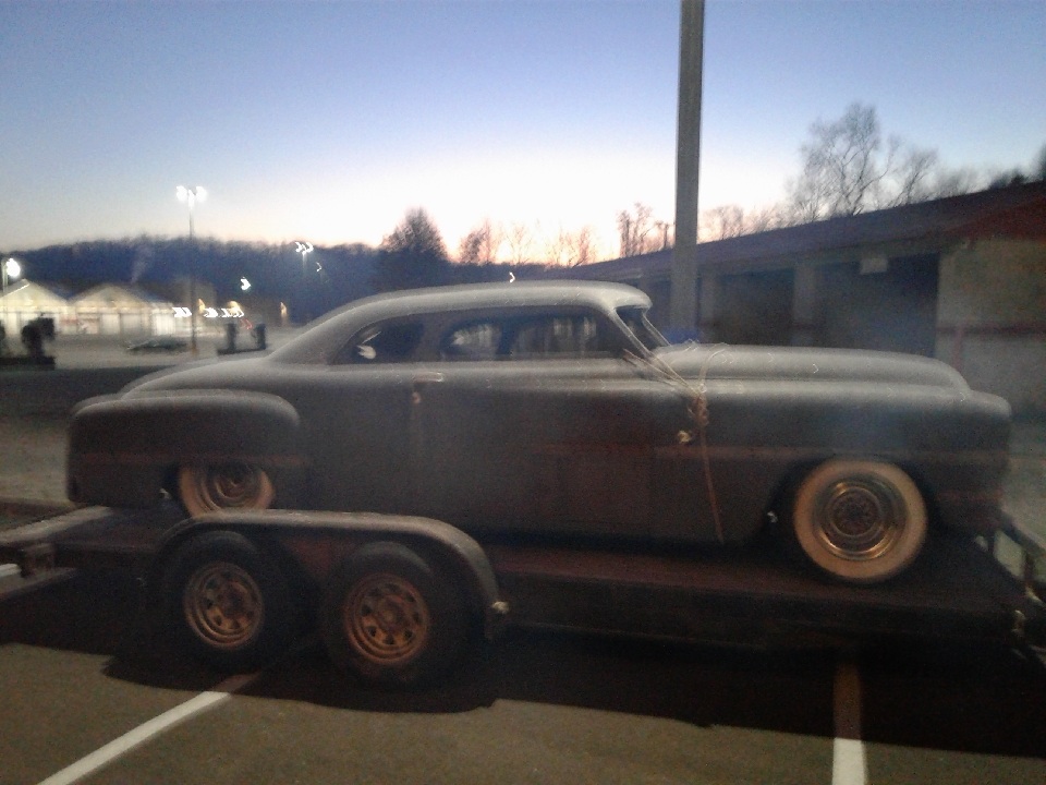

    Arriving Today...pic in Virginia... image.jpg shipping bud says its really a nice clean coupe....

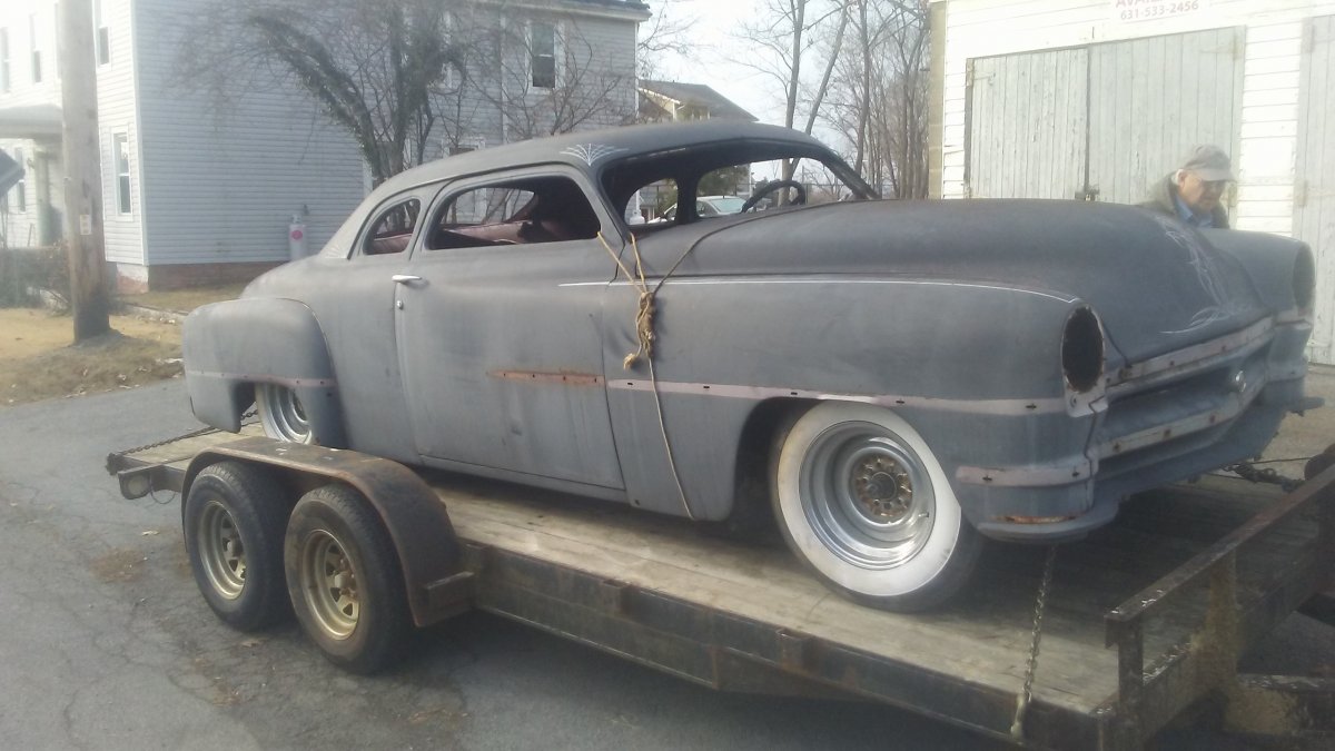

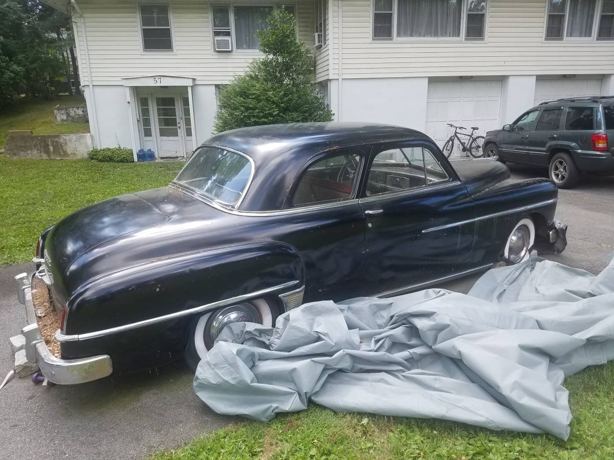

    man they lowered this car old school..5 inch bloccks out back , spring plate relocated up front , cut coils...must of drove like a f ing tank...all to be remedied....chop is dead on....insured it today also... image.jpg

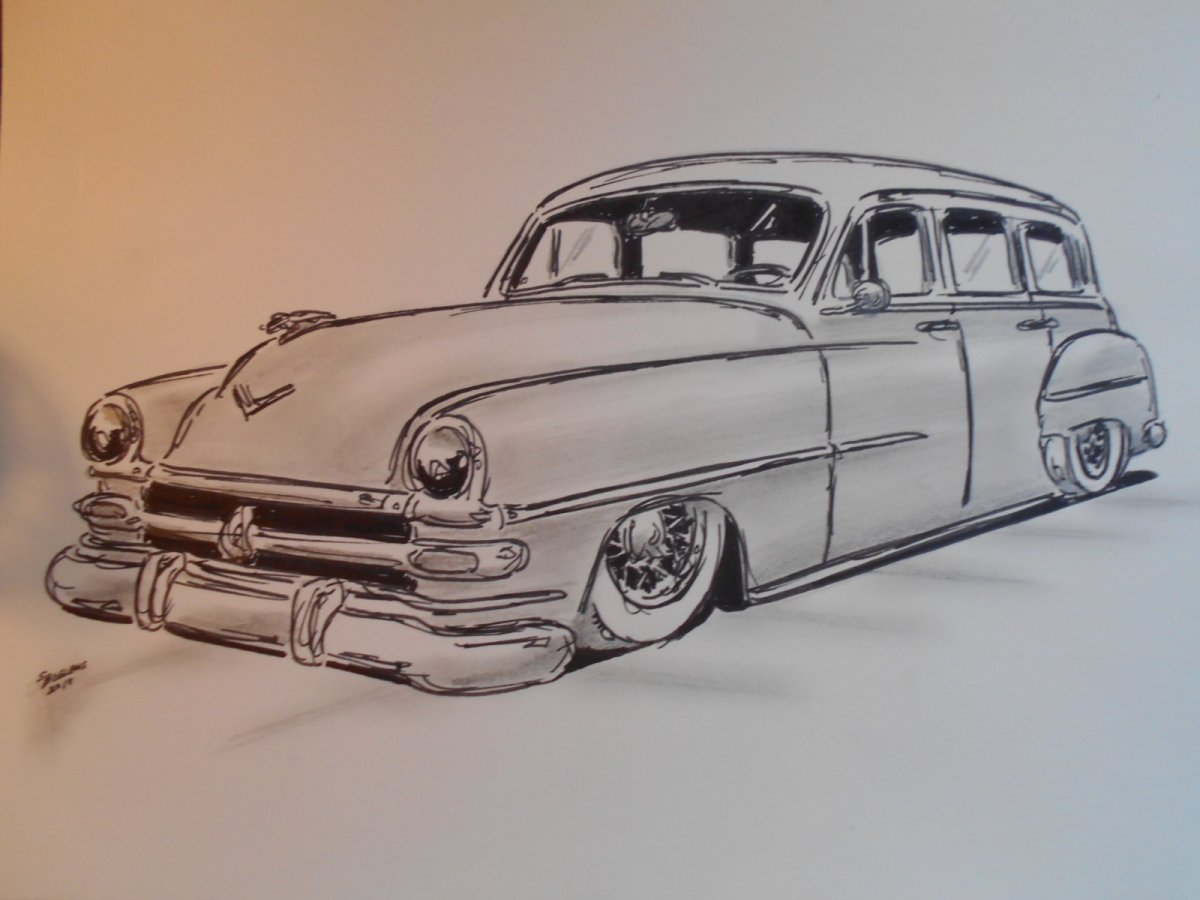

    Yes , I agree..just want to redesign the headlight bezels..a bit here and there.looking at a Mark Forged 3D printer...As soon as we settle into our new shop...nice drawing by the way..did you do it...

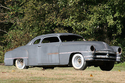

    Not sure how much it's chopped, my guess is 6 inches...the quarter window was shortened , the main roof section was never cut across, it was moved forward , A pillars slanted inward , outward..I like the he way this chop is done..saves time and a lot of welding..sail panels look ro be hand formed, wheel I guess...that back window looks to be 47-48 Fleetline...may change it out for a more symmetrical one from a late 40 Mopar sedan..... image.jpeg
    yup, I sketched that out for a fellow HAMBer awhile back...

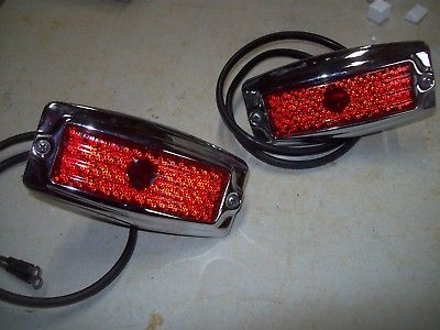

    Hey JLW , the tail light lowering is definitely a me likey...got a NOS set of Kaiser 47-48 tail lights... image.jpeg wanting to mount these...
