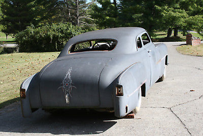

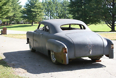

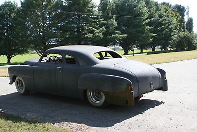

    Thanx Gatz , same thing here, just I can't get as far as you did...I guess that's why if you look at the pics I posted you can see it the deep dish rims front and back...sure looks like a younger crowd car now...glad to have the opportunity to build it....

    Going to bring a tape measure to the storage and I'm gonna get the track width measurements...the more I ponder the build , the more I think a ch***is , firewall , floor or partial floor swap would be the best direction....Time , money , a factory engineered platform , drivability , and a single parts source ....

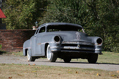

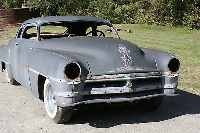

    Yeah, what a great canvas to start with!!! I've got 2 cents, so I'll throw it in;
    The chop looks good! Really brings the style out and pulls the proportions to where they should be. As unique as that car is, a mild treatment would result in a stunning final car. A partial de-chrome to remove redundant and gaudy barbs is a simple and tasteful method to clean up the looks of nearly every car built in this era. I really like the original grille on that model. It looks custom from the factory! Also, that year Imperial bumpers are amazing looking, (if you can even find a set) as are the Imperial tail lights... mounted lower on the fender, like just above the bumper.
    I.M.O., louvers go in the wrong direction on a cl***y lookin' rig like yours. (Think Bartalucci, Zocci & D'Augustino) Less is more. I'm looking forward to seeing where this beauty is going...

    Yes , a mild dechroming , Spinner hubcaps , and I'd keep recopy the pinstriping that's on the car now...guess the louvers aren't correct for this build..it's ok...ill punch em on the hood on my 49 3 window...Happy New Year to all...
