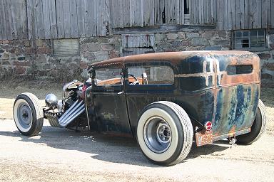

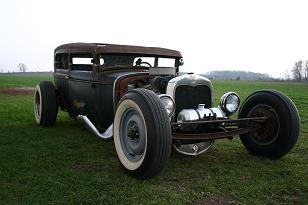

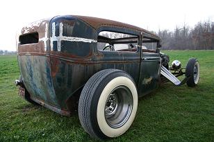

    Thought I'd show my 1930 A I built last fall. Not finished but driveable.
    chopped 6"
    channeled 8"
    '31 frame, rear Z'd
    9" Ford rear/ladder bars
    suicide front, split wishbone
    302/T5
    Let's hear your opinions good or bad!

    Killer man. You gotta bring that to my charity carshow in May. how far are you from Ottawa?

    Thanks, future plans include drivin the hell out of it, fixin what breaks, then take it apart to paint it.

    Tough looking sedan.

    Very cool. And he's got a Ford in a Ford! The way it should be.

    Hey, that's got the look! Have you got any close-up pics of the front suspension or the T5 tranny in the chassis?

    Hey Southfork, thanks for the compliments. Here's some pics for ya. 138s.JPG

    welcome, the sedan sits nice. Not sure about the spring attached to the frame horns though, but I ain't no engineer.

    Thanks for the additional pics, RageRodder. My buddy is doing a Model A coupe with a 302 and a C4 tranny. I am thinking about doing an "A" Coupe with a 302 and a T5, so can use the ideas. What did your 5 speed come out of? Was it easy to get it adapted to the 302?

    hey Southfork, the tranny install was easy, it's all mustang 5.0L parts. Just mix and match parts from 1980-1995 GT Mustangs to get what you need. There's two different flywheels though, pre '81 (28oz) after '81 (50oz) externally balanced. Good luck!
