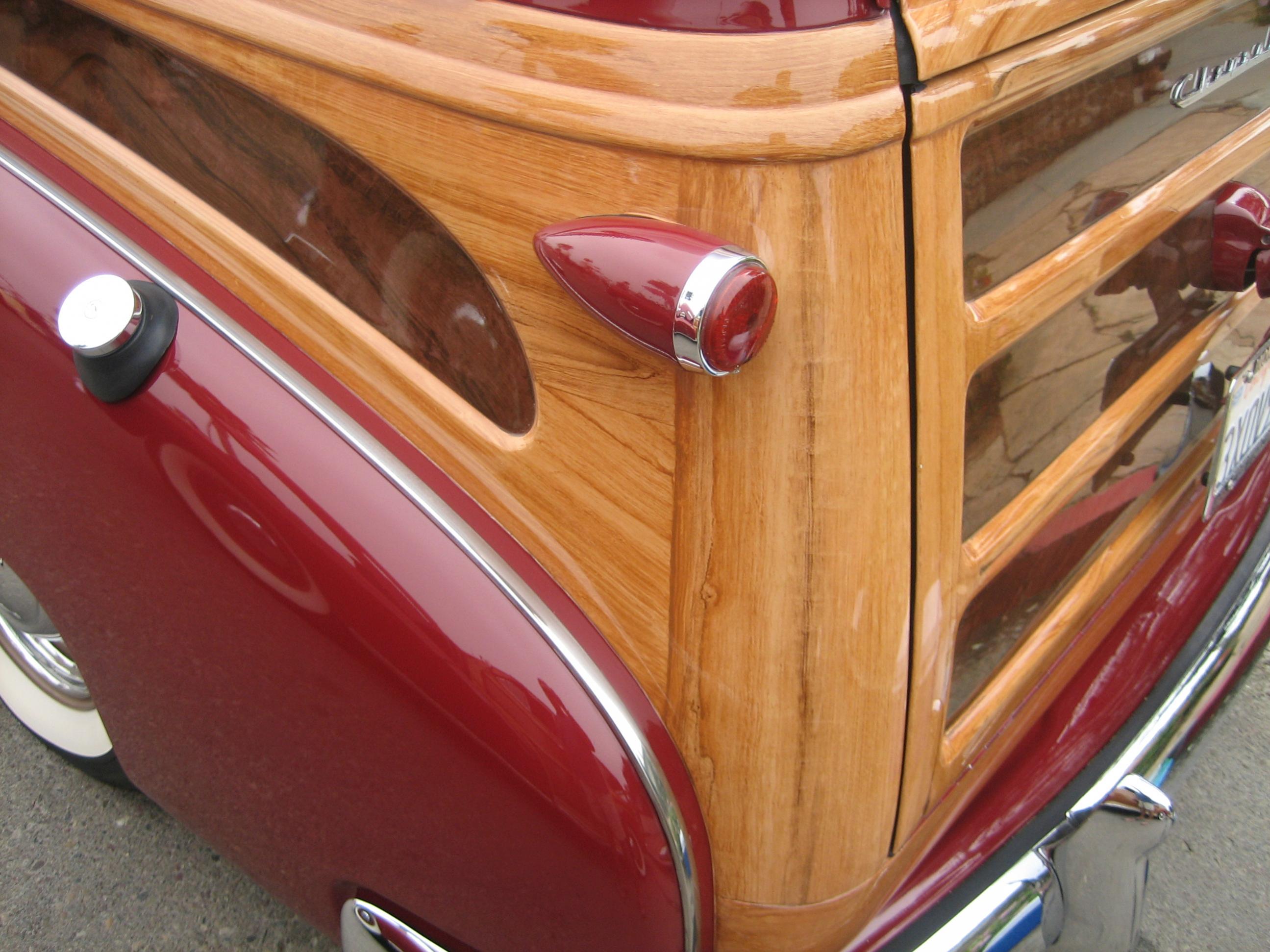

    I understand you not wanting to spill the beans on the details of your technique. Would you be willing to tell us the tools you use and material? Lacquers? Enamel? Training tool, brushes only? Airbrush? I was recently told the old-timers used India ink, but yours doesn't look black in the photos. Thanks for the post, awesome job!

    it used to be done with a roller. there are kits avalible.thats the way it this looks with maybe some hand work layered over it. the roller is kind of soft like a printing roller so it can ride contours. paint a base color first, then roll the grain patterns over it. clear coat it.

    www.Grainittechnologies.com sells the plates, rollers and paint in their kits. You get to choose the types of wood that you wood like to reproduce. Easier than it looks - this is really is an art.

    There is'nt any woodgraining kits , masks , or computer aided tricks here , just my friend Lyle and I doing the graining on a '51 tin woodie the old fashioned way using time , talent and experience.

    there is no debate that doing this by hand takes major talent. however, the advantage of the "kits", rollers, platens,etc., have over the hand method is repeatablity,and can also mimic specific species of woods. that's a biggie.if your doing a large area, the repeatabilty can be a give away as the platen is only so big, so your going to see the same grain repeat itself. but on small parts, window trim, dash boards, it can look super good with practice. this is of course my opinion, and as people i know tell me, i do not know what i'm talking about.
