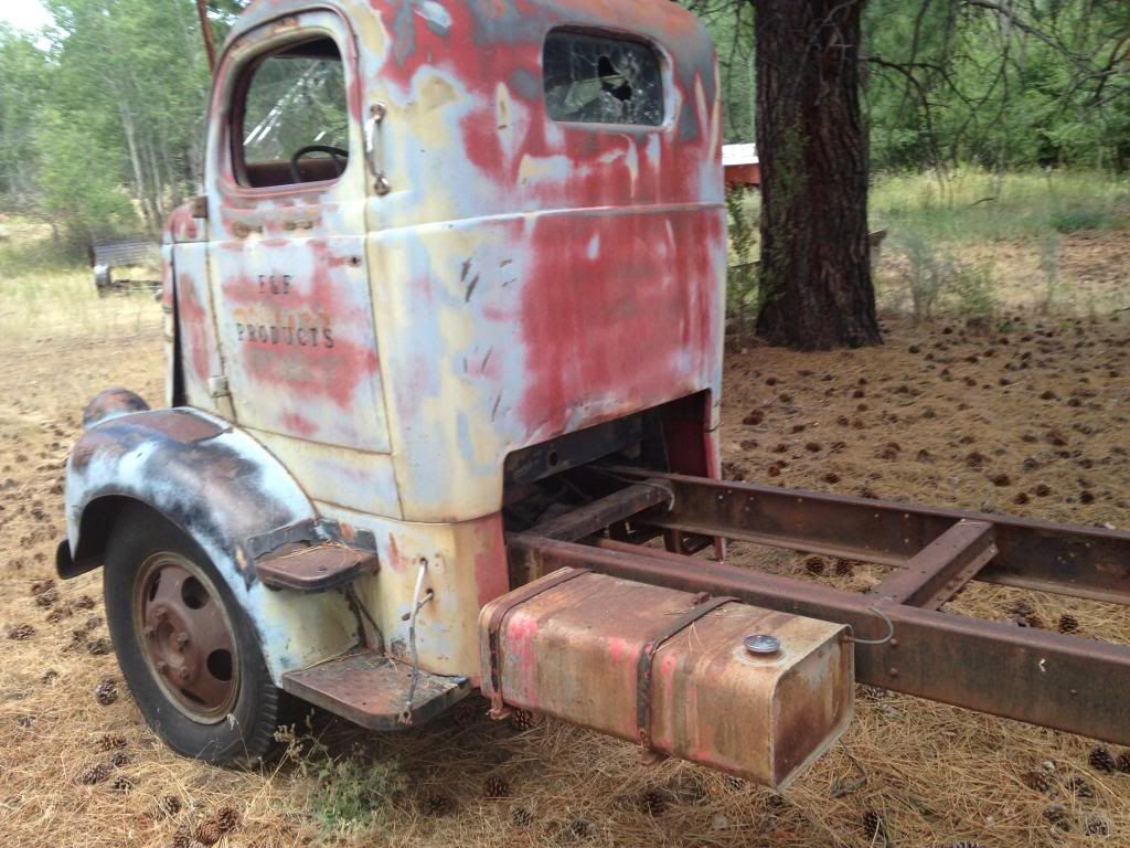

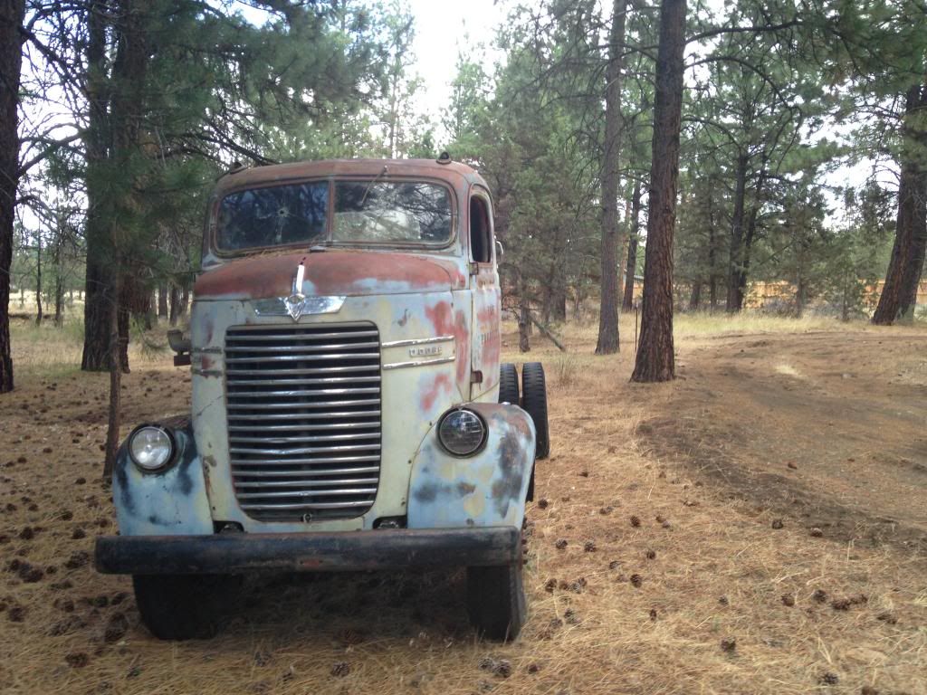

COE New to me 1941 Dodge COE
Discussion in 'Off Topic Hot Rods & Customs' started by hotrob32, Aug 10, 2013.

    Looks like a nice body to start with. Keep us informed :D
