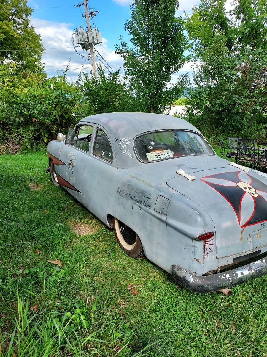

    I just picked up this 50 ford coupe. In process of searching but figured I'd get ahead of myself and ask
    Will the front vent windows come with chrome edging or will it go on new gl***?
    Turn signals?
    And here's the crazy one, seatbelts?
    I've got 100 more but imma look around a little

    Welcome to the forum! Looks like you have the makings for a nice ride.
    No, the new gl*** fits into the old chrome surround.
    What are you asking?
    Seatbelts were an option on some cars until 1968 when they became mandatory.
    You can get kits to retrofit them, Highly recommended

    There is no chrome trim on any coupe gl*** except for the aforementioned front vent windows and tilt-out rears of the Custom (with rear seat). The business coupe (shelf rather than a seat) rear windows are fixed with no trim.
