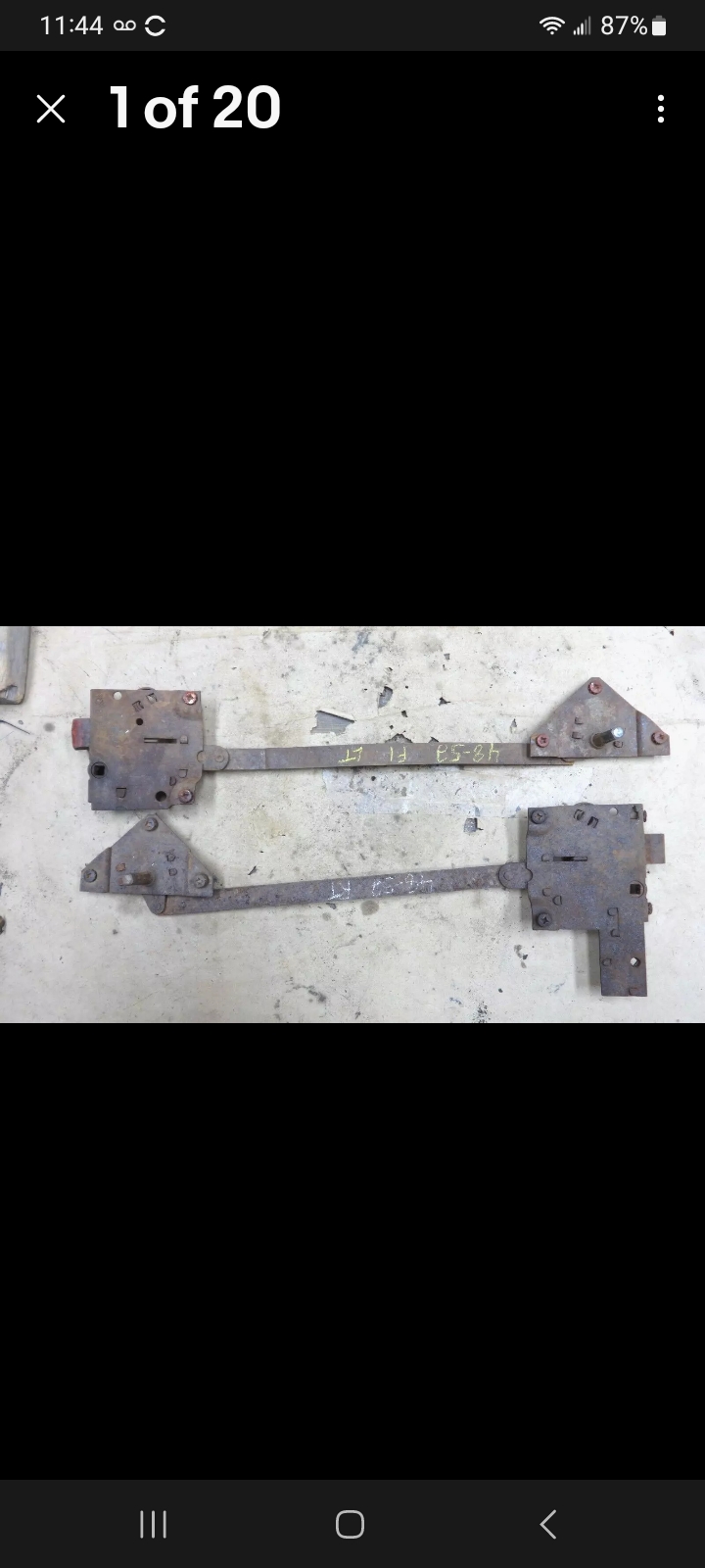

    Here's a picture of a truck mechanism. I wonder if they're the same Screenshot_20240825_114443_eBay.jpg

    The springs are inside the hinges, and in most cases, if one looks closely, the hinges will be cracked on the inside of the curved part on the bottom ....due to the forces of the springs holding up the trunk by the hinges. A little bit of welding with additional support will fix it, but on my '49 with '51 hinges, I just removed the springs (they will kill ya if you don't watch out). The trunk "hold up" mechanism is just a sliding rod on the driver's side that drops into a slot when the trunk is opened. This is all covered on my website.

    Those are different.
