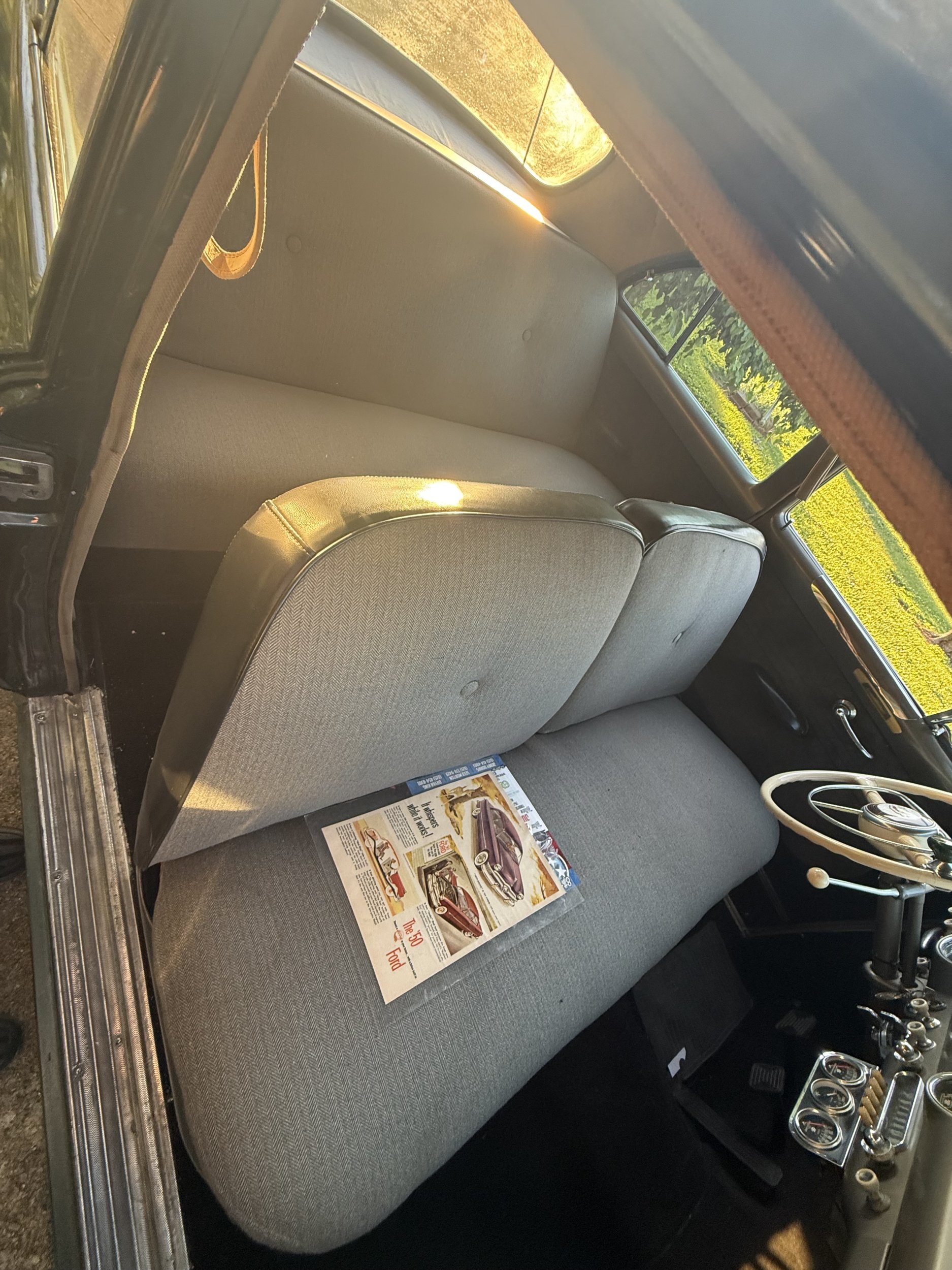

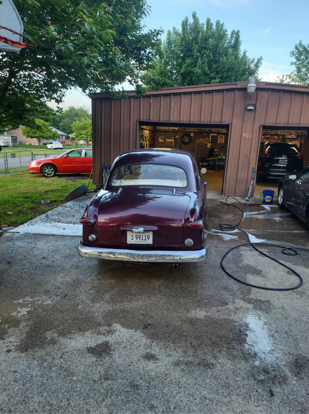

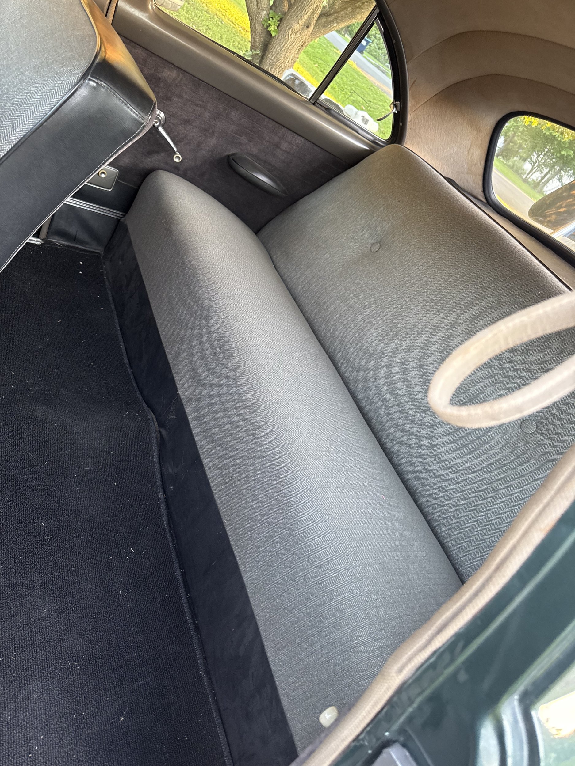

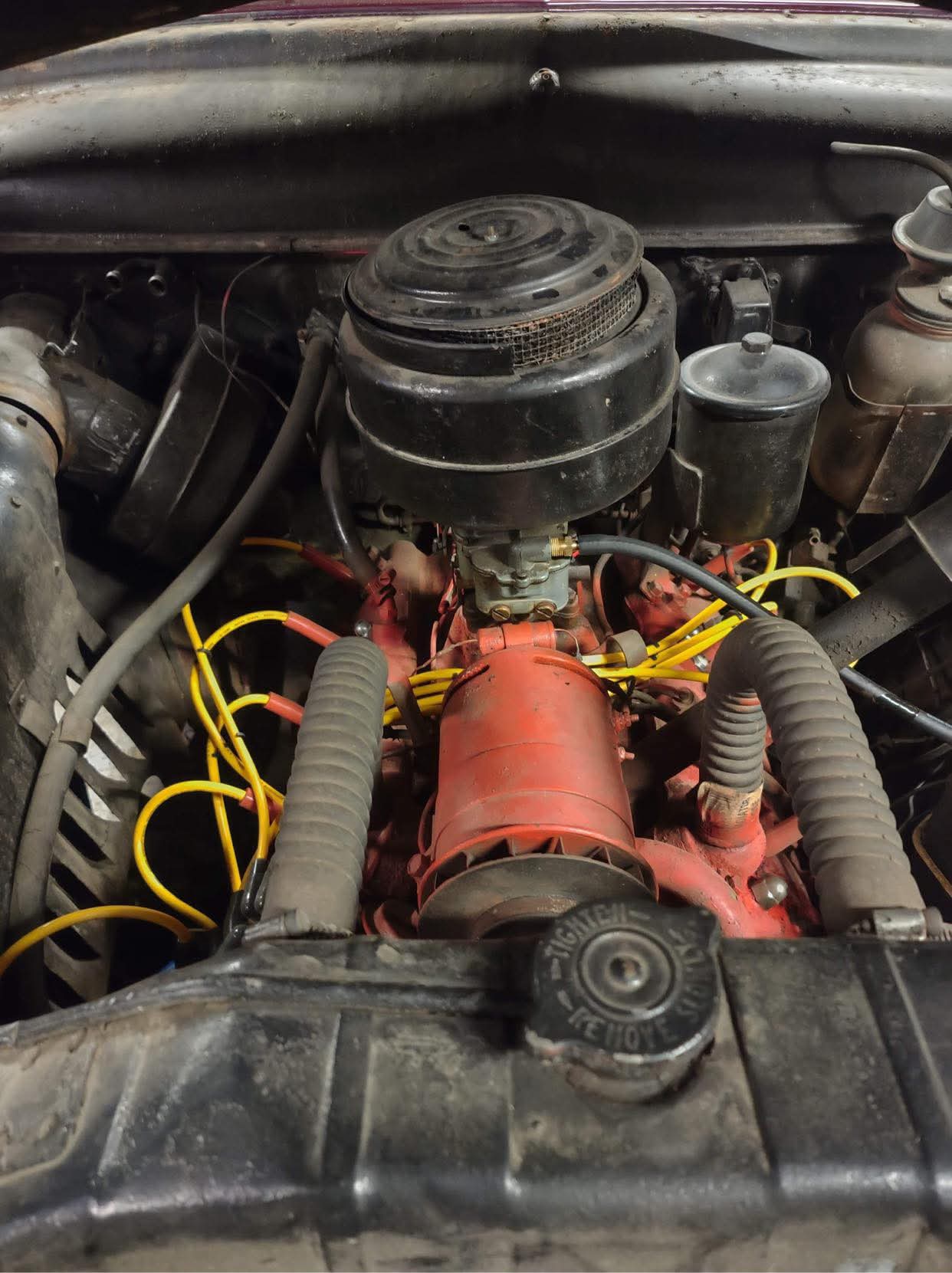

    Picked up another 50 Shoebox Balanced and blueprinted flathead V8 Have one question, it’s very quiet How do you get that flathead rumble sound? IMG_7355.jpeg IMG_7315.jpeg IMG_7314.jpeg IMG_7313.jpeg IMG_7311.jpeg IMG_7310.jpeg IMG_7309.jpeg IMG_7305.jpeg IMG_7304.jpeg

    Fantastic automobile you did good. In the old days we would slap some gl***pac Smittys on, you can find the same sounding mufflers today Enjoy the ride.

    Porter gl***pack dual mufflers with 1.75" exhaust. Flatheads don't like big pipes! That's a super nice car!

    Headers and straight pipes. 1 3/4" all the way back. Great looking car!

    Customer with stockish flathead just put 2"straight pipes all the way back and it sounds great!not overly loud, sounds perfect to me and I've got 12"gl***packs on mine and it's a little too quiet.

    I agree. Dual straight pipes all the way back

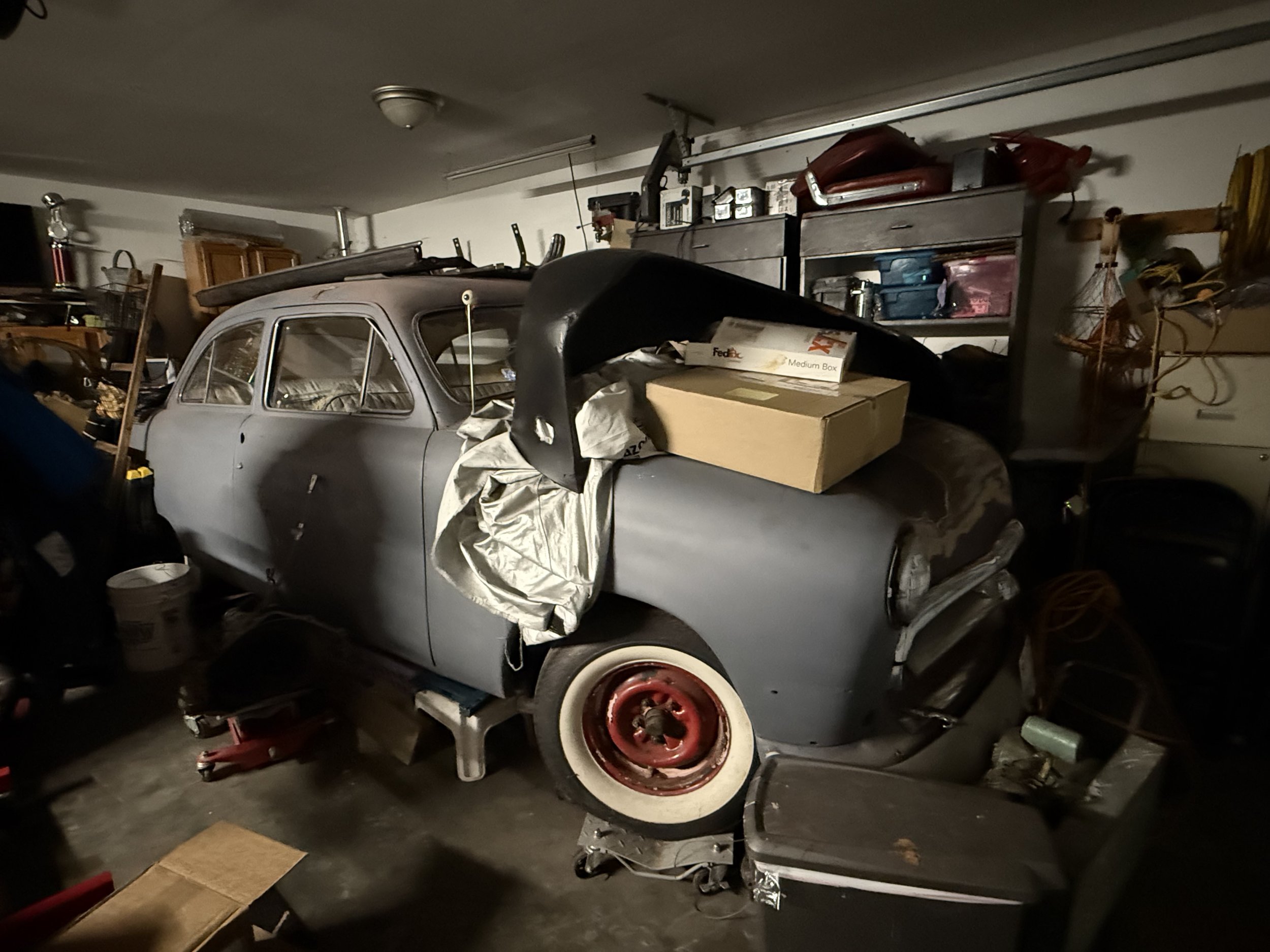

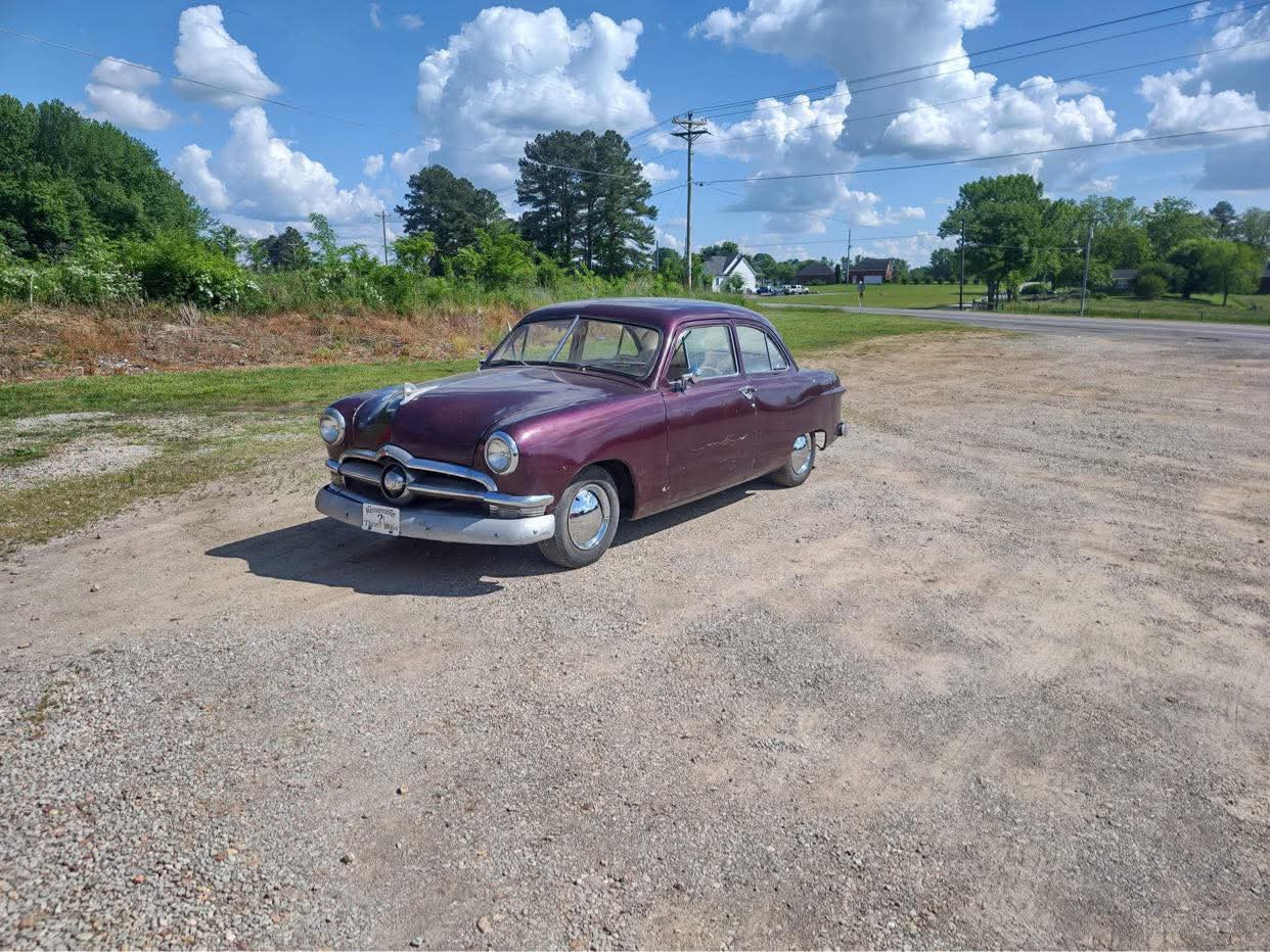

    My other 50. This one is going to be the guinea pig and the new one is going to remain well new lol

  15. Gl*** pack or steel pack straight thru mufflers. Cherry Bomb , Porter are good brands, get about 20 in. for medium sound 10 in for loud.

    Straight pipes or smittys. 1 3/4" pipes. Too big and they sound like a fat lady farting on a pier in the dense night fog.

    Duals and STRAIGHT PIPES (NO mufflers!) For goodness sake man, you live in Tenersee !!!.
    Home of the good-ole-boys..
    Seriously..it should be quiet enough for a normal conversation inside the car with the pipes going all the way to the back bumper. For a little more 'sound' let the pipes stop under the car just in front of the rear axle.

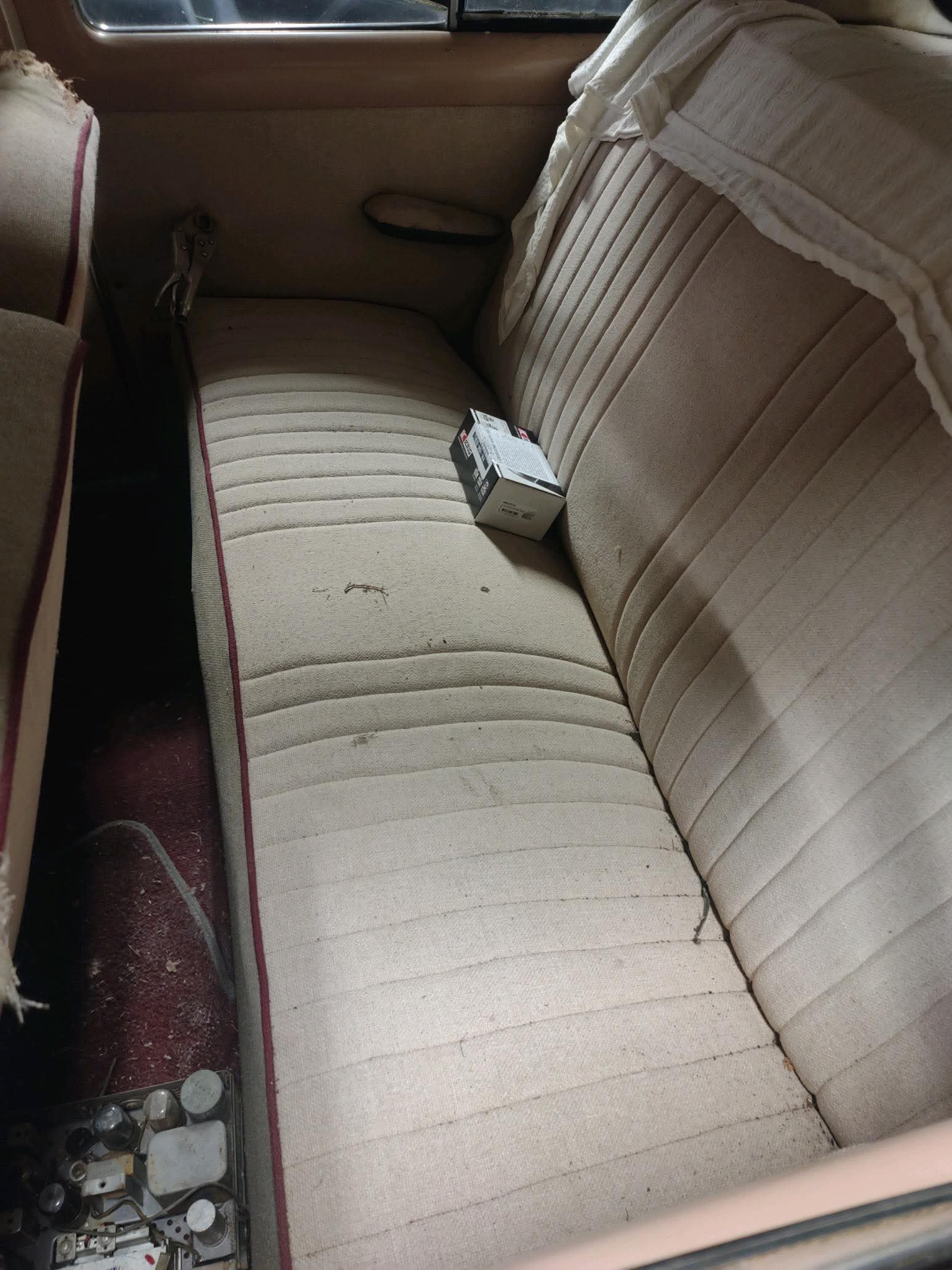

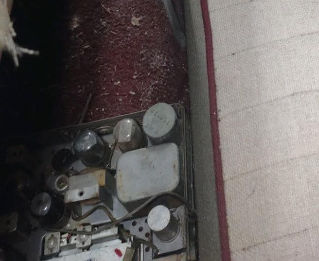

  21. Ebbsspeed
    Joined: Nov 11, 2005
    Posts: 6,491
    Ebbsspeed
    Traditional vacuum tube unit too. Nice.

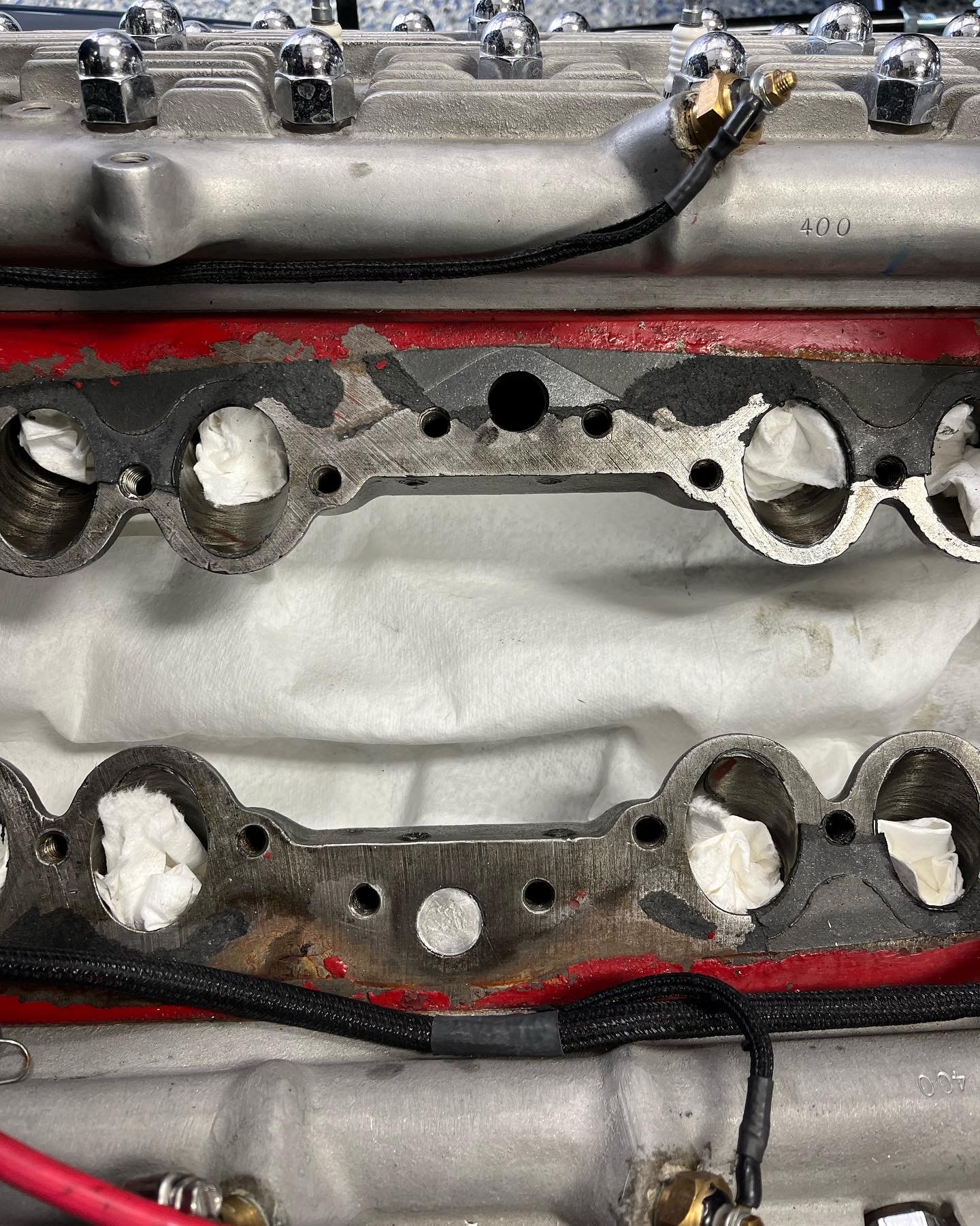

    Yep and a nice one in the new shoebox as well that won’t work with the 12v conversion I am told
    Sharpone likes this.
  26. djweaz
    Joined: Sep 17, 2012
    Posts: 413
    djweaz
    from Tennessee
    I just saw a video on YouTube saying dual exhaust and he said it might take me a minute because I have the crossovers blocked. That wouldn’t be you? Or is it a popular thing to do?

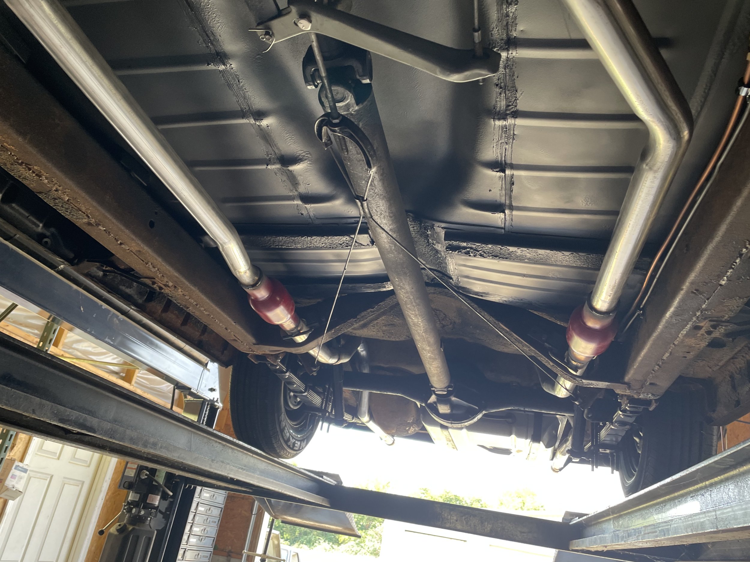

  27. ididntdoit1960
    Joined: Dec 13, 2011
    Posts: 1,430
    ididntdoit1960
    from Western MA
    It's probably worth what I'm selling it for lol - cut it a little more than I thought - this is it from the trans cross member back - it was a flathead with econo headers it obviously crossed under the trans then back over - car had 2" blocks and everything cleared - it did not use the "hole" in the rear cross member - they went alongside the kick up - don't know what the mufflers are, but it actually sounded pretty good
    Have a '65-'66 mustang 8" behind the shed too, makes a good swap
    Time for a s**** run!
    Sharpone and Paul B like this.
