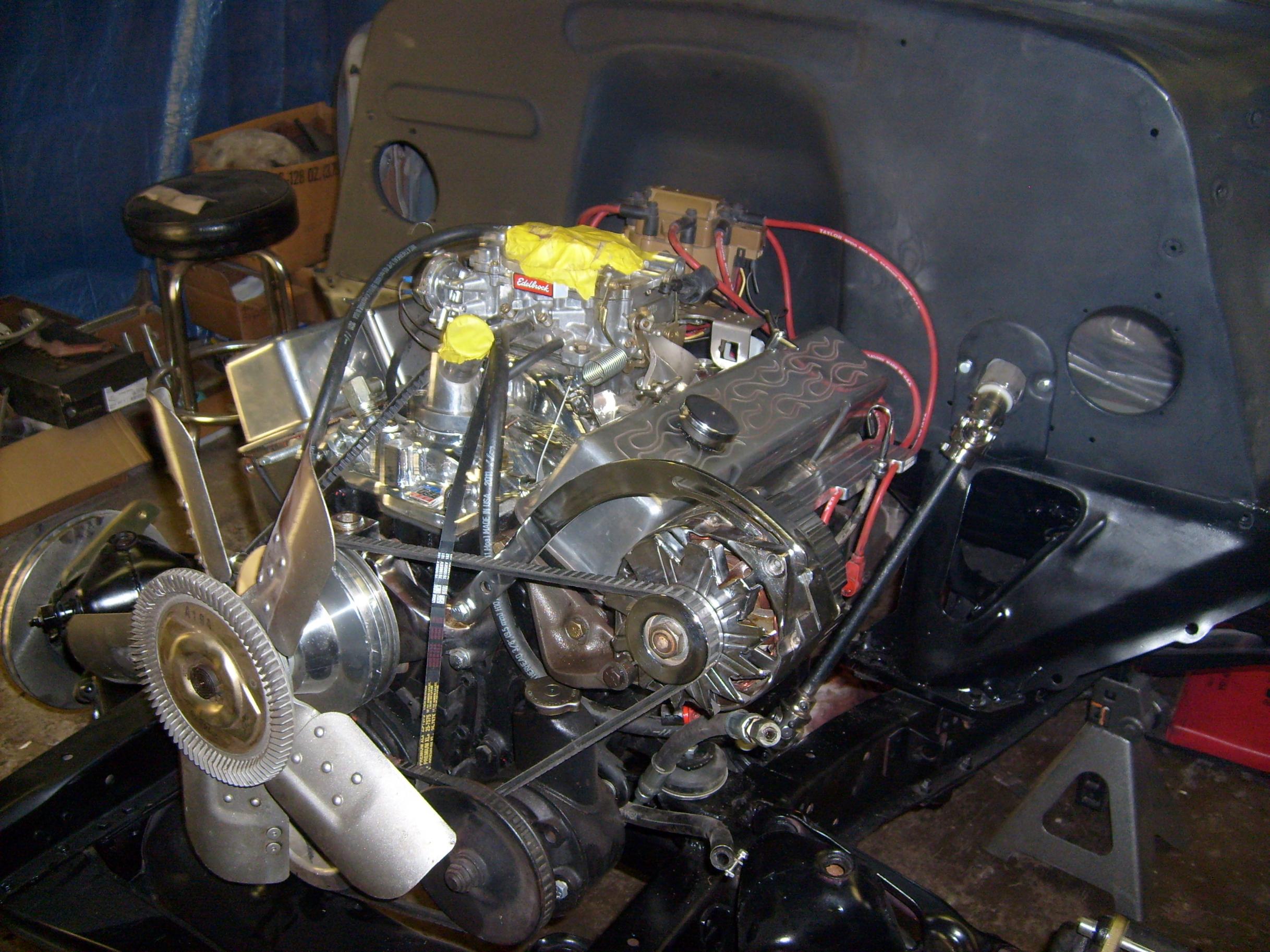

    Sanded and prepped the front end so I can put the new motor in soon.

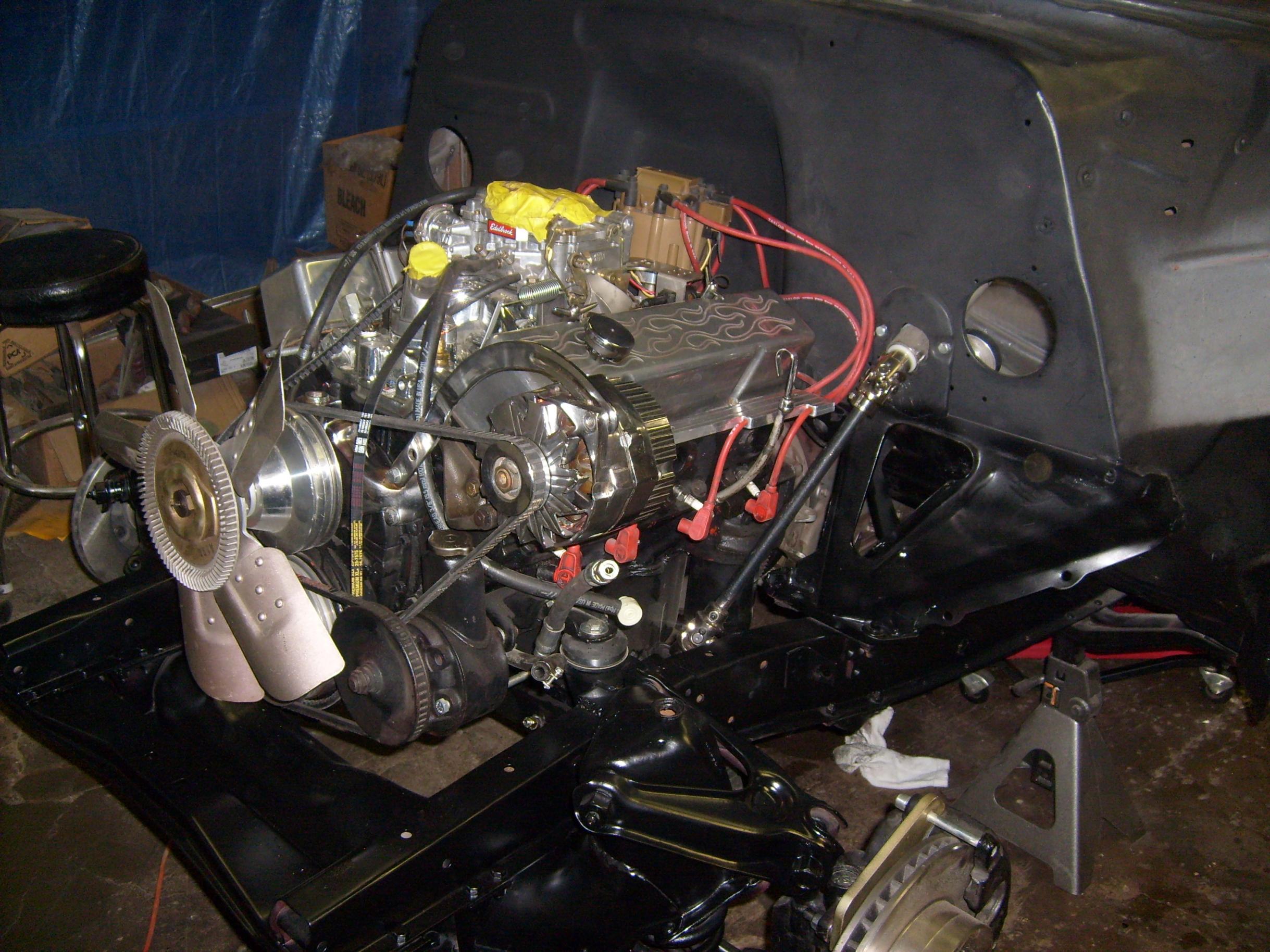

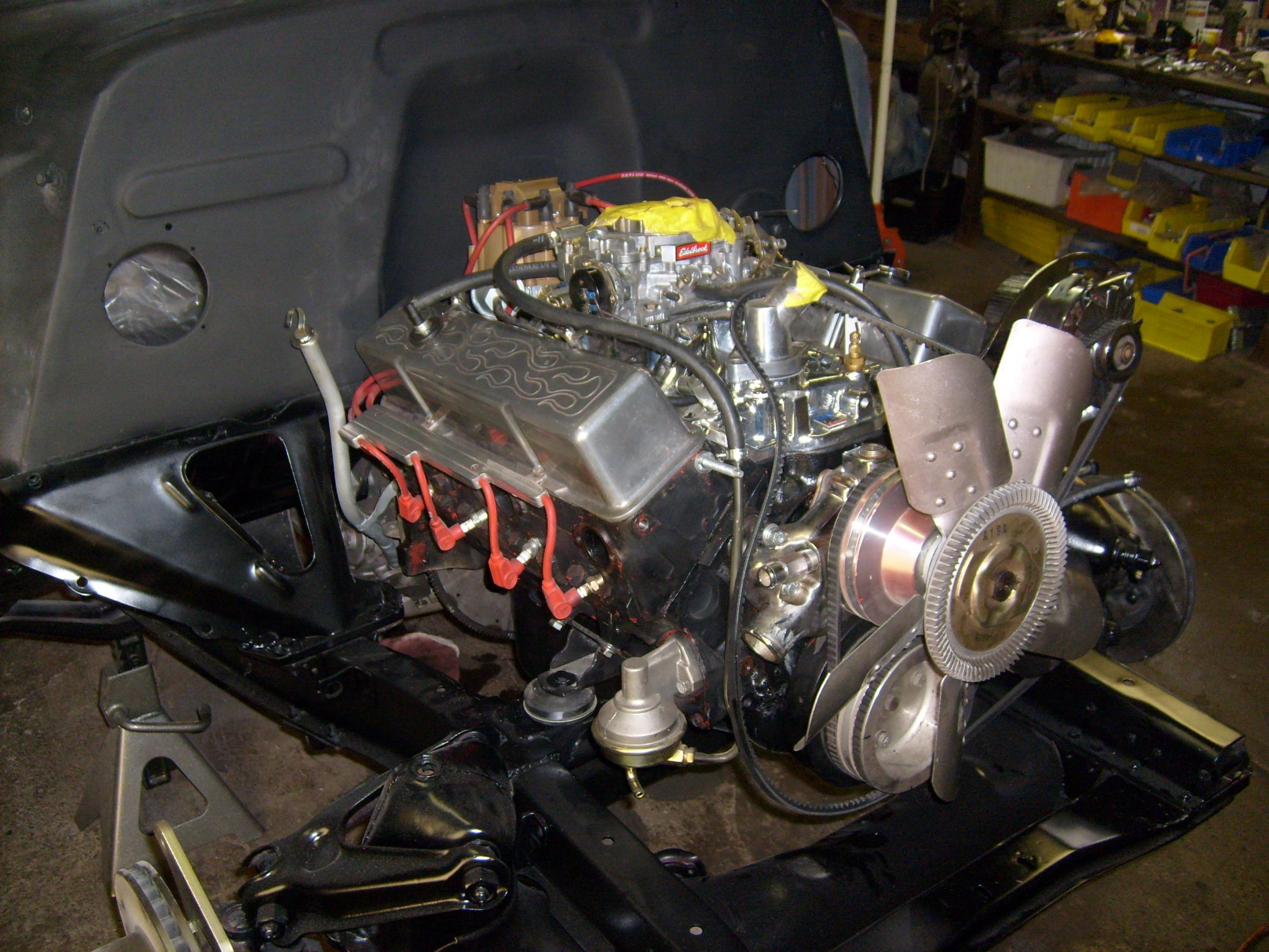

    Motor is in. Please disreguard the valve covers, the new finned ones haven't shown up yet:mad:

    Oh ya I finally got rid of those flamed valve covers, man I hated those!
    The new ones look so much better:rolleyes:

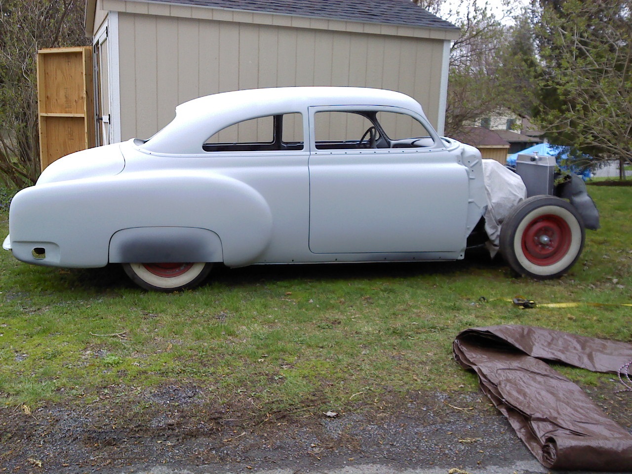

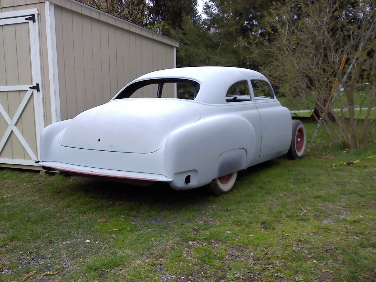

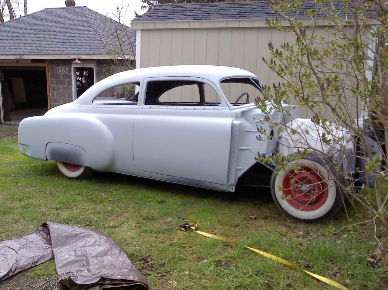

    I have been working on the body long hours of hand fileing. where the gray primer is it is just about ready for paint.
    The weather finally got nice enough to roll it outside and get a look at how it sets after all the sysp work done over the winter.
    I think I still need an inch or two in the rear. No bags here.

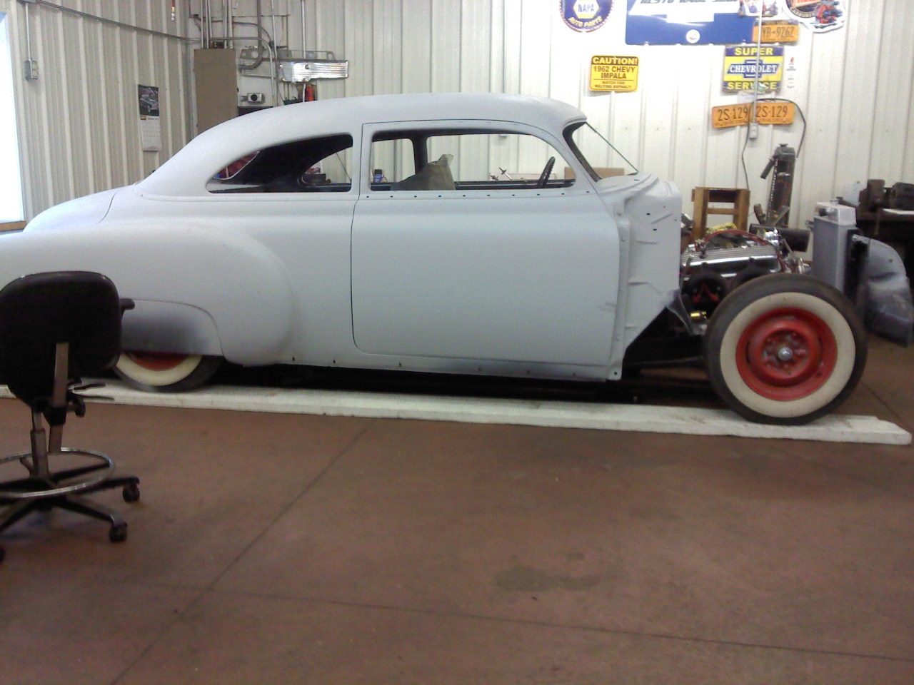

    So you guys that were watching this don't think I gave up I finally got a chance to move my 52 to a buddies shop. I haven't had it in my shop in months because of the other projects I am doing for other people (gotta pay the bills). Anyway, all new brakes on the rear,pwr steering lines made and in, wiring is started and all the plumbing should be done soon. Then on to finish the exhaust get the gl*** in and maybe go for a ride. The dam thing is so low we had to use 2x10s to get it on a mid-rise lift.

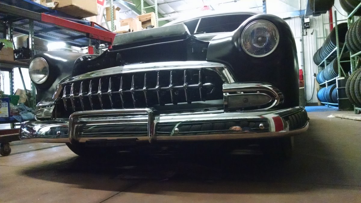

    The front is done and I have got a start on the inside also. front end 047.jpg
