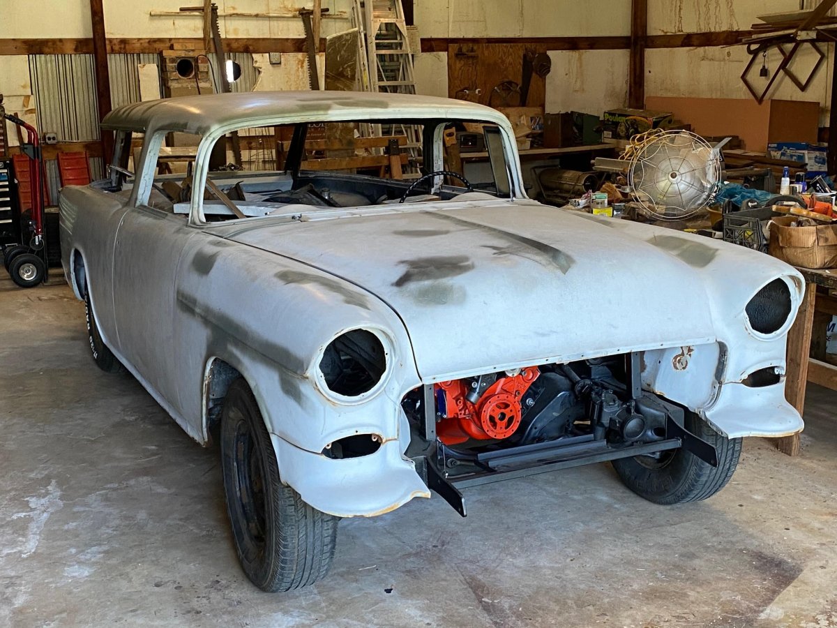

    I picked up a 55 Nomad project from and elderly friend of mine in CA who decided it best to let the project move on to someone else and enjoy the finished car he's had since Nam. Its got a great body, no rust, all metal work redone probably 15-20 years ago....*really* nicely done, never any rot. Got the whole shabang... chrome, seats, new Currie rear end, built 350 and trans....but.....BUT.....it's got a 79 Camaro/Firebird front clip grafted into it. Now, the owner *before* my friend is the one who did it or had it done, and a local SoCal shop inspected it and said it was done well. They moved the motor mounts, cut steel for new bumper brackets, radiator, etc etc......but the issue with the 79-81 front clips are that they sit higher (not an issue, can swap springs) and push the wheels out over 1.5" extra on each side....not so easy to fix. I found an old article on Hot Rod from 97 or so showing this *exact* swap on a sedan. They "solved" the issue by going with some Cragar 15x7's with 4.5" backspacing and drop springs. I'm fine doing this, I'm also fine using the Fatman Fab narrowed control arm sets to bring everything in by 1" on each side. HOWEVER.....I'm getting dueling arguments from some folks saying things like:
    -"Don't use the Fatman Fab arms, you mess up the geometry"
    -"No one will want to buy your car if you sell it because of the evil 79 front clip"
    -"Ditch the whole frame and buy a new one, start over."
    You get the picture. Does anyone here actually *have* experience with this swap on a Tri-5?

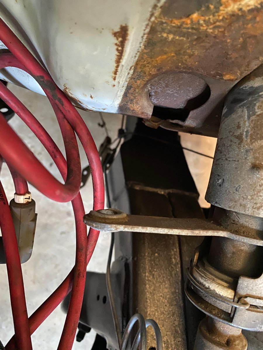

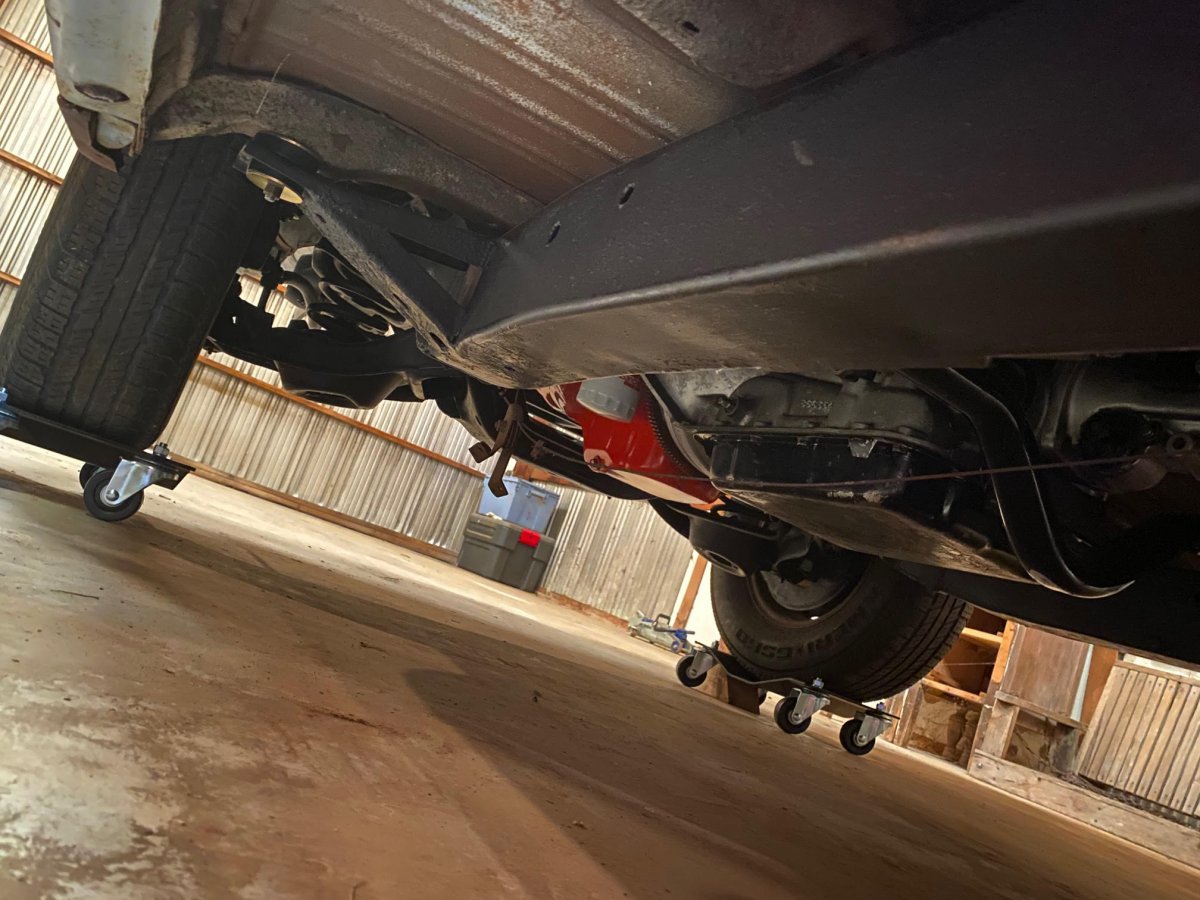

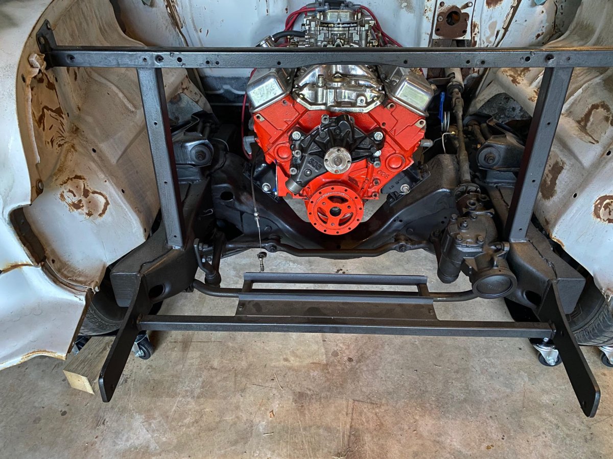

    It was done at least 20 years ago, from what I can tell, in order to get IFS up front...before the newfangled kits and such had been developed and were easily obtainable. In fact, here's the article I found from 1997 showing this exact swap on a Bel Air:
    https://www.hotrod.com/articles/43078-modern-subframe-installation-2/
    The frame and graft job was inspected by trusted shop in Burbank where I used to live. They gave it a passing grade and said it was done well...just a matter of whether or not I want to keep it.
