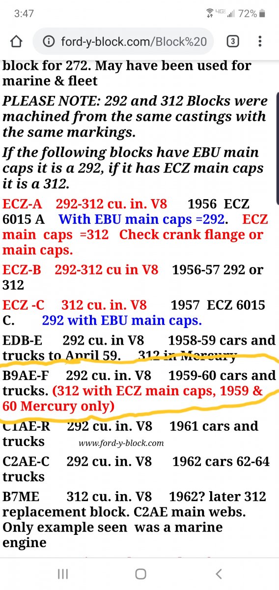

  3. DaBeers34
    Joined: Nov 25, 2019
    Posts: 64
    DaBeers34
    Think I finally got it. Man it was hard to get to. Had to blind video then get a screen shot.
  4. Wanderlust
    Joined: Oct 27, 2019
    Posts: 1,080
    Wanderlust
    Looks like you’re going to have to drop the pan to tell for sure, I was going to suggest that anyway, I always like to see what’s in the pan, water, rust, filings, if it got sludge thin it with gas, look for discoloured main or rod caps.

  8. Wanderlust
    Posts: 1,080
    Wanderlust
    I came across a B9AE F block with ecz b intake ecz c heads and ram horn manifolds, was positive I had a 312 but no,once the pan was off ebu caps, from what I’ve read 292 has a stronger bottom end anyway so I wouldn’t be too disappointed

  10. 56don
    Joined: Dec 11, 2005
    Posts: 10,332
    56don
    From one of the previous pictures, it looks like you already have an adaptor plate on the intake.
    I wouldn't worry too much about whether its a 292 or a 312, either one is a good engine, just get her running, you only need to know the displacement if you have to buy parts for it.
