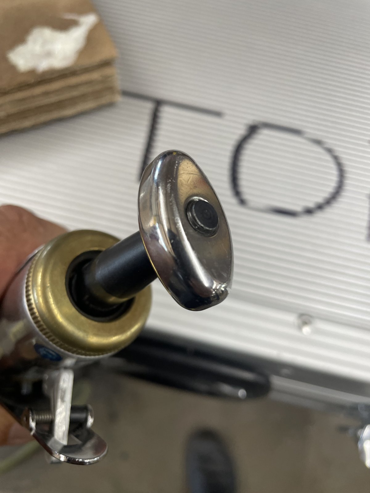

  1. Got a new tool at school. Got to play with it some today. It will move the **** out of sheet metal.
    it’s a “rotary hammer” for paint less dent repair but it will move a good bit of metal. Should be able to shape with it.

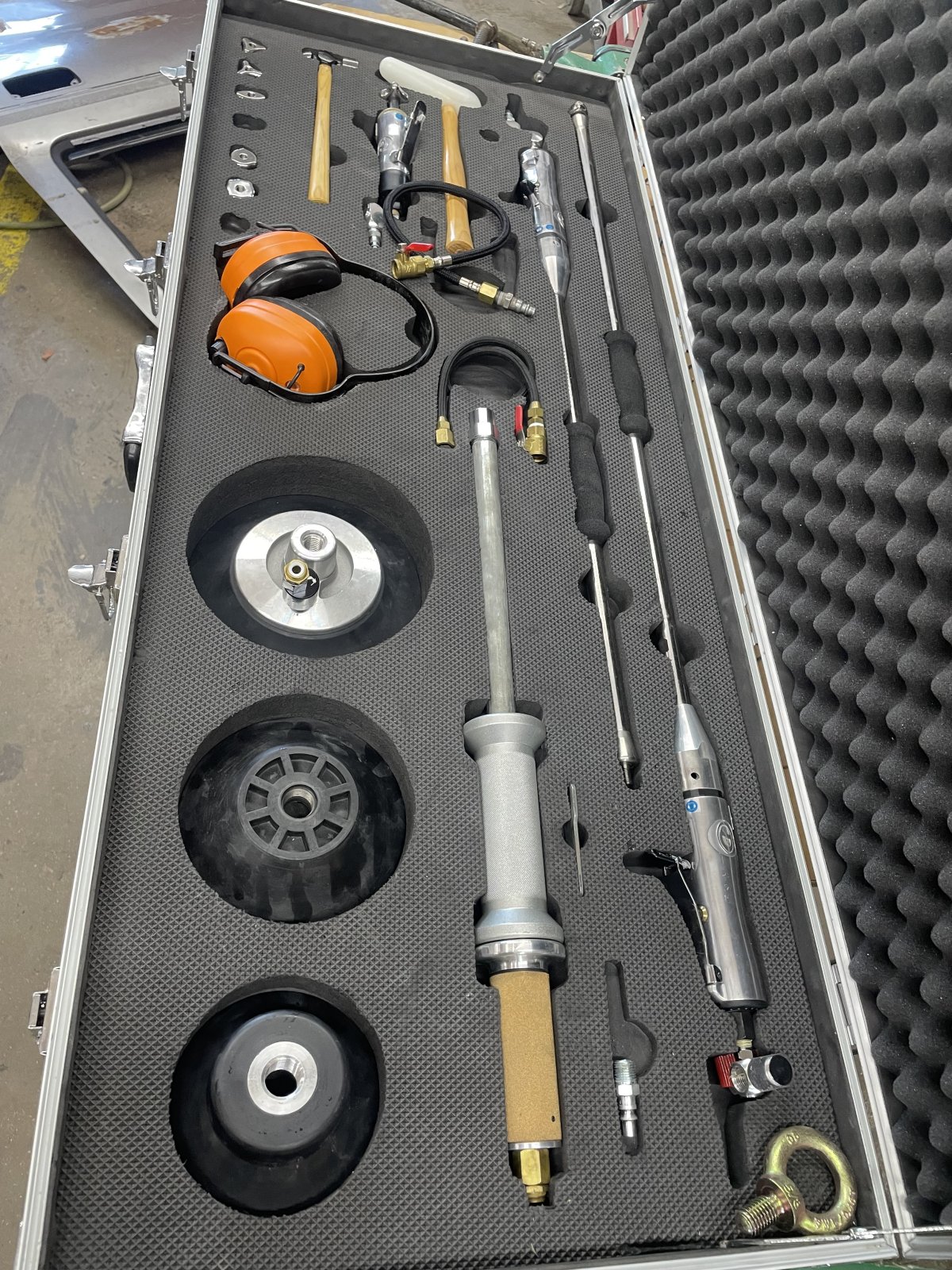

    Came with this kit with longer versions and a super strong suction cup set up.
    close up on the different ends for it.
    has a shaping mallet.
    Curious what could be done to shape a part with this. I guess part of the battle would be holding a panel.

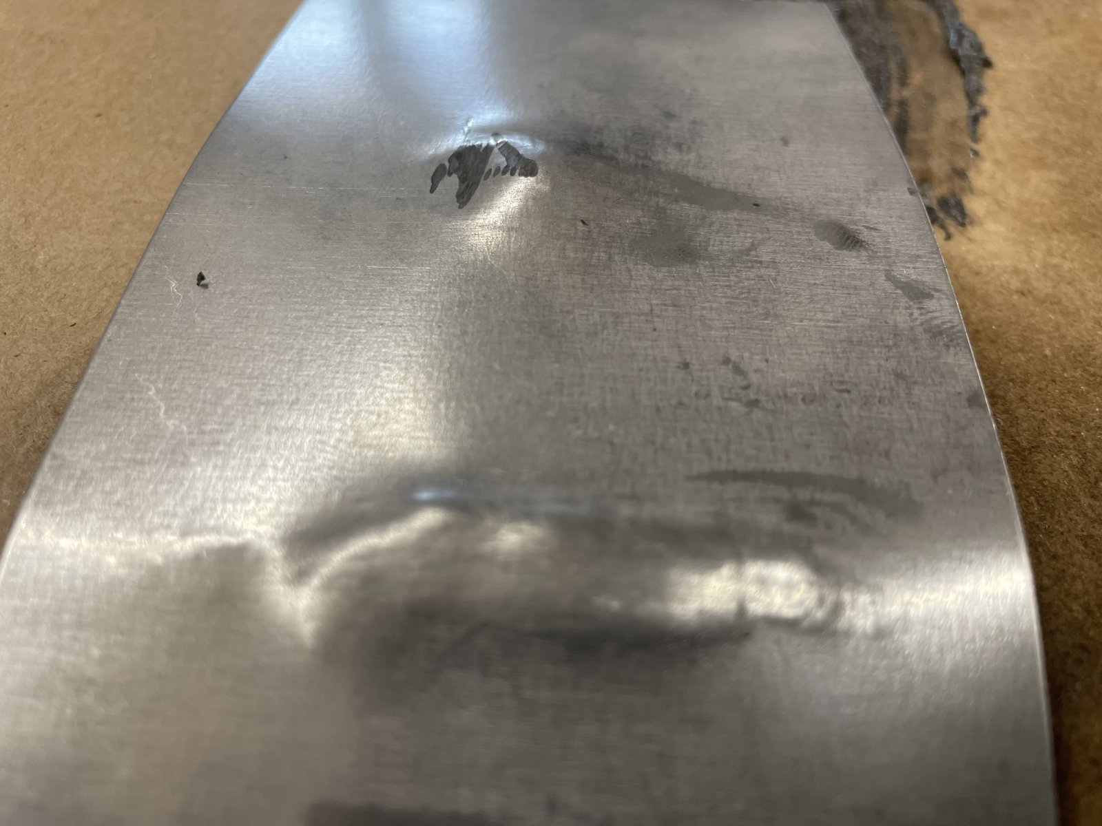

  3. Just got it.
    I’m curious what it can do.
    We used it on a small dent today in a s**** part and it moved a lot of metal. We over worked it in just seconds. Got my brain gears turning on what it could do shaping a part.

    Are we seeing that right? Is it like a die grinder with a funny shaped thingie on it? (That's a highly technical term, thingie...)
  5. Good description
    A rotary tool or fancy die grinder with a threaded end you can change the heads.
    You can lock the tool like a regular grinder to change em.

  8. I have these welding practice pieces. 20 gauge.
    Stretched this in seconds.
    With this
    what’s it good for?
    Hmmmmmmm

  14. I’d recommend gloves. Vibration type. But probably no worse on the hands than swinging a hammer. It does create heat.
    Those test spots got warm.

  18. Not sure what this kit that was donated cost. It came from another program that was shut down. :(
    But this is priced reasonable
    if it works
    Squablow and Truckdoctor Andy like this.

  28. Played with it on a dent today. It’s variable speed and you control the pressure.
    You can ruin or stretch a dent very fast.
