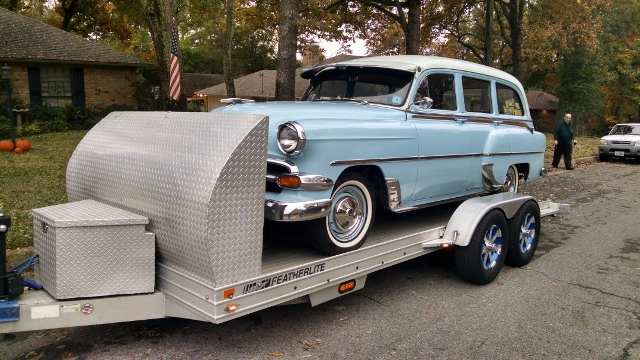

  20. Hello David, Sorry you had problems with the old girl! Hopefully it will turn out to be something simple! Got a bunch of "thumbs up" bringing it down to you. Thanks for the feedback in the 'O Dex

    Thanks Bill! I had people honking for holding up traffic, then would wave or give a thumbs up when they sped around. People only were mad til they saw the old girl- then liked her! Thanks again for binging her to Texas!! My uncle in the picture there had already told all his neighbors it was his new car! haha
