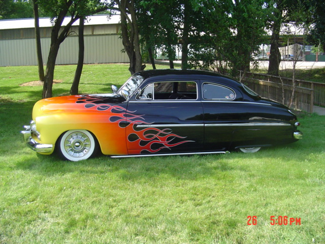

    That is one beautiful Chevy. By all means do not cut the coils. I have Jamco coils & leafs on my Merc that was lowered correctly more than 20 years ago after heating and cutting mine to try to save some money. Jamco has had some bad reviews since I've purchased my springs from them. You may want to do some research before purchasing from them. They do have good products though.
