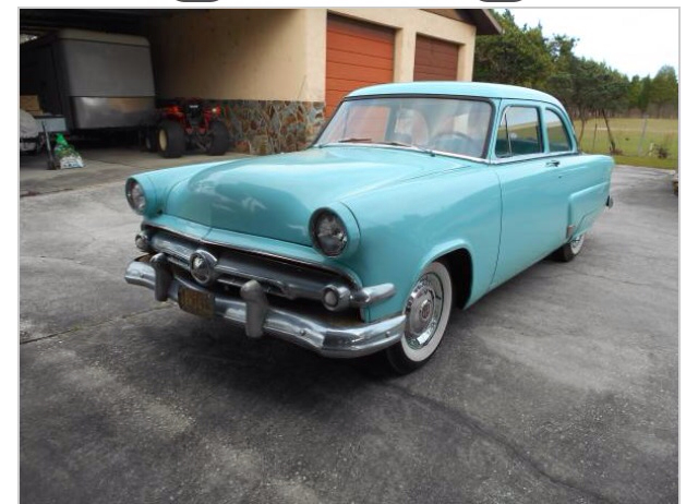

    Now if anyone can help me navigate through here or set me up with some links. My plans for the '54 customline are :
    12 v conv.
    A/c system.
    Power steering

    Anyhow into your 54.
    Vintage air will be your go to place for a/c. Others do it cheaper non do it better.
    Power steering. Totally not needed. Get the tire air pressure and your aligned dialed in and you won't think about it again. I loved my 53.
    12 volt.
    I can't recall the year ford went to 12 volt, maybe 56?
    Grab a 12 volt generator from one and stick it on your car with a same year voltage regulator. Change all your bulbs to there 12 volt counter part and put a voltage reducer to your gauge cluster in the dash and your rockin!
    Your horn will be loud and your car will start fast. Oh, and a 12 volt battery obviously.
    Your existing 6 volt wiring will line right up and is waaaay beefy enough for 12 volts givin that it's in good condition.
    You've got a great one there! Let me know if you have anymore questions and stop using the rat word if you want to keep hanging around here hassle free ;)

    ~you also have the option of keeping your 6 volt generator and having it rebuilt for 12 volts by a shop. It's generally a shop that rebuilds starters as well if your trying to find a shop.
    Also look up how to polarize your generator when you re instal it. The rebuild shop should be able to fill you in on that as well if you go that route. You basically arc a wire and it makes it spin in the correct direction

    It looks like you already got some great advice. Definitely go with Vintage Air for AC.

    http://www.y-blocksforever.com/ is a good site for all things for you 54. Lots of helpful people with a wealth of knowlege. One thing about the generator conversion, might not keep up if you ad air, sounds and other comforts. Vintage air is one of the few that has a a/c-alternator bracket for the y-block.
