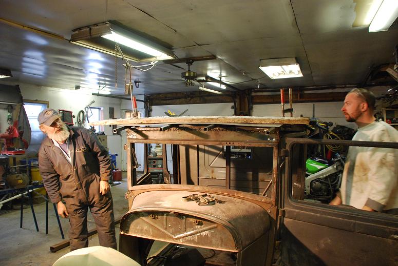

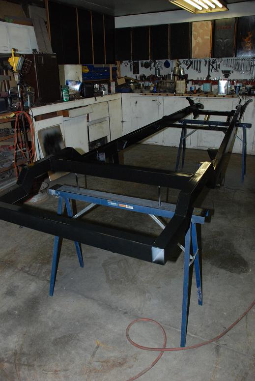

    Hey guys I found a couple build photos that might help. When we extended the cab we actually cut the protruding section behind the door out and flipped it around so it was recessed, it only made sense to mimic the recess for the window. Any way we used a piece of channel my dad had for the belt line on the extended cab as well rather that try to copy and weld in a small patch. In the frame shot, the tank is in the very back behind the rear end. It fits pretty tightly in this area. There is a pic of Old Wayne and Young Wayne contemplating our next move haha. The last pic you can see the bottom of the tank. We made it out of 14 gauge steel with 2 baffles in it.
