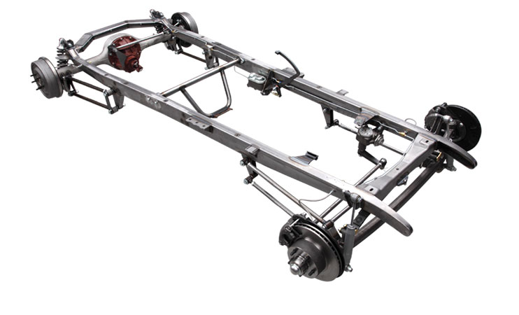

    Some mount them in front of the axle, some behind. If behind, move the steering through full travel first to make sure there's clearance.[​IMG]
