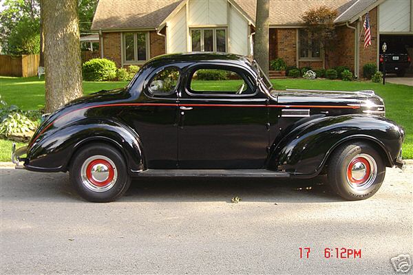

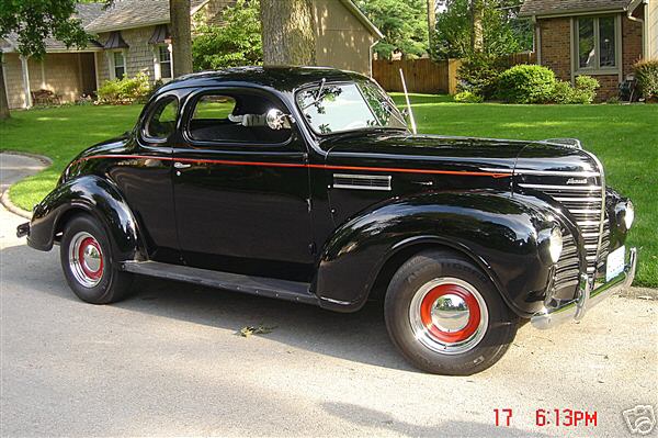

    Hi, my name is Brett and I live south Florida. I just purchased a 1939 Plymouth P7 coupe off eBay and have so far found this forum to be very helpful. My Plymouth is a bone stock, 201 ci flathead, 6 volts, 3-speed on the floor. The car drives better than I thought it would but I am looking to make a few changes to make in more drivable. I am not that knowledgeable about cars but I get help from my father, who is (his daily driver is a 57 Chevy pickup). Some of the changes I would like to make are to add an A/C (hot down here), turn signals, seat belts and front disc breaks. I was thinking I might replace my stock engine with a 230 ci and add some hop-up parts. However, after driving it a while the power is actually acceptable but what I don’t like is not having an overdrive and with it being geared so low it tops out to quickly. I’m doing OK on getting the parts mentioned above but I am struggling trying to find info on either an over-drive I can add or different transmission, like a 4 speed, that would be a simple swap without too much modification. I would like to be able to do 65-70 on the highway so if you have any advice on what type of transmission or O.D. that would work well and where I could get one I would appreciate it. I’m sure I will have many more questions and problems in the future so I am very happy to be here.
