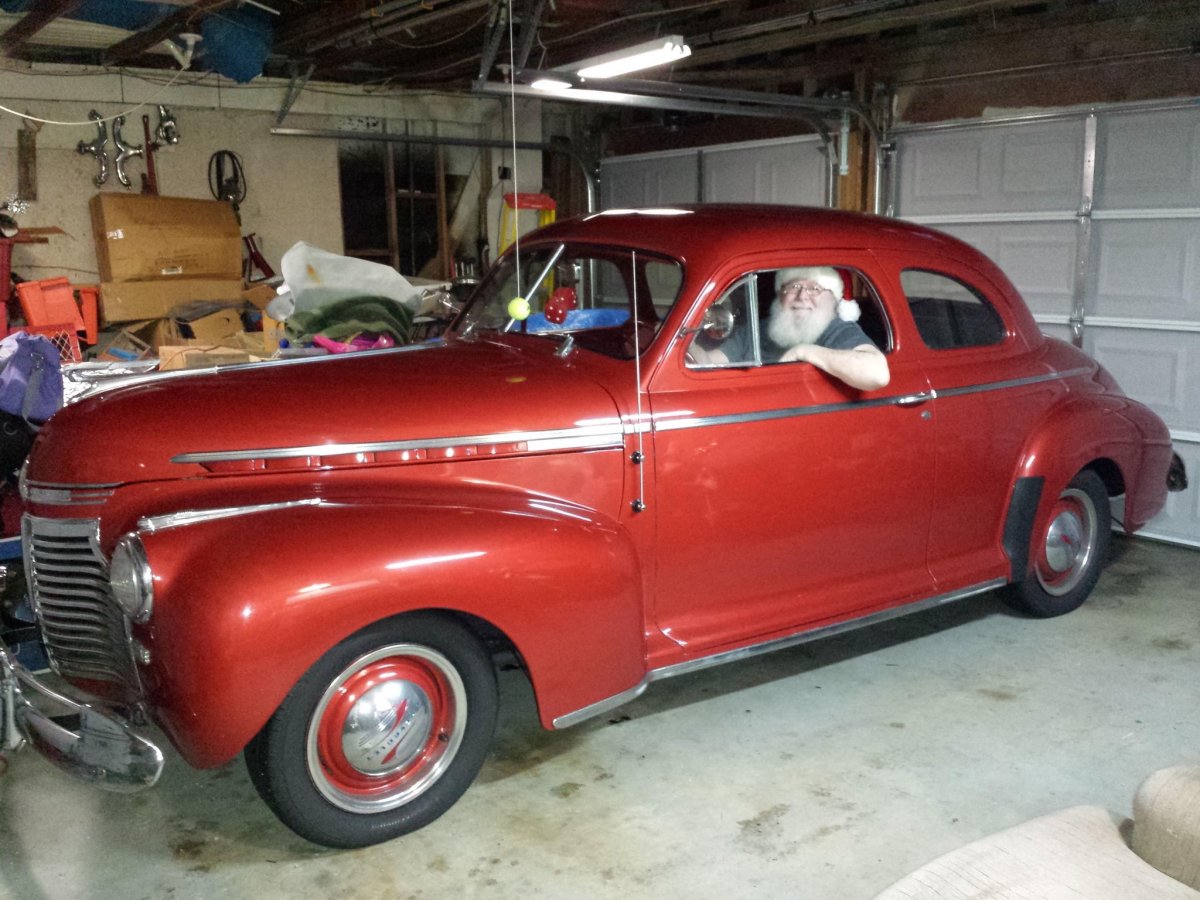

    RC41
    Yep, learned that a long time ago and it gas served me well, for the most part. Thanks for the compliment, and I am having fun with it.
    Here's me doing my Santa impression! This was taken the first day I owned it. By the end of the second day, it had the windows tinted for a better look, in my opinion.

    Chrome ram horns hanging on the wall in your garage? Nice!
    And a damn fine looking automobile.

    RC41
    Thanks!
    Good eye, I've been hauling those things around the country for over 30 years. I was sorta hoping they would find there way into the 41.
    We'll see!

    Hey RC, ya make a fine Santa! :)
    RC41 likes this.

    Ho Ho ho!
