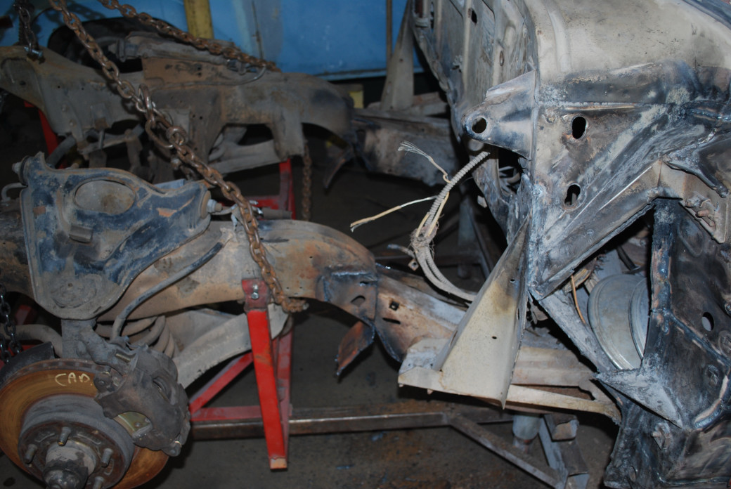

    OK, I won't hurt you;) You did say "never" in your first post and I took offense to it. Back in the 80's/90's my shop specialized in suspension swaps, we did dozens of Camaro/ Nova clips and never had a problem. I agree you got to know what your doing, we repaired/ replaced a lot of clips done elswhere that were installed bad, some dangerous. I had (still gathering dust in my shop) a special frame table just for these clips, made sure everything was staight, the alignment was good and the ride hight was set right. Not the best pic but you can see the table / jig. I'd say the ones we did were 100% right.
