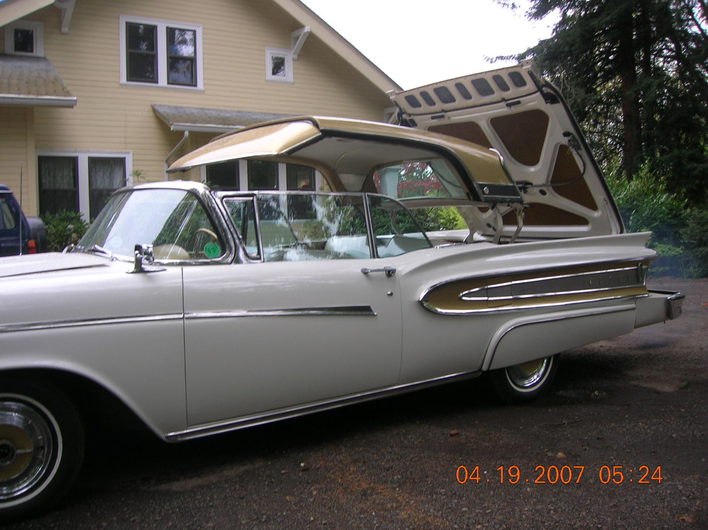

    Here is another Edsel retractable that was created as a "what if" car. It was built in the 1980's by a gentleman named Galen Weber. It is very much like your car - front clip, dash, quarter panels, rear end and tail lights were all taken from a donor Edsel and incorporated onto a Ford Retractable body. Yes, the fins remain on my car, too. The craftsmanship is excellent, and the car remains in outstanding condition both cosmetically and mechanically. I've owned the car for about 10 years.
    Feel free to contact me if this car can help you with any aspect of your build.
