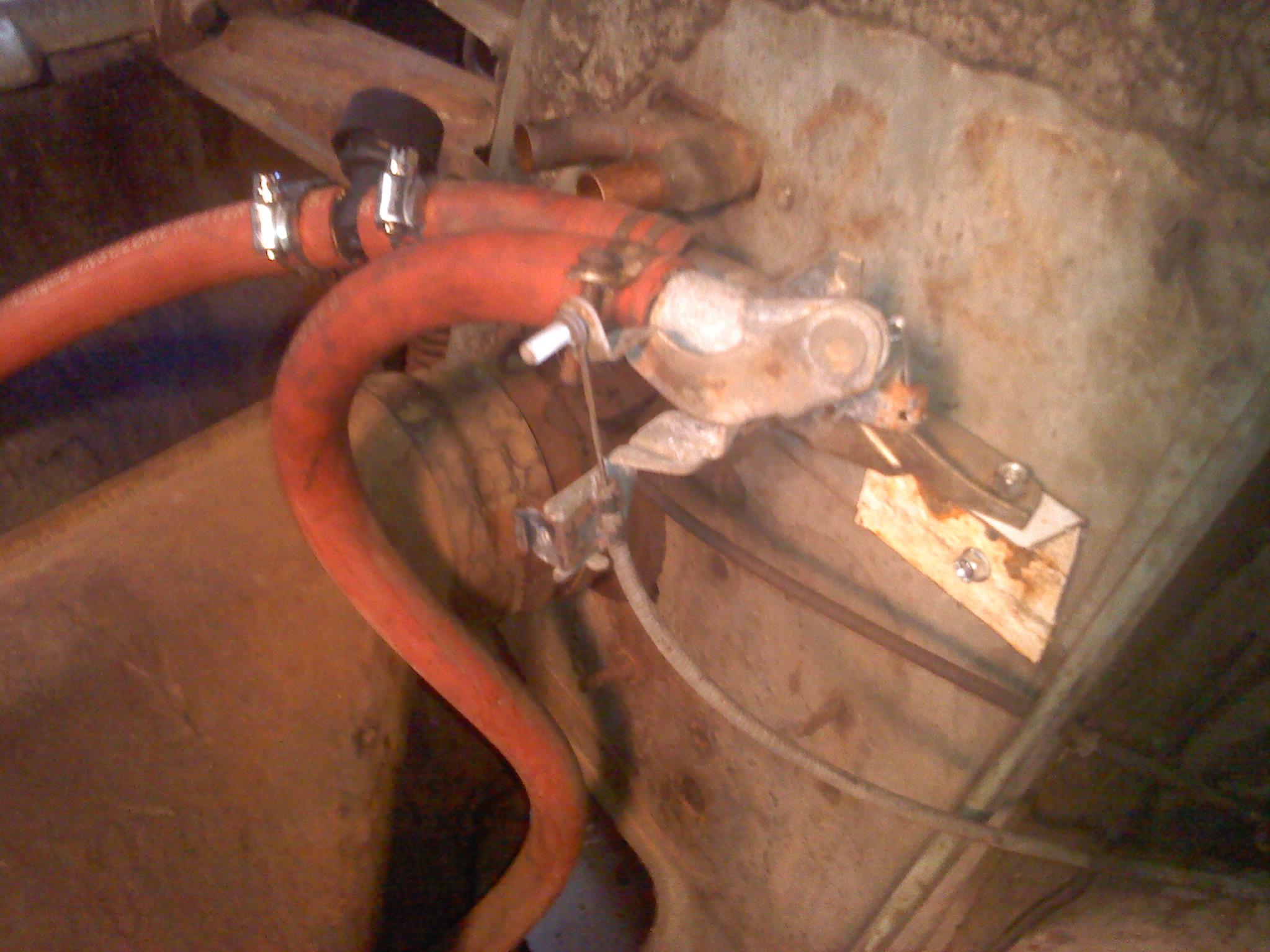

    How about this for a couple bucks versus spending 100 to get my Ranco watervalve rebuilt. Thanks Toyota!
