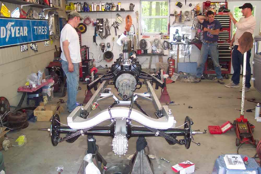

    I was over helping Gary and Mikey and couldn't help but take some pictures. We put the motor and ****** in and put the body on man is this looking sweet. Here are some pics.

    Chop is 3 in the back and 3 1/2 in the front. The rake isn't really noticable.

    We made some serious headway on Sunday. Junior and the guys came down and helped out a ton. Here are some more pics from the shop.

    This is the best picture of the rear that I have.
  13. So what did you do to keep the rear wheels in the correct position relative to the wheelwells on the body?---Did you reposition the rear crossmember about 3 or 4" towards the rear from its stock position?

    I have a question where did you connect that rear spring on ?
    Do you have a detail picture of that ?
    thank you

    Brian: The frame is hand built so there isn't any kind of stock cross members or anything. If you go into the tech archive, I believe there is a post on building this frame. I would help you out more but Clark built the frame so he has all the answers. Thanks for the positive feedback from everyone.
  19. Motor Mikey---Thanks---everybody and their damned dog wants to know how to run a spring behind axle setup like that, using a stock location rear crossmember on a model A ch***is. I keep telling them that if ya do that, the axle ends up about 4" foreward of where the wheelwells are on the body. The only way to do it is move the crossmember back about 3 to 4", then they can run a spring behind axle setup and keep the wheels in the correct position relative to the body wheelwells.

    after reading my post again I realised I have to ask this different ...
    Where did you connect the rear spring on at the wheel side ?
    Is there something hanging from the back off the axle ?
    If you got a picture off that please show it .
    thanks Ward ,

    looks like 35/36 wishbones....they have the spring mounts on the ends of them

    Ward...the axle housings are 48 Ford and we used the spring hangers that came on the rear.
