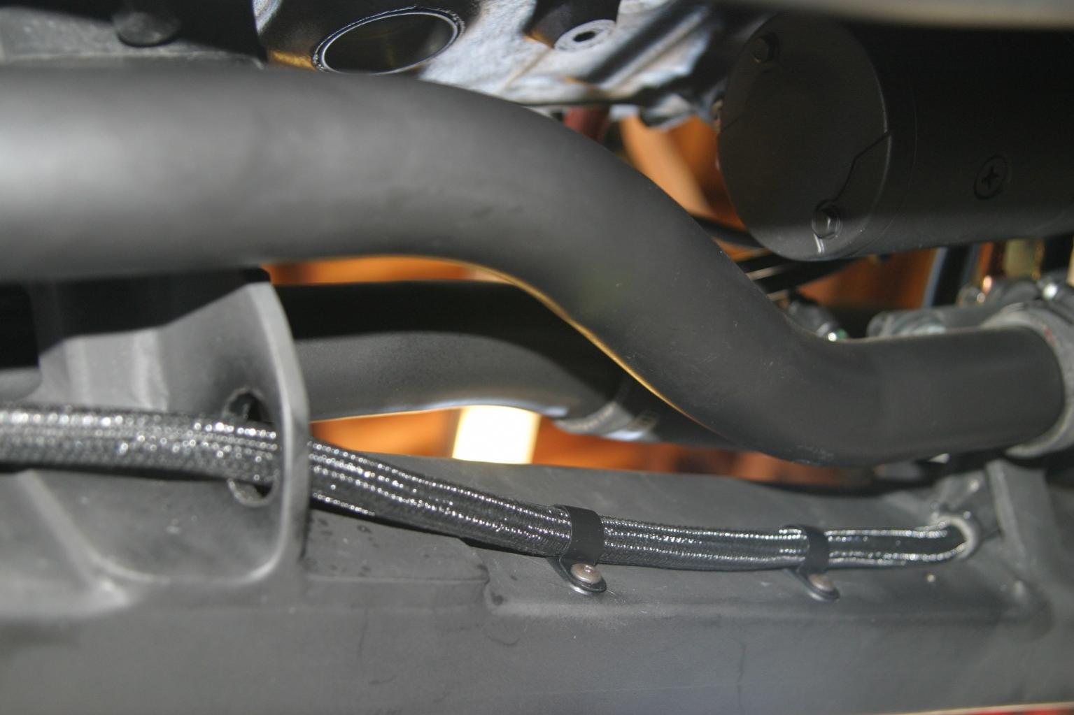

    pic #1 is running the wiring loom across one of the rear panel support rails... we used a shielding that wraps around itself so you technically don't need zip ties, used factory loom clamps as well. you can also see the fan temp sensor along with the probe in the radiator itself and the wiring going over the rear upper shock support (top of picture)
    pic#2 is the wiring running across one fan to the radiator fan relays, going up to the fuel cell level relay, going down to the carbon canister and continuing to the rear lights.
    pic#3 is the carbon canister (bought a new can and a factory wiring plug) still have to hook up the vacuum line.
    pic#4 is the wiring at the alternator... feeds the electric water pump, water temp and continues to the d/s headlight.
    pic#5 is the wiring going over the rear upper shock support and around the radiator... hence the hi temp heat shielding... hard to tell but where the harness bridges up and over the metal support is actually going 'around" it not over it..
    one more pic to follow

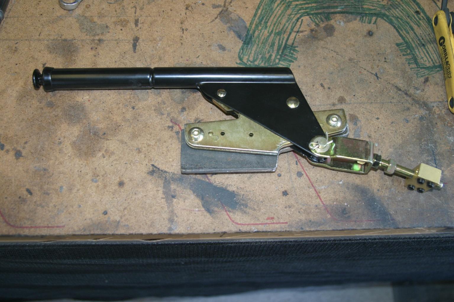

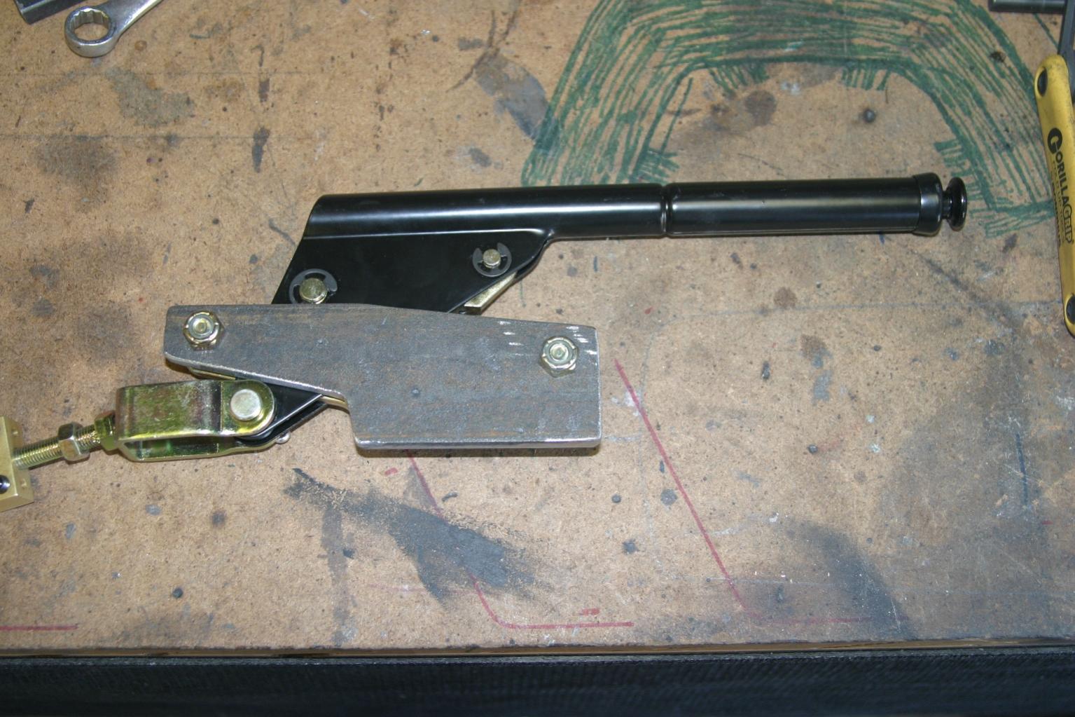

    e brake ...
    after buying this cool part.. I had to remove their mounting hardware and fab my own... I decided to mount it on the left side of my seat ala corvette style since there was zero room on the other side..
    pic #1 and pic #2 show the mounting bracket
    pic #3 shows the cables running thru the frame
    pic #4 shows the cable mount bracket and the entire system mounted... you can also see some of the seat mounts and some of the seat harness mounts... and the front u-joint ****ter shield
    since I have changed the rear frame rail and the cable path under the car I will post those pics later...

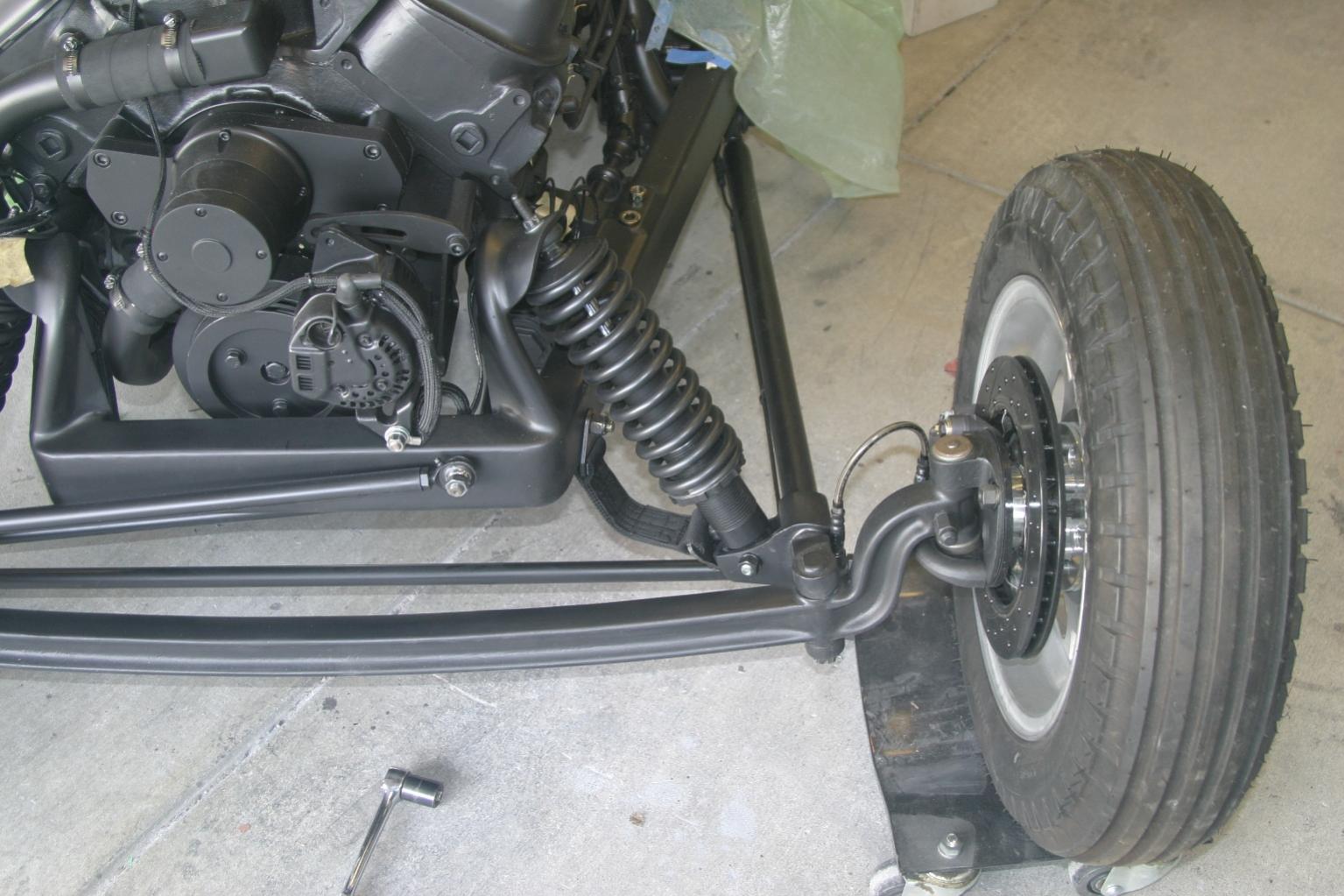

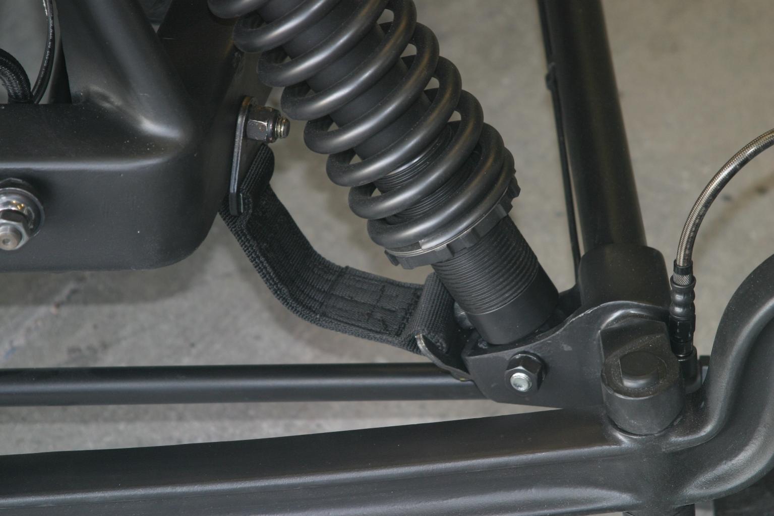

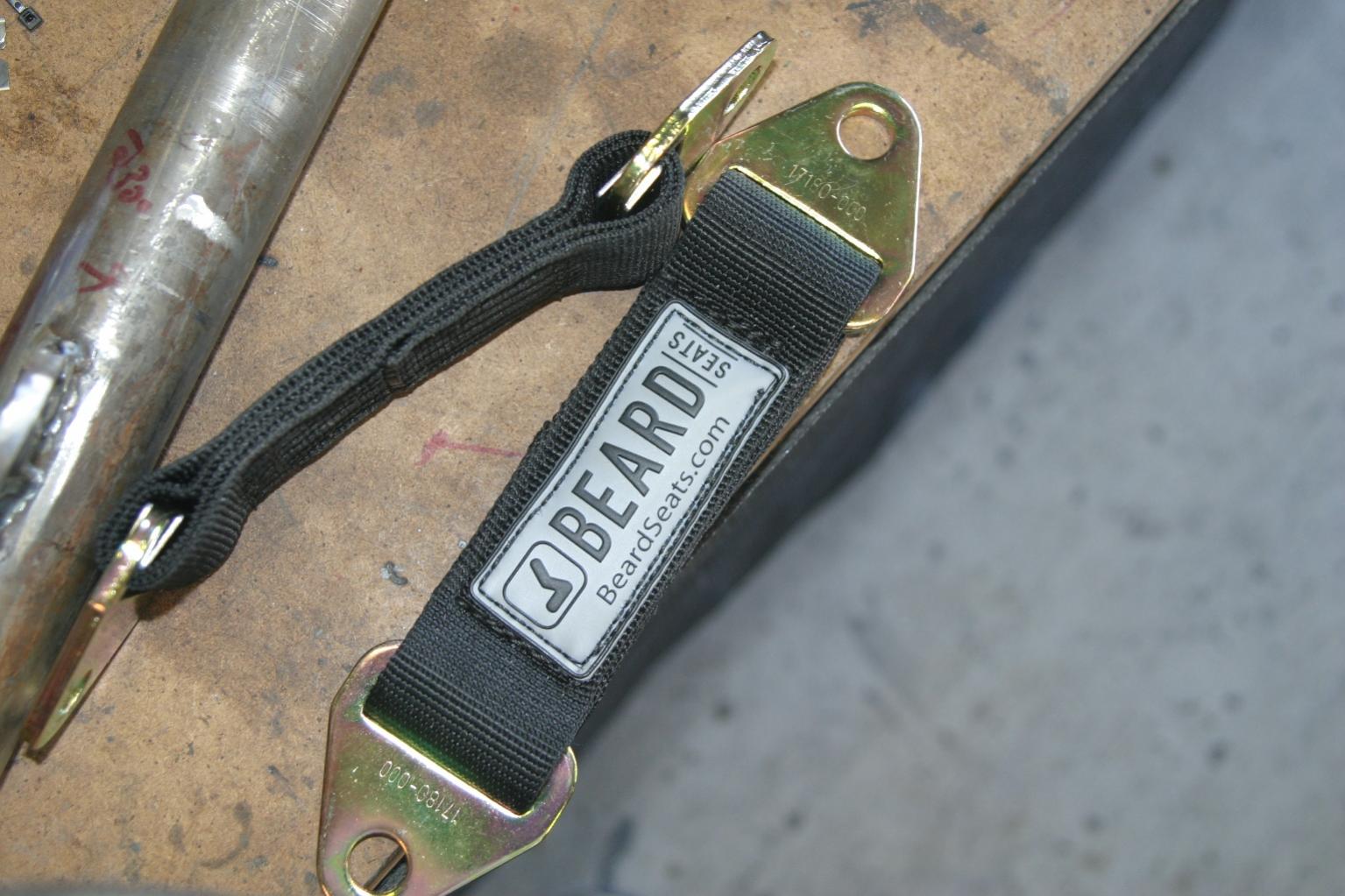

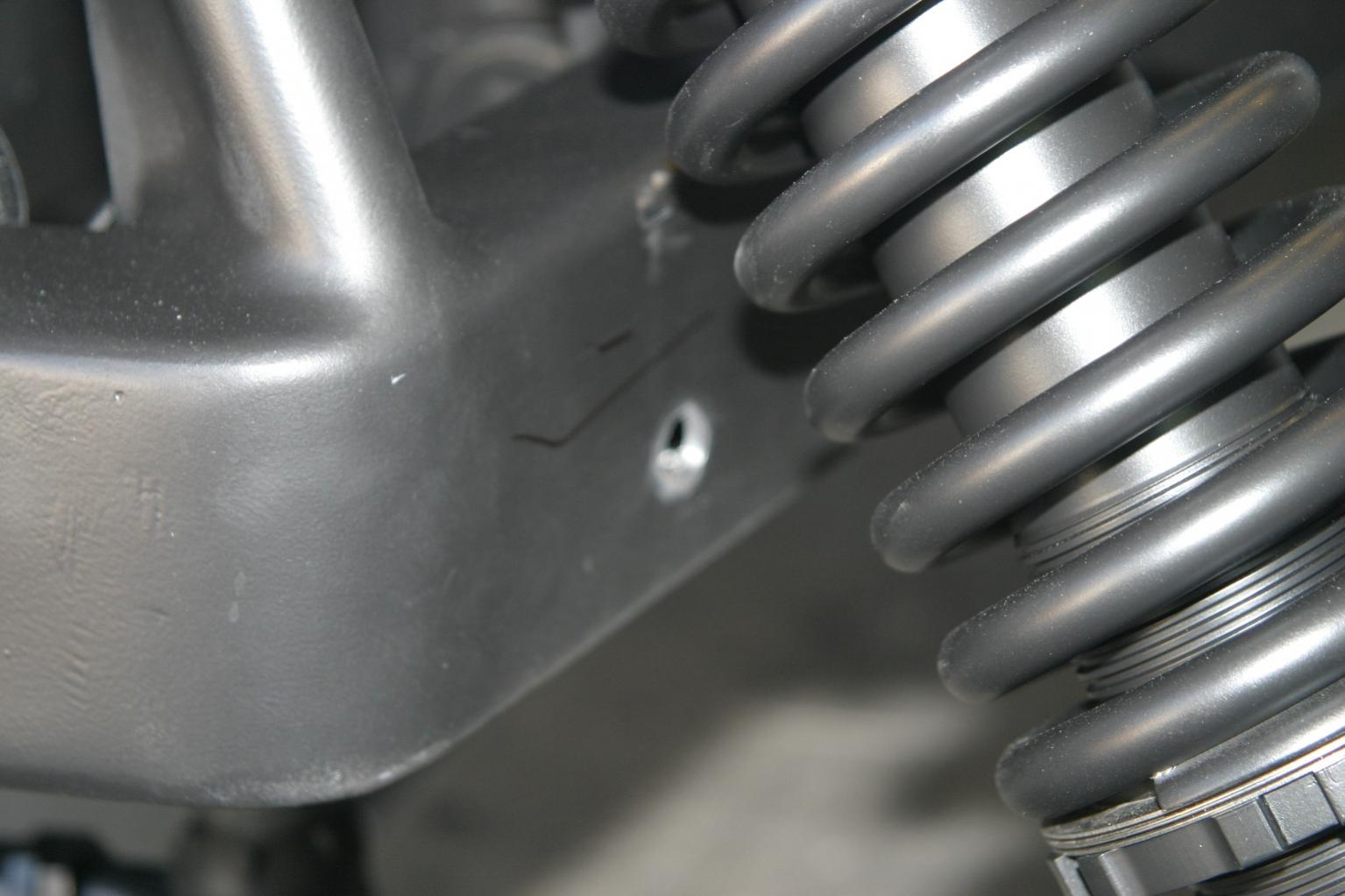

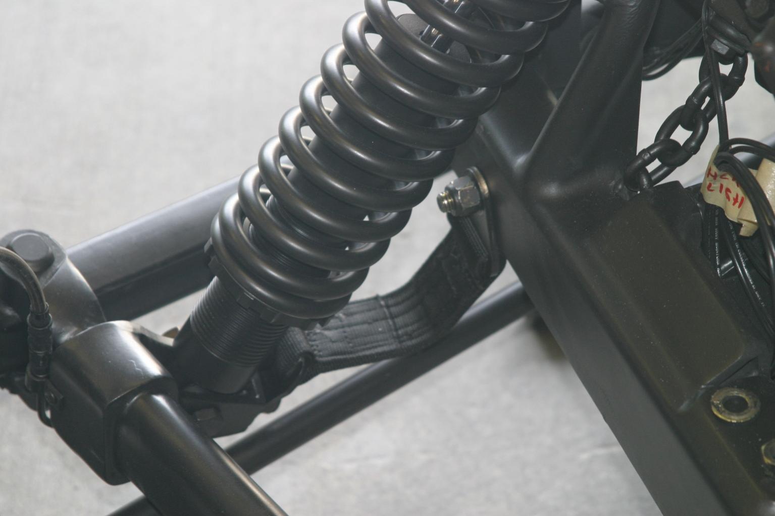

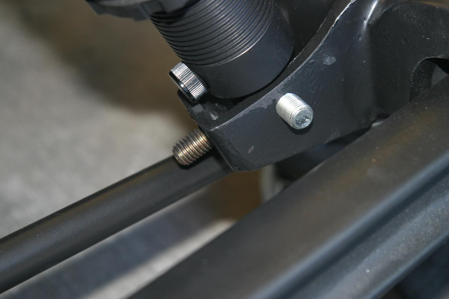

    front limiting straps...
    since I have adjustable coils on the front and the shocks have more travel than the length
    of the spring under weight I had to run limiting straps so the coils would not unseat from the perches when the wheels lift... the springs compress 2 1/4" under load so any shock shaft extension beyond that and the spring would unseat from its perches... so if the front end lifts from a hard launch I need to limit the amount of extension the shock has, sooo limiting straps it is.. besides the coils unseating from thier perches I never want the shocks to see the end of their travel...
    (I'm guessing a 2000# car with a 8 1/2' wheel base and all the engine behind the axle with 635hp and 522 lbs/ft of torque with 4:11 gears a 3100 stall convertor and a trans brake... probably a safe guess the front end is going to lift from a hard launch)
    pic#1 is the monster 4 layer straps I bought... I think they were $25 ea
    pic #2 is the grade 8 bolt welded into the lower shock mount
    pic #3 is the frame bolt hole (oooohhhh wow a hole)
    pic #4 the strap installed
    pic #5 the wide angle shot
    pic #6 back view, also shows the chain from the block welded to the frame.... (about 3/16" of movement allowed in the motor mount)

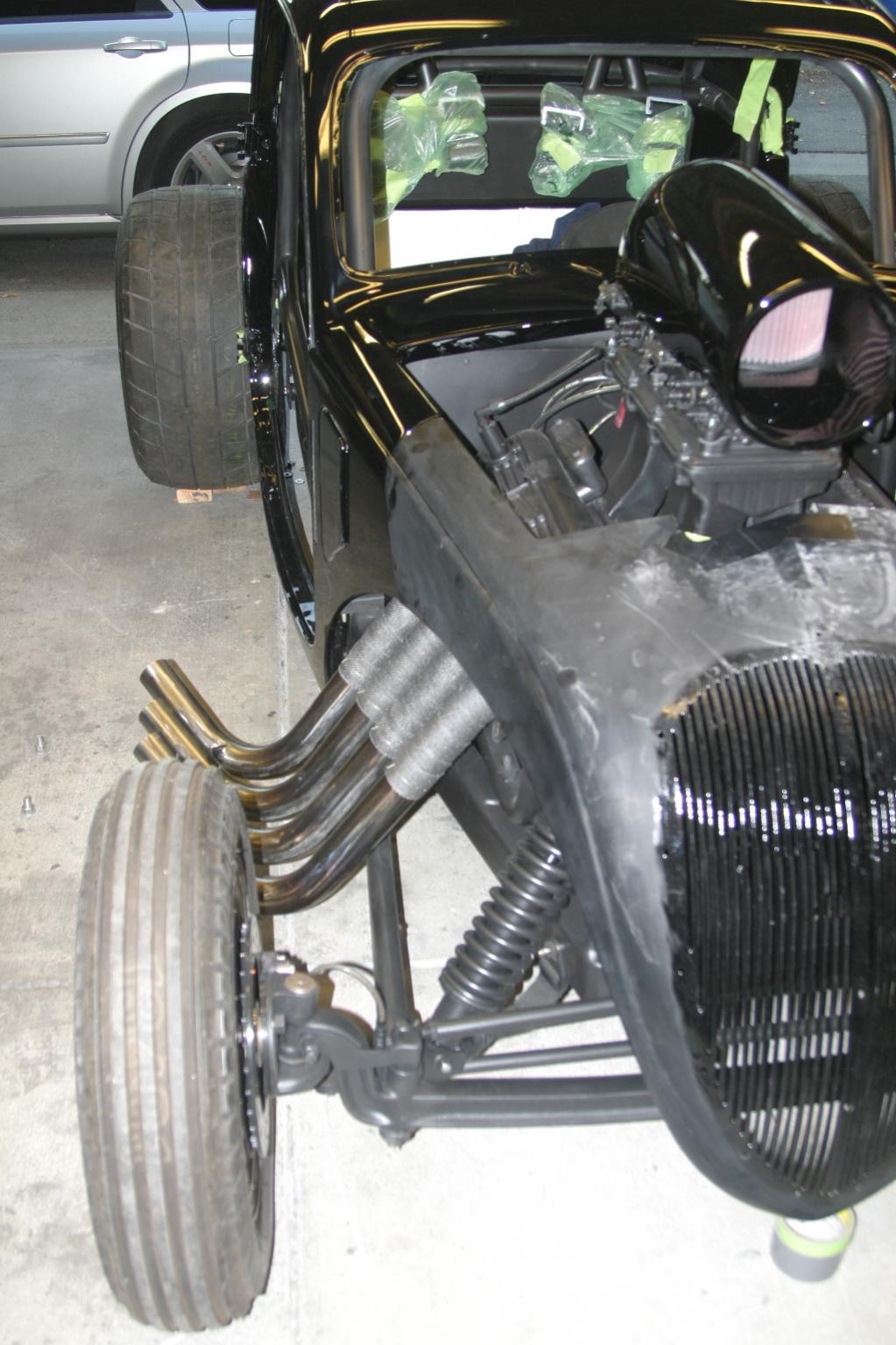

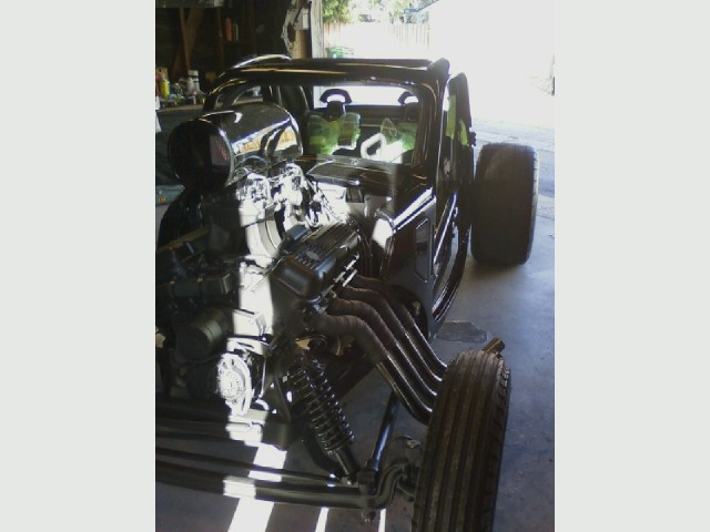

    When I started looking around for an air cleaner/filter set up I was shocked at how limited the choices where. In fact, everything out there for
    a dual quad was running 2" tall filters and that was NOT enough airflow for this engine...
    I talked to the tech guys at K&N and they crunched my numbers (cam, valves, heads, max rpm, carbs, etc) and came up with a minimum amount
    of air flow the engine needed to breath. I looked at what they offered in the "middle" range as I did not want to be flowing the minimum amount of air.
    I decided on a 4" tall air filter that offered plenty of air flow, now the issue was finding an air cleaner that would fit them. NOPE
    Soooo what can you do with some really large pieces of PVC?
    pic #1 these are 8" I.D. pvc couplers that are solid and thick and have the bend I wanted to start with.
    pic #2 after doing some slicing I mocked up what I thought I wanted to end up with
    pic #3 this is the steel bottom plate I fabbed... getting the stagger bent in correctly was fun... a bit off short or long and it doesn't sit on the carbs.
    pic #4 after slicing the collars off both parts and t******* them over and over to get down to the size I needed to start with..... hmmm $80 down the drain?

    pic #1 is the front view before I removed the rear side of the rear part. I wanted to utilize the air pressure that naturally builds up at the base of the windshield to feed the back side of the rear filter
    pic #2 I took one of the large collars and cut it into 4 parts, then removed 1" from each part and taped them to gether, then sliced the 4 parts with a little bit of a pie shape to them so the opening is a little smaller than where the collar meets the main frame section (helps to pack the air) also made the opening just a bit square, dont get me wrong its a round opening but if you look closely there are 4 corners within the round...
    I sliced into the pvc and epoxied in steel rods for support
    pic #3 this is the front look, you can see how the air cleaner drops below the front carb to grab more air and force it up into the tunnel and the 2" above the front air filter feeding the rear
    pic #4 now the fiber gl***ing begins...

    these pics are with my phone so they are not great
    pic #1 is a side shot, the "end" collar that is detailed in an earlier post about the "pie" cut when pieced back together shows up in this side pic as you can see it sweeping down across the top. I also shot rubberized texture on the inside to slow down the air flow and cause turbulence, which makes for a more dense environment for the engine to breath from.
    same rule of thumb that after you polish your intakes and exhaust ports you rough them up with sand paper so the air along the inner walls bumps and rolls which actually causes more air to flow, otherwise the air along the walls sits fairly still and the center of the ports flow rapidly
    pic #2 is from the back side... using the high pressure area at the bottom of the windshield
    also this allowed me to keep the air cleaner thinner with out limiting air volume.
    pic #3 is the front however it does seem to have a "fisheye" lens affect haapeing in this pic.
    you can also see in this pic how I forgot to notch the nose panel to clear the intake, duh. I pushed the intake back (this is before the engine turned out to be junk and the intake was sitting loose) to make the side mounts, then pushed the intake forward into correct location (with the nose off) to work the body behind the engine.... repaint anyone?
    when I started playing with this thing I was just going to make a plug and then pull a gl*** part off of it, as I got farther and farther along it seemed to be a functional part, it was less weight than every other part I looked at, it was certainly stronger, it allowed for larger filters which no one else did, soooo I painted it. the 2nd and 3rd pics below seem to have a rather comic strip thing going on.... maybe they can counter the "evil stealth" look ?
