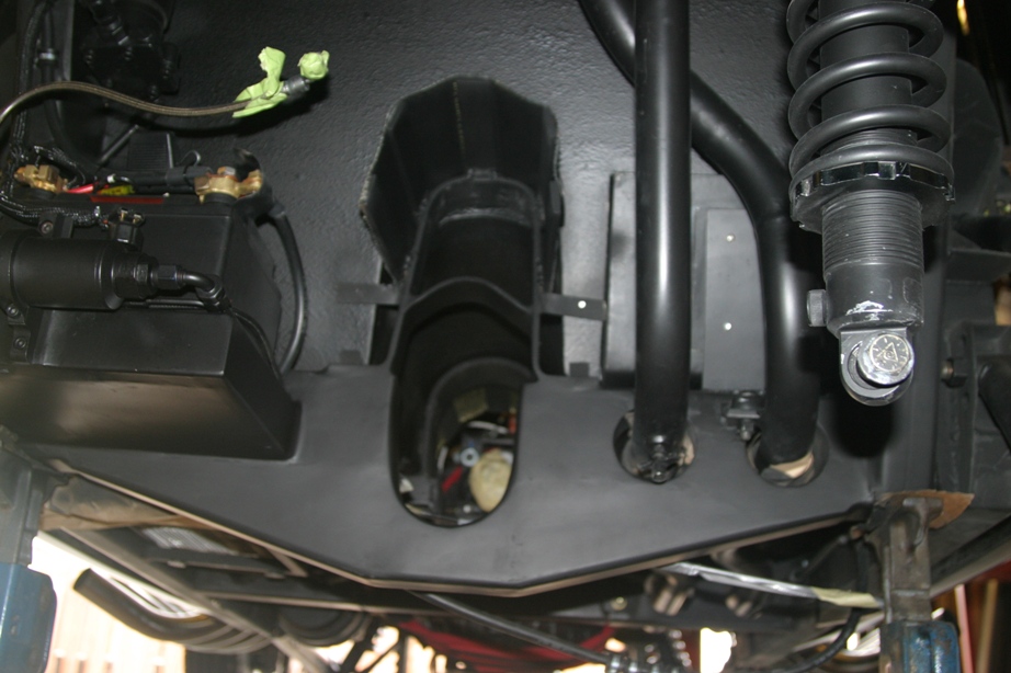

    pic #1 shows the new rear cross frame part I fabbed to allow for driveshaft clearance after changing the ride height etc.
    pic #2 shows the part welded in place
    pic #3 dif angle... the bottom of the battery tray was the bottom of the frame, I cut the notched area out of the frame and lowered it into the new piece, this allows for the new "full drop" distance of the rearend... you can also see the new upper driveshaft loop and the old upper is still up in there higher (going to use the area between the two for a center console storage area) also had to rerun the battery cable slightly, the p/s front brake line slightly, the p/s e-brake cable slightly & shorten.
    pic #4 shows the rear residual valve we cut into the brake line (will show front valve later) because the calipers are higher than the master there was a bit of leak back when the car sat and therefore the first push on the brakes was more pedal thrust than desired, these valves stop that from happening.
    pic #5 shows the new brake line to the rear caliper, with the rearend narrowed another 3" on each side the old lines that used to wrap around the 4 link supports had to get trimmed, while I was thinking about it it came to me that I had gone hard line across the rearend and right into the caliper... if I ever wanted to remove the caliper I had to open the system duh... hence the new steel braided lines. new fittings and blah blah blah for clearance etc.

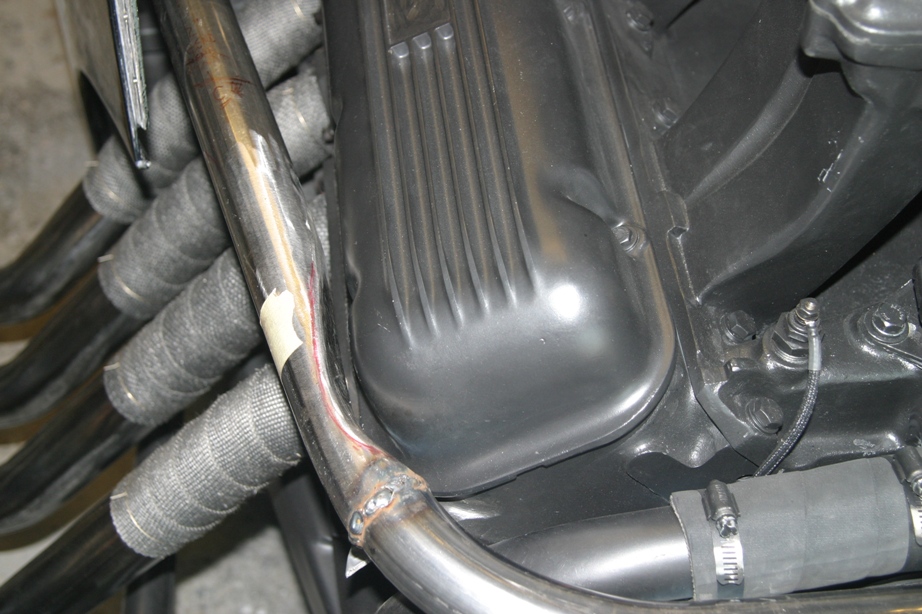

    I was working on a way to mount the front nose/grille panel and after spinning my wheels for 2 days bending small tubing and plates and etc. I figured it wasn't working because it wasn't right.... then I remembered that I wanted to extend the roll cage to the front of the car but couldn't until the body was mounted so I could check clearances.... YIKES there isn't any!
    mocking something up that is floating in space, is going to have 4 contact points, is going to have to slip fit together, be level, be straight, clear a bunch of things is more than a bit challenging... FUN!!!
    pic #1 shows the mock up stages on the tight side first. remember that the engine is mounted 7/8" towards the p***enger side so there is no room. I had to clearance the tubing and then weld a plate back in to return the strength... I had to design this part to be removeable so the end that connects to the A piller bars slide onto a small snout that is welded on to the A piller bar and a bolt is tightened thru both tubes once slip fitted in place.
    pic #2 is making clearance, with the nose in place there is 3/16" between the tubing and the panel, however since they move with each other that is plenty of room :/
    pic #3 is the clearance set for good (ok maybe it was changed a few more times)
    pic #4 is the cage in place
    pic #5 shows the nose tubes with an alignment pin in place, I welded tabs on the frame rail and cut slots on the back side of the down tubes so when the cage slides on the back on the A piller snouts the frame tabs slide thru the down tube slots and then bolts go thru the tubes and tabs.
    pic #6 is a side view. the water pump tubing is also a close fit, however with the engine being chained to the frame and only allowing for the motor mounts to move less than 1/8" there is no clearance issues.

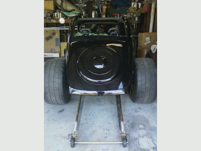

    played with wheelie bar set up yesterday.... just long enough to figure out "what the ****?" : ) after I made all my ***umptions and calcs I called the guys at Alston and rambled to them... turns out I wasn't that far off on my theories for set up... shipping back the first set of bars I bought and just ordered a set from Alston...
    (first set was old school with the flat plate for the bottom bar and the spring on the upper bar... I knew the flat plate also functions as a secondary spring but when I found out how much it actually moves it was way to much, out with the old and in with the new... round bar upper and lower)
  11. Zoomer
    Joined: May 15, 2009
    Posts: 222
    Zoomer
    this is the first set mocked up (just a wee bit too long).... they are getting shipped back monday, the new set from Alston arrive wednesday. I bought a kit that allows me to make the length whatever I want.
    Got the ride height where I want it finally, that allows me to move forward with welding my headlight arm bracket mounts to the frame....
    Hoping to get the head lights finished this week along with the wheelie bars and the tail lights..

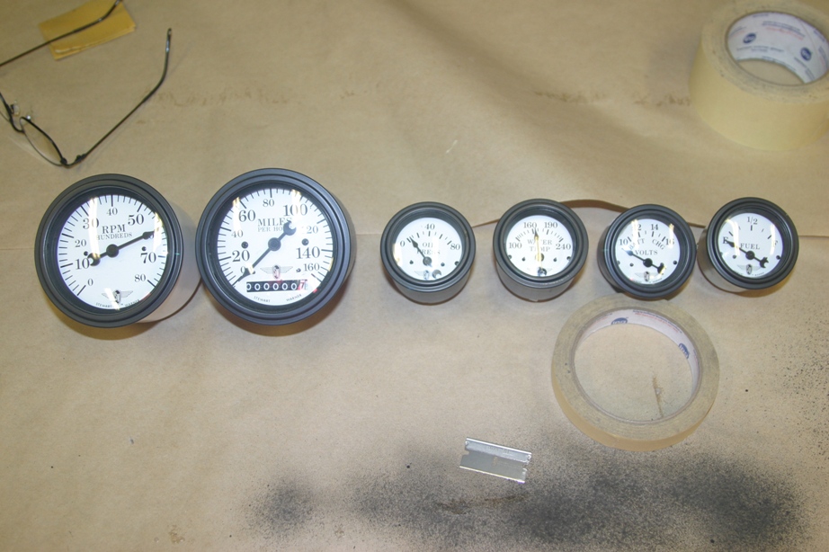

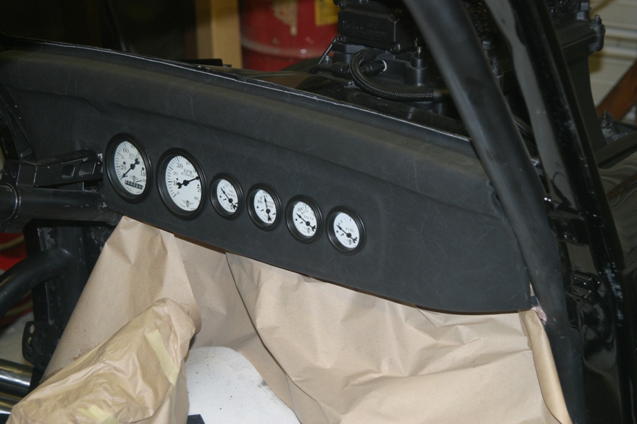

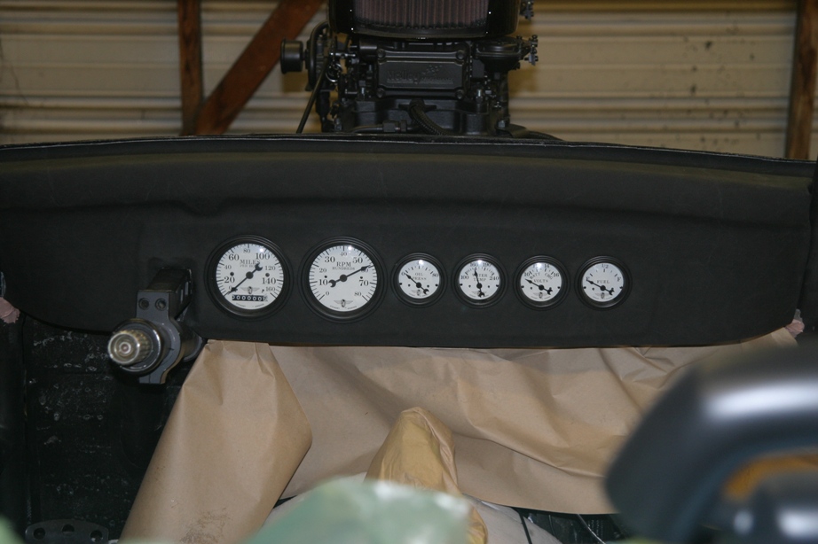

    There are a few dash pics on page 16 of this blog...

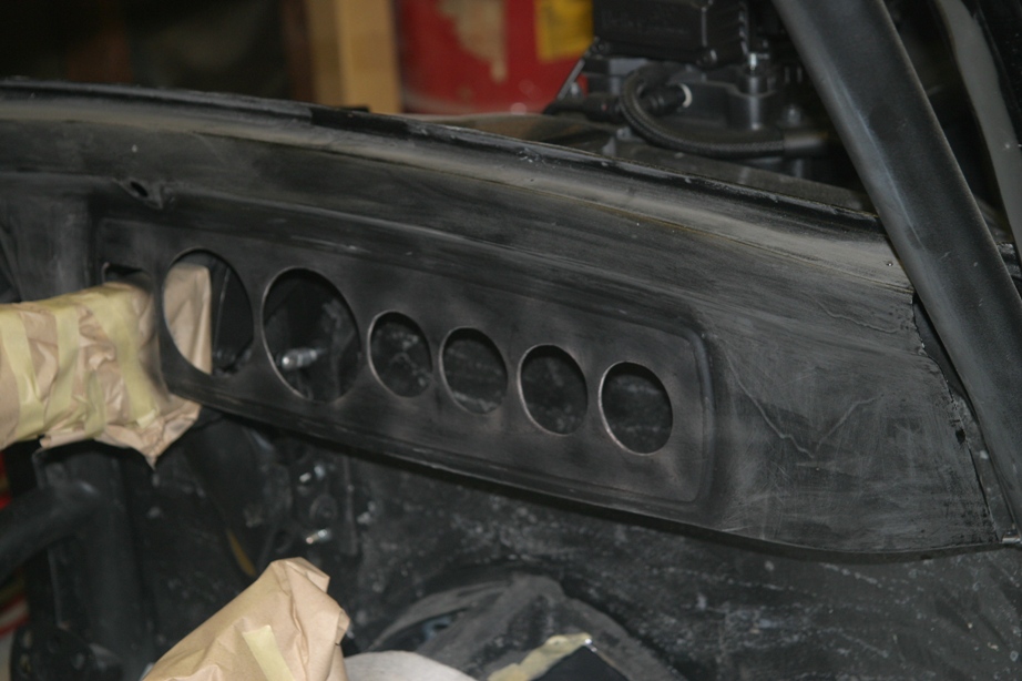

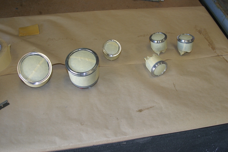

    pic #1 shows the insert I built welded into the original dash.

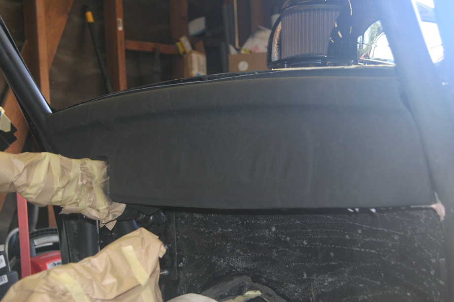

    pic #2 is the distressed leather glued in place
    pic #3 is the gauges about to be DE chromed
    pic #4 all is well
    pic #5 all installed and wired back together
    pic #6 another angle
    still have to finish body work on tabs that are welded to the rollcage and
    bolt to the dash on either end. Also built a brace that mounts on either side of the
    steering column and bends up and over it. Have to buy some small brushes so I can
    finish wrapping the dash around the edges ie: around the steering column opening.

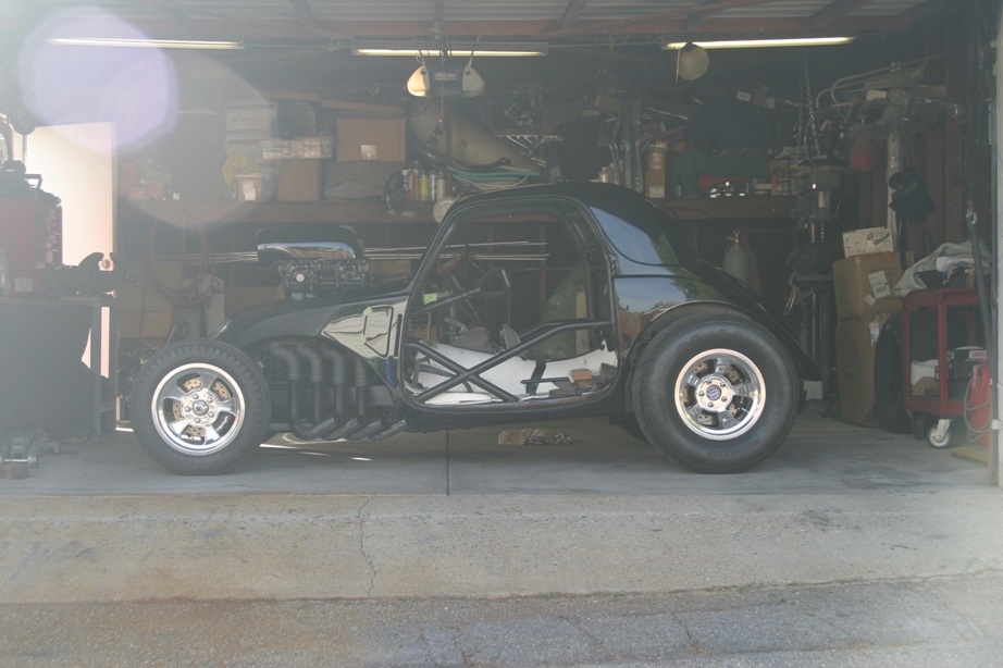

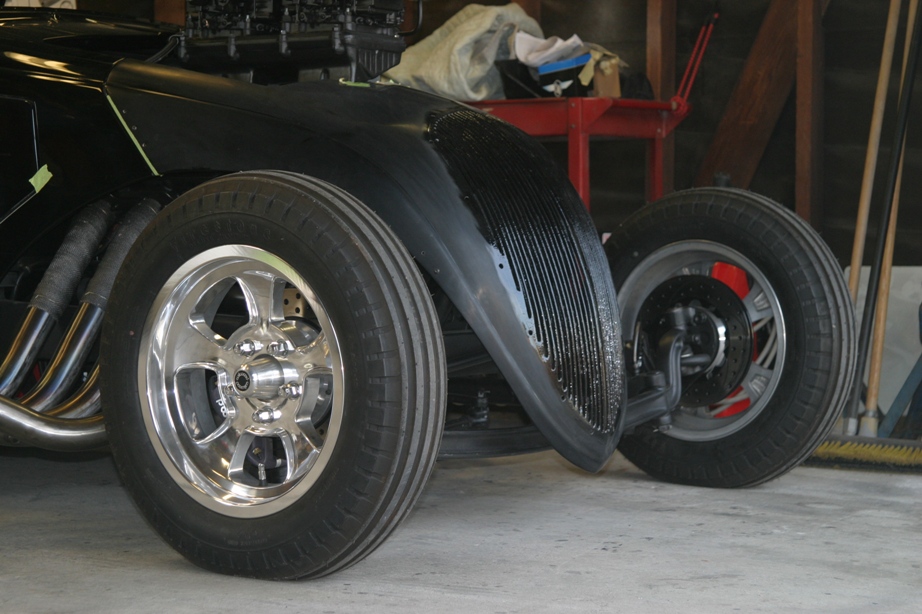

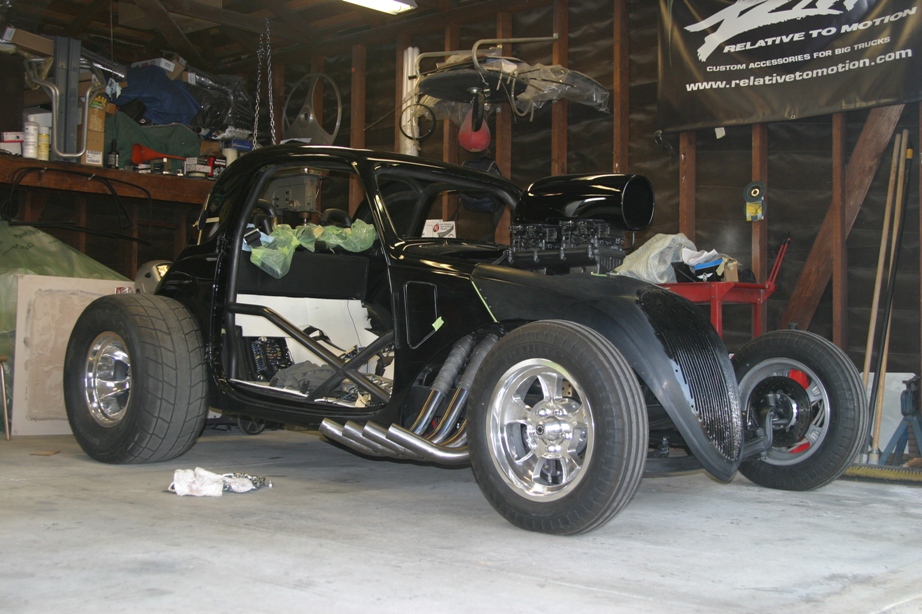

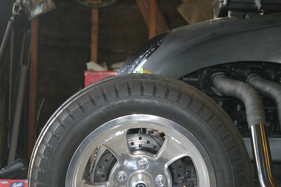

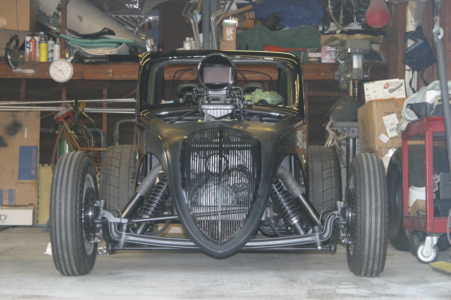

    these are from last week when I was figuring out the correct ride angle I was shooting for....
    pic #1 is a bit wider shot then the previous post... this is exactly what I was looking for, the nose just out past the axleand right in the visual pocket for close tothe ground but not to close that you can't drive it. I can go right over a pretty steep speed bump without concern as the lowest point of the nose is 2" in front of the tire footprint and 4" off the ground.... there are 3 holes that mount the nose to the body (there will be a pressure plate on the nose when its done) and if you follow down the nose there are two more holes that connect the nose to the mounting brackets that tie into the engine cage (these brackets mirror the shape of the wheel opening so they disappear when you look in)
    the grille bars where pretty hammered so after some straightenign I sprayed a wet coat of undercoating and then painted it. The texture actually removes any visual cues that the grille bars aren't really straight. I still have to paint the grille trim and polish the nose (of course I have to do some welding on the nose so its actually going to get a rererepaint)
    pic #2 this is taken from laying on the ground as I was checking a few things out and thought this pic is ok to post. From the bottom of the pipes to the ground is 5.25", which is .5" lower than the oil pan. Happy to have that much clearance to the ground.
    pic #3 still working on the stance. this angle doesn't show how cool the rear wheel fits the wheel opening and how this new angle of the car really "speeds up" the rear lines of the car.
    pic #4 the nose is merely set in place in this pic but you can clearly see how the engine is set to the p***enger side 7/8". Lots of reasons for this...
    I used to draw pictures from this pov of a 32 ford.... I like this better.. the headers, the coil overs, the big rotors, the tight brake lines, the limiting straps , pan hard rod, seeing the front of the engine and not a radiator... omg the ton of shi*t in my garage.... YIKES!!!
    (before the body was mounted I actually had the rolling ch***is on dollies, the body on a rolling cart, all my equipment AND I parked my hemi magnum in the garage ALL of it everynight..... soon as its finished a bunch of the stuff gets to leave.... yeah!

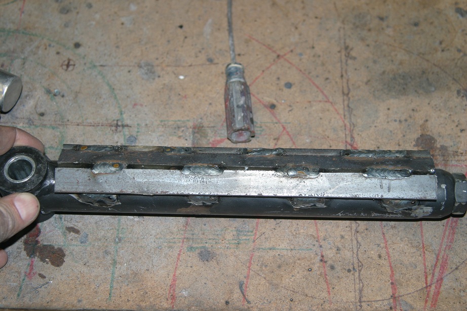

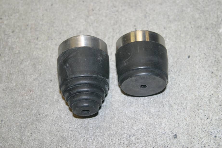

    I decided to use the upper 4 link bar as part of the bump stop so here's what I worked out.
    pic #1 is the upper 4 link bar before I grabbed it.
    pic #2 I took 1/4" steel plate and welded it to the bar
    pic #3 I then rotated the bar and welded another steel plate, each plate is welded to the bar on the underside and to the previous bar on the top side
    pic #4 final with all the plates welded
    pic #5 in place

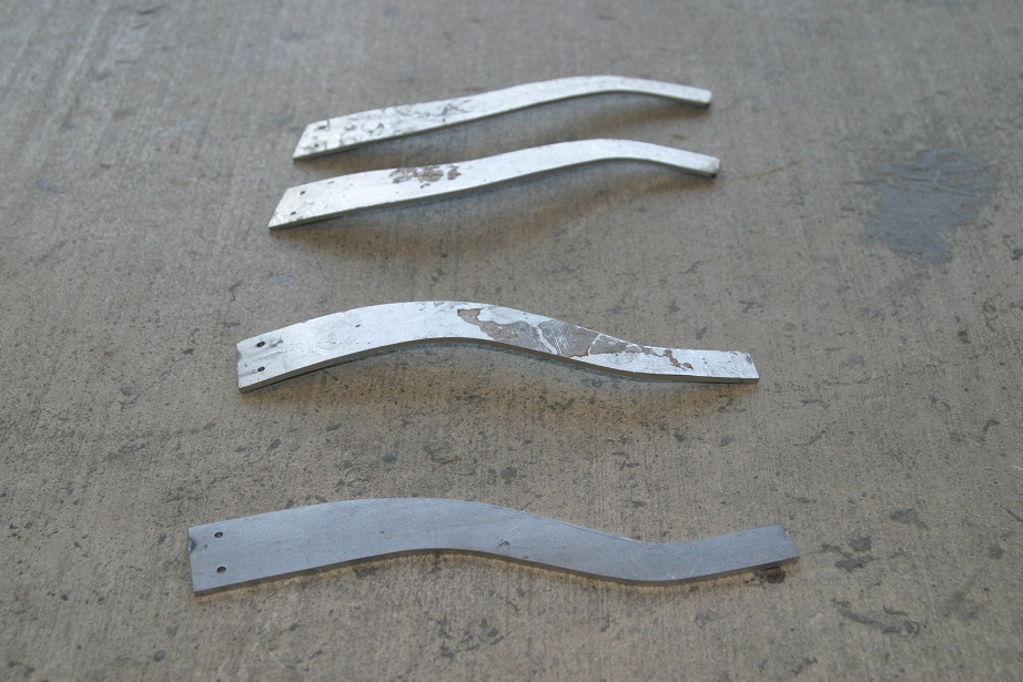

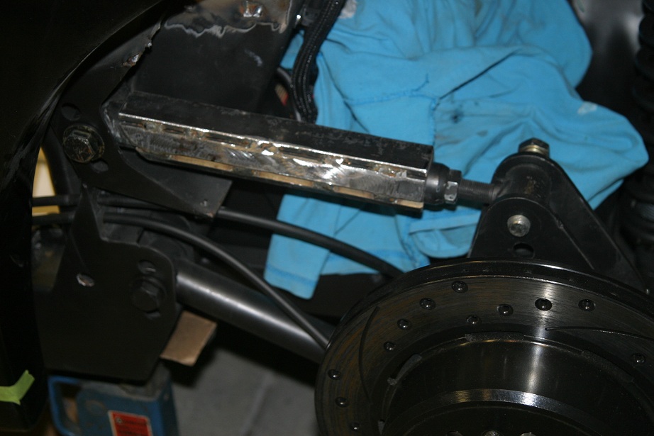

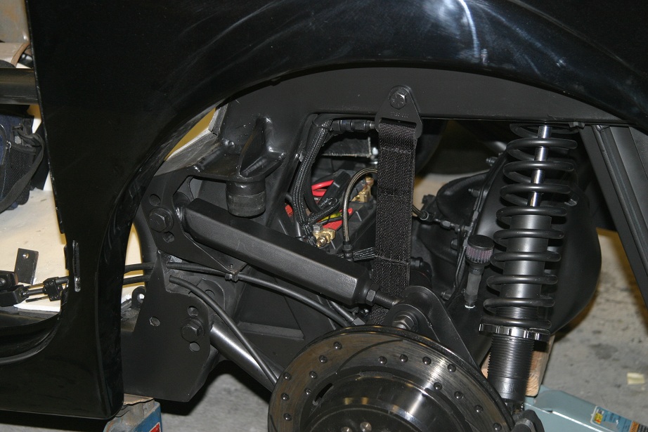

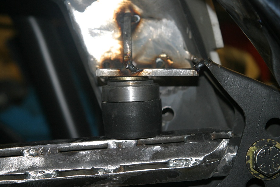

  26. Zoomer
    Posts: 222
    Zoomer

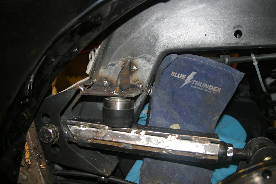

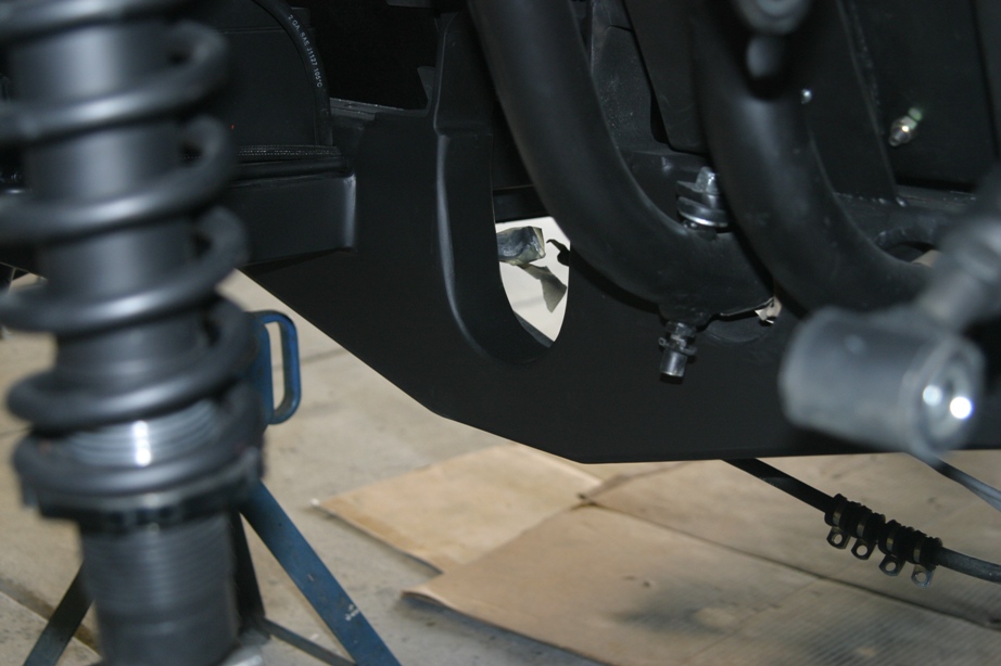

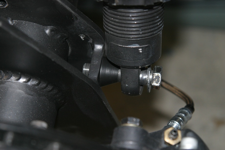

    pic #1 shows how much of the bumper I had to remove
    pic #2 the bumper placement. I had to remove the shocks to get full compression and then had to calculate the placement so that full compression stopped the tire before it touched the body and so the 4 link bar did not start to contact the bumper under normal road use movement...
    pic #3 shows the upper support that is welded to the frame and has the bump stop mount welded to that. d/s
    pic #4 p/s
    pic #5 bodywork completed and installed.. also gives a good view of the limiting strap, the e-brake cables, and the rearend breather.

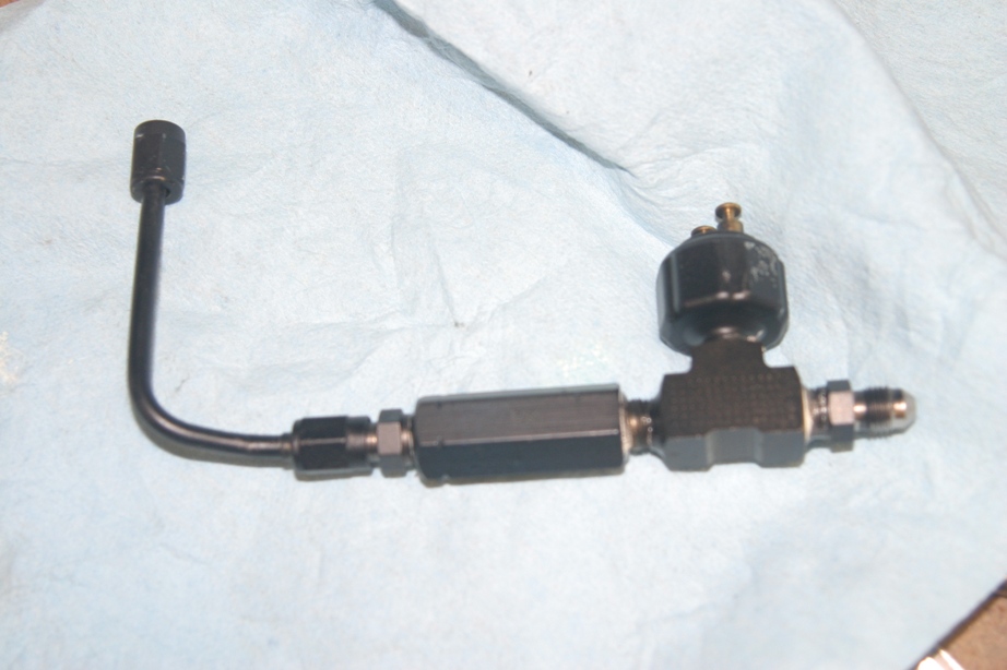

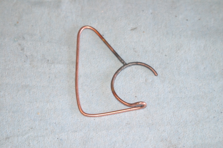

    pic #1 e brake clip I made to hold the cable away from the tire
    pic #2 mounted to the 4 link bar (screwed in place on bottom)
    pic #3 top view
    pic #4 this breather hose used to come out of the top of the oil filler cap
    via a slick machined fitting, however.... the line itself was just sitting to high to look right. so... time to design and machine again.
    pic #5 this shows just how much the new fitting was able to drop the breather line.
    pic #6 bottom view. had to machine a hole in the valve cover (there was a flat already there) and use an aluminum male fitting thru the cover.

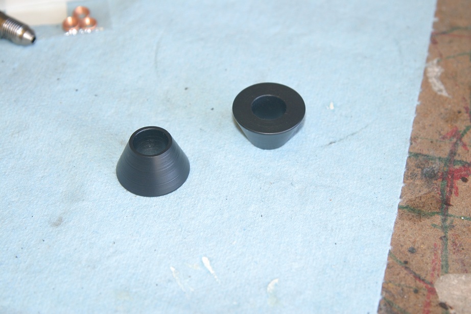

    more misc items....

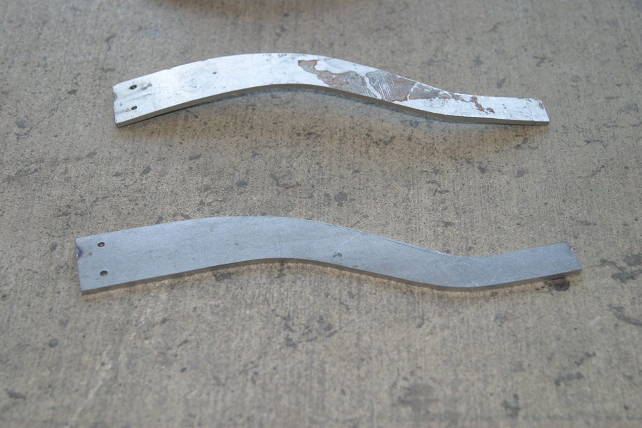

    pic #1 these little twisted plates are the rear mounts for the tail of the body to the frame
    pic #2 needed some rear shock mount spacers so why not do something different
    pic #3 in place...

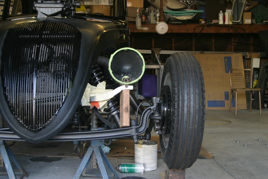

    headlights anyone? this takes about 20 pics...
    pic #1 is the first mock up for height and positioning

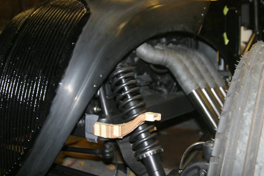

    pic #2 side view
    pic #3 mount arms

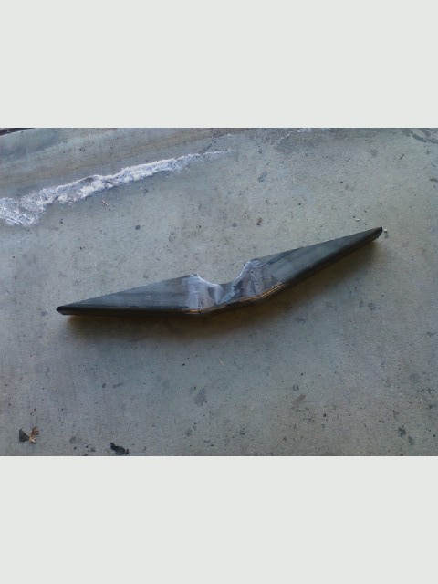

    pic #4 I cut some flat plate and then started doing some bending
    pic #5 making things match
