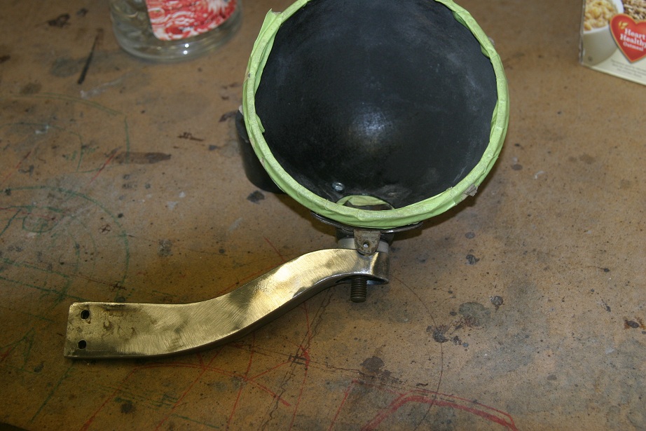

    and more.... these may be in an odd order so take a step back and look at all the headlight posts...
    pic #1 is the two sides welded together from a heavier plate and a heavy plate washer for the atual mounting area.. and then I closed it up with a thinner plate on the top and bottom
    pic #2 a different angle
    pic #3 bottom view
    pic #4 the complete ***embly
    pic #5 the hole on the back of the mounting bracket to bucket is soon to be gone
    pic #6 these tabs are for mounting and the wiring will be run thru the frame rail between the tabs.
    pic #7 this is a rough view before the mounting arm was welded completely.

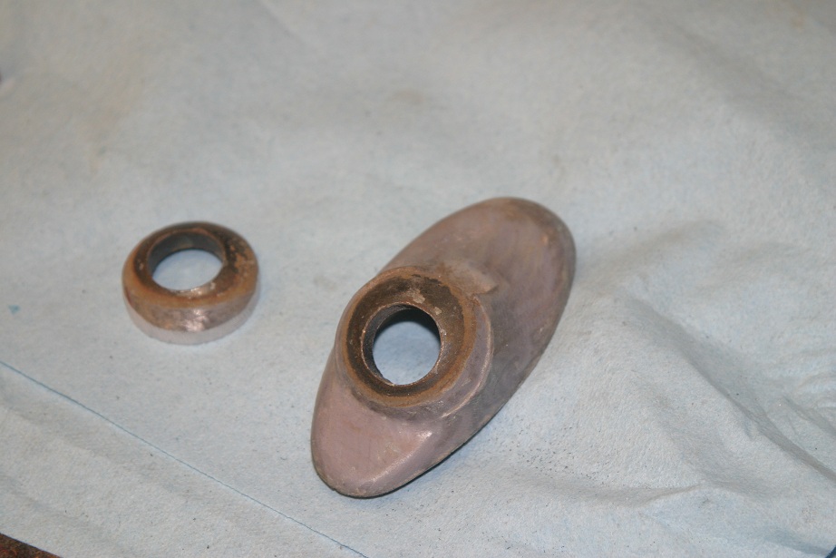

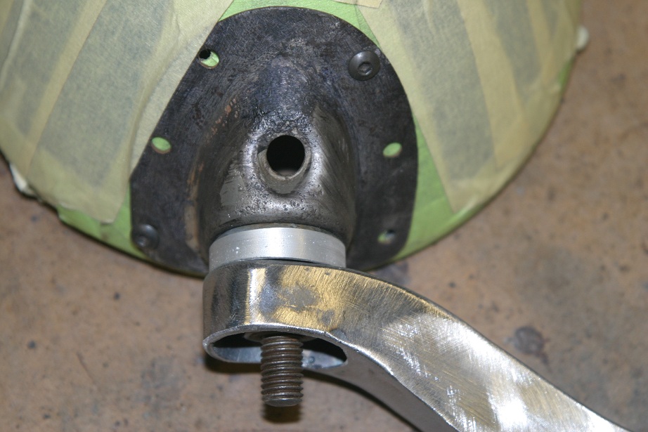

    and even more.... this is the mount stuff
    pic #1 the right side part is the factory mount that was used to mount to the fender, the left side part is after I machined it down
    pic #2 is the bottom view
    pic #3 is how the machined part fits on the mount part that is originally rivoted to the bucket
    pic #4 shows the parts and the wiring the mounting post had to be welded in place so I could clear out the side to slide wires thru.
    pic #5 complete structure
    pic #6 the post bolt will eventually be sliced shorter..

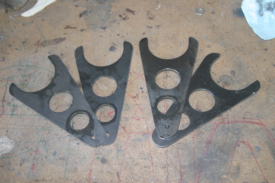

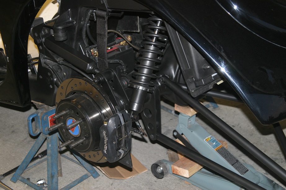

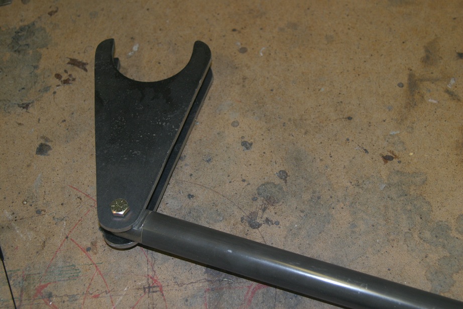

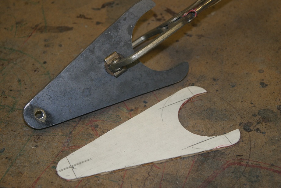

    the wheelie bar situation.....
    pic #1 working out the mounting points... bought the kit from Alston and it comes with long tubing, some tabs, some end plugs, wheels, and springs, and NO pictures ?
    I set the front end up in the air after deciding how much wheel lift and weight transfer I wanted. Alston says to put a 2" block under the wheelie bar wheels to get the correct front wheel lift.... after going about it by lifting the front end it turns out that the 2" block is almost exactly correct....
    decided on moving the upper bars inward from the lower bars, shows the rear housing brackets I designed.
    pic #2 top view
    pic #3 from cardboard to steel
    pic #4 plates on lower bar
    pic #5 decided to put holes in the plates and then weld tubing between for strength.
    pic #6 brackets finished
    pic #7 all the parts cut and mocked up

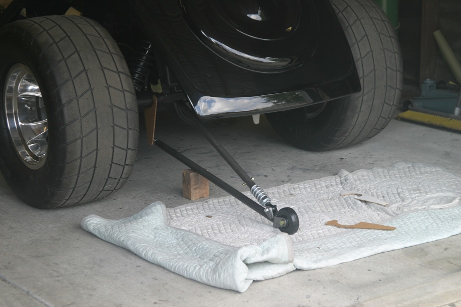

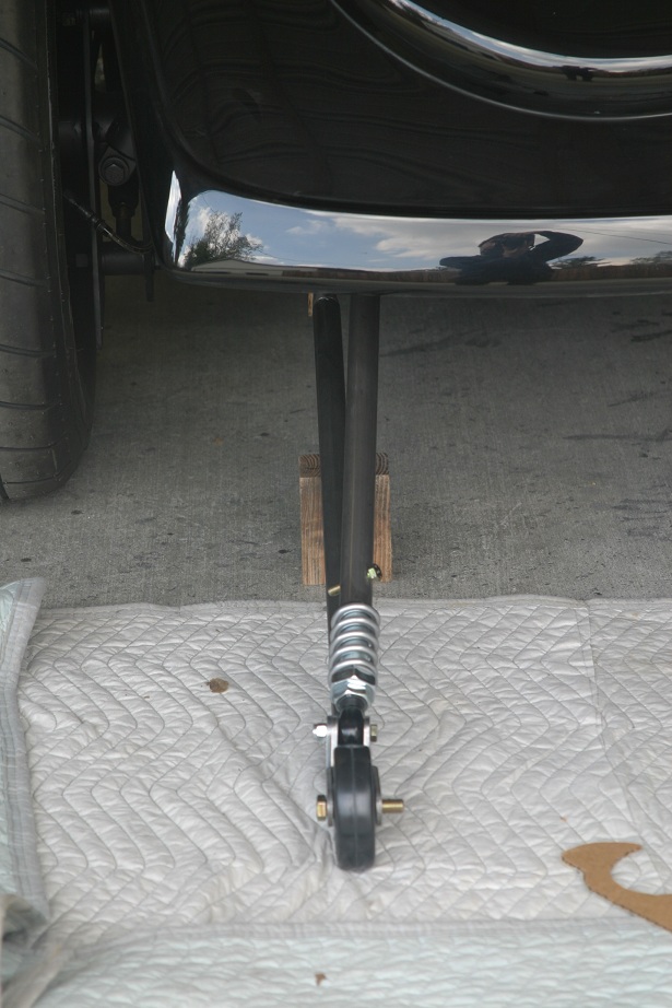

    more....
    pic #1 mocked up for welding the lower bars
    pic #2 then there is getting the bars straight AND centered so I had to run a piece of tubing off the 4 link plate and then 90 degree across the back with another tubing
    pic #3 side view... also had to remove the rear shocks and drop the back of the car on to the bump stops with the front wheels set at the max lift height I decided on so I can make sure of clearance.
    pic #4 time for fabbing in cross bars
    pic #5 upper bar tabs and lower bar mount
    pic #6 running stance

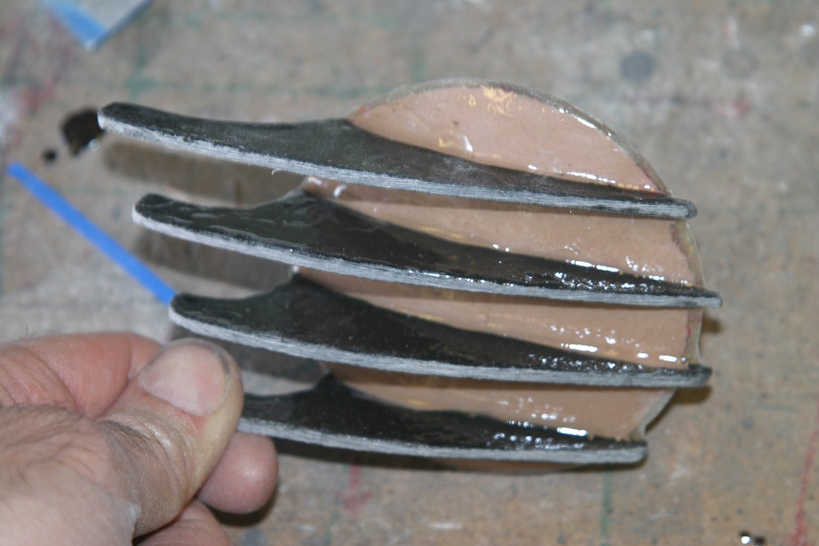

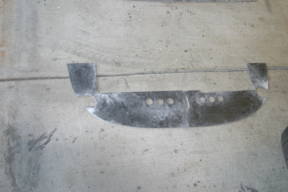

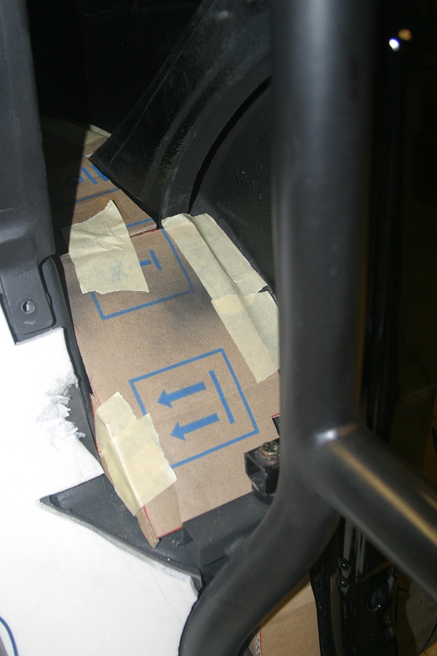

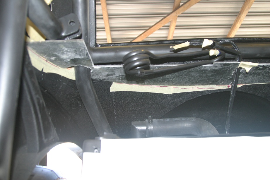

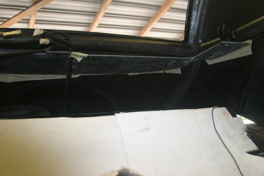

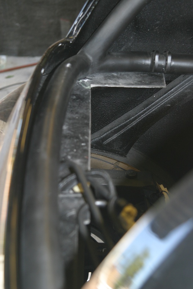

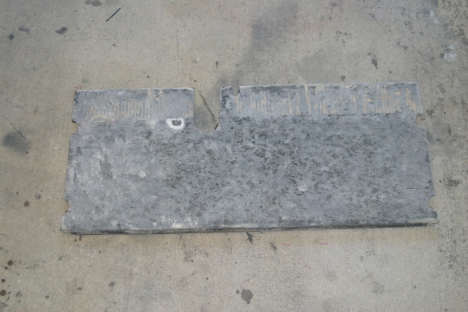

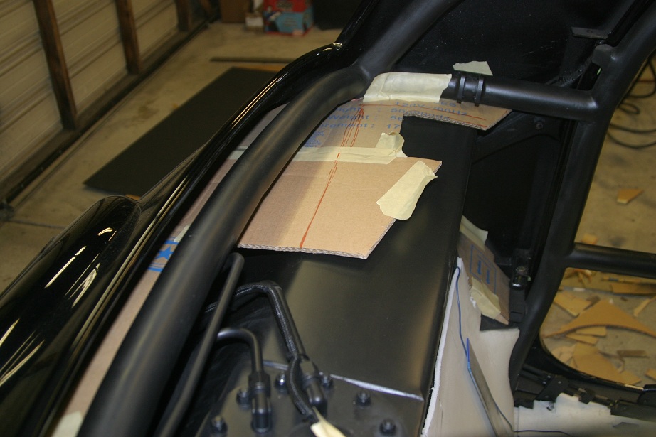

    some interior filler panels....
    had to go in and out about 20 times with the fuel cell on this one, fun with 6 gallons of fuel in it
    pic #1 template to close from the body to the fuel cell
    .. note the red line
    pic #2 panel made from interior cardboard with fibergl*** resin on one side and a sheet of mesh/ cloth weave on the other
    pic #3 bottom view of pic #2 (the white in the foreground is where the seat back up to)
    pic #4 bottom view of p/s panel
    pic #5 this panel sits beneath the fuel cell... it looks rough in the pic but its surface fibergl*** is ground for the next layer to adhere.

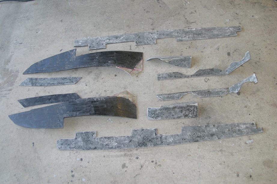

    more interior...
    pic #1 filler panel for rear wheel opening
    pic #2 here's most of the panels I had to make... the acred arrow looking ones are the finished panels of pic #1... the long panels fill the door jam from frame to body... the short bent panels fill the from of the door jam and up the roll cage at the front of the jam...
    pic #3 this is the rear panel shown in the previous post, the two sets of three holes will have a sliding panel to cover them that will be opened when I want warm air in the interior.. when the fans turn on the warm air from the radiator runs up against those panels.

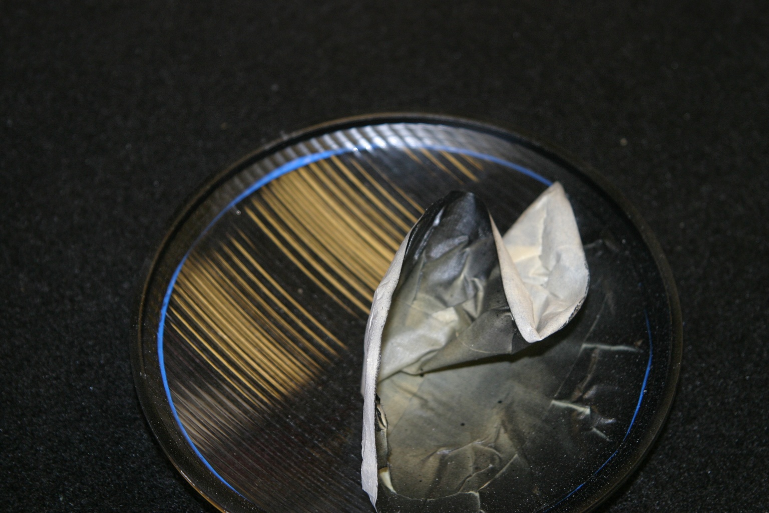

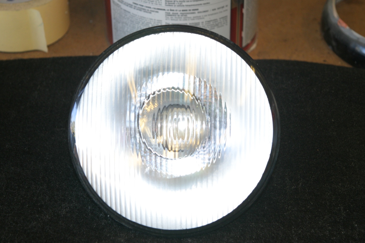

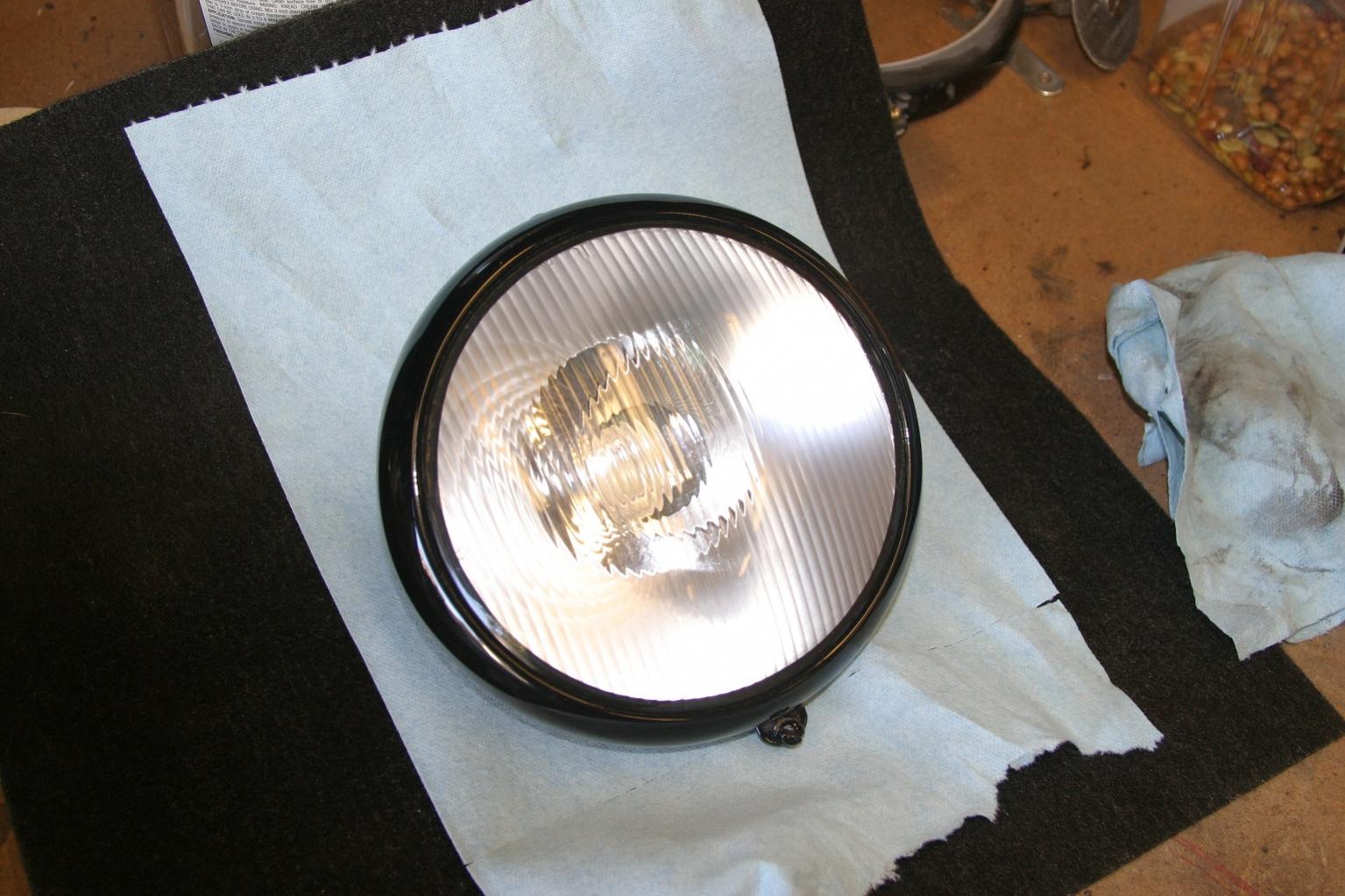

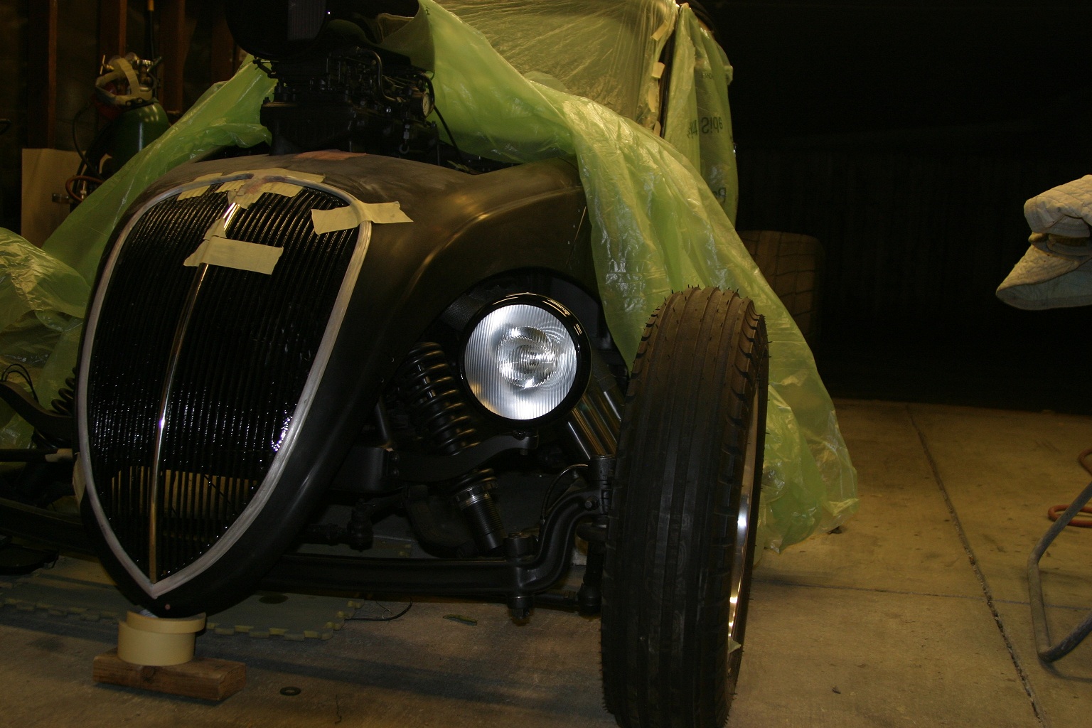

    time for an update.. if you look back at post #395 on page 20 the last picture is of the headlight ***embly I was planning.... here it is
    I bought an original set of used headlight lenses from Italy...
    pic #1 first I had to paint a small ring on the inside to cover the area where I was going to epoxy the original reflector into the back of the lens
    pic #2 I trimmed the original reflector to fit inside the lip of the lens, then I trimmed the back of the original reflector to accept the back end of a newer reflector which allows me to use a modern headlight bulb that simply twists into a socket and takes a plug on the end of the small bulb... then I epoxied the lens into the headlight bucket trim ring and it becomes almost like a headlight from the 70's i structure however I get the 1938 lens and the 2005 bulb set up.
    pic #3 just a better look against a light background
    pic #4 mounted
    pic #5 top view
