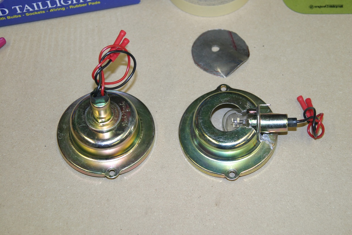

    some tail light pics
    I had to cut a pattern to locate the holes in the exact same place from side to side, more fun once you realize that the two sides of the car are actually a bit different out of the original molds.
    pic 1 I have remote battery terminals mounted on a rear frame rail and since it cramps the area for the tail light I had work to do.
    pic 2 I had to remove the bulb and socket and access it thru the side then weld a cover over the original hole
    pic 3 I bought these 1950"s style Pontiac beehive taillights which are really nice repops but the trim ring is just way to big for the area it needed to fit into so I did some redesign and headed to the machine shop
    pic 4 side view
    pic 5 with the body doing a bunch of different angles where the tail lights sit I had to work the bottoms of the trim rings to match the body arcs perfectly.... excuse the dirt... the trim sits on the panel with no gasket... regardless of the illusion the of dirt
    pic 6 both sides and the added bonus of the removable license plate holder...
    and no that's NOT a blur on the pic, that actually is a primered area on the paint...

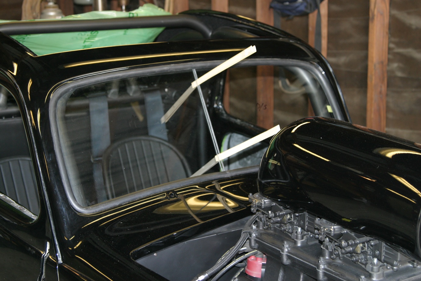

    windows windows windows
    started making templates and it is as much of a h***le as ever but as with everything else.... its just a thing
    pic 1 p***enger door with felt in place, I had to work the template so the same amount of felt was exposed beyond the body panel
    pic 2 inside shot with rubber, felt, and gl*** lock / handle
    pic 3 close up with door latch installed
    pic 4 I set the lock handle at a point that looked close to what I had seen in pictures, I don't have the trim that the locks slide in so I figured since I would be making them I didn't have to be exact on my hole height.
    pic 5 turns out the windshiel has to mount from the inside (have repop rubber) only problem? roll bar doesn't let that happen.
    If I go with lexan there would be an arc because the panel at the bottom of the gl*** has a arc in it from side to side, or, I could rework the entire panel but if I did that why not run gl*** and mount it from the outside without rubber?
    windshield gl*** is ,250 thick and the body panel on the car has a .125 lip for the rubber which means the gl*** would stick up (not using the rubber) so I would have to do bodywork olong the entire winshield area.... NOT interested
    hmmm split window
    made templates and installed the gl*** and it actually looks better as a split window, more time period correct as odd as that is.
    I designed a center piece of moulding that holds everything and has a interior side plate which screws go thru to pinch the windows together.
    The center trim has the same design as the hood ornament...

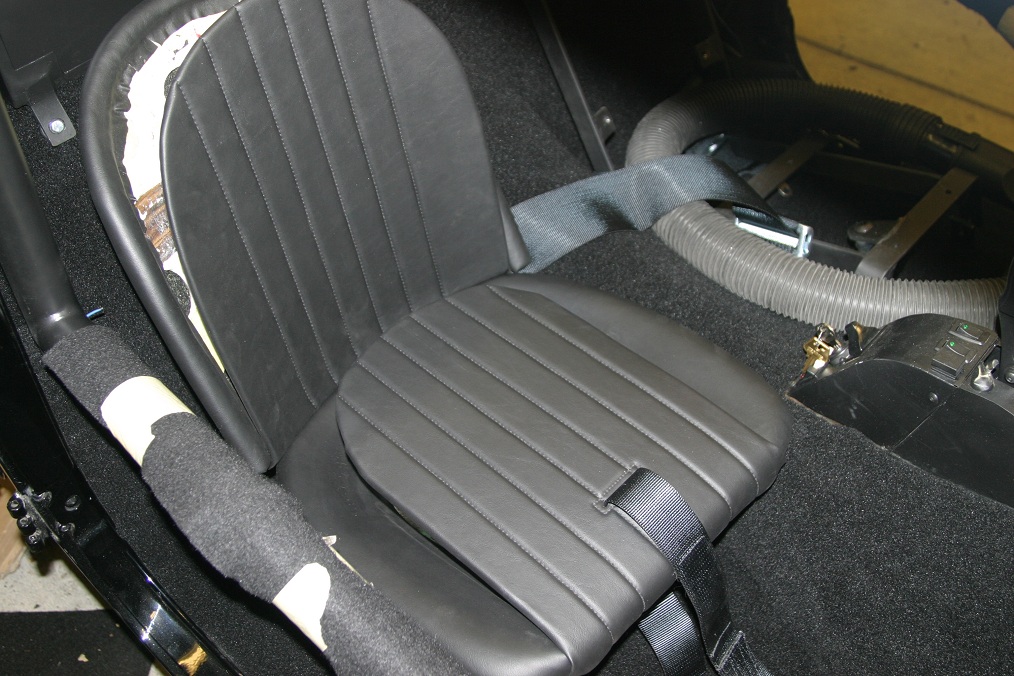

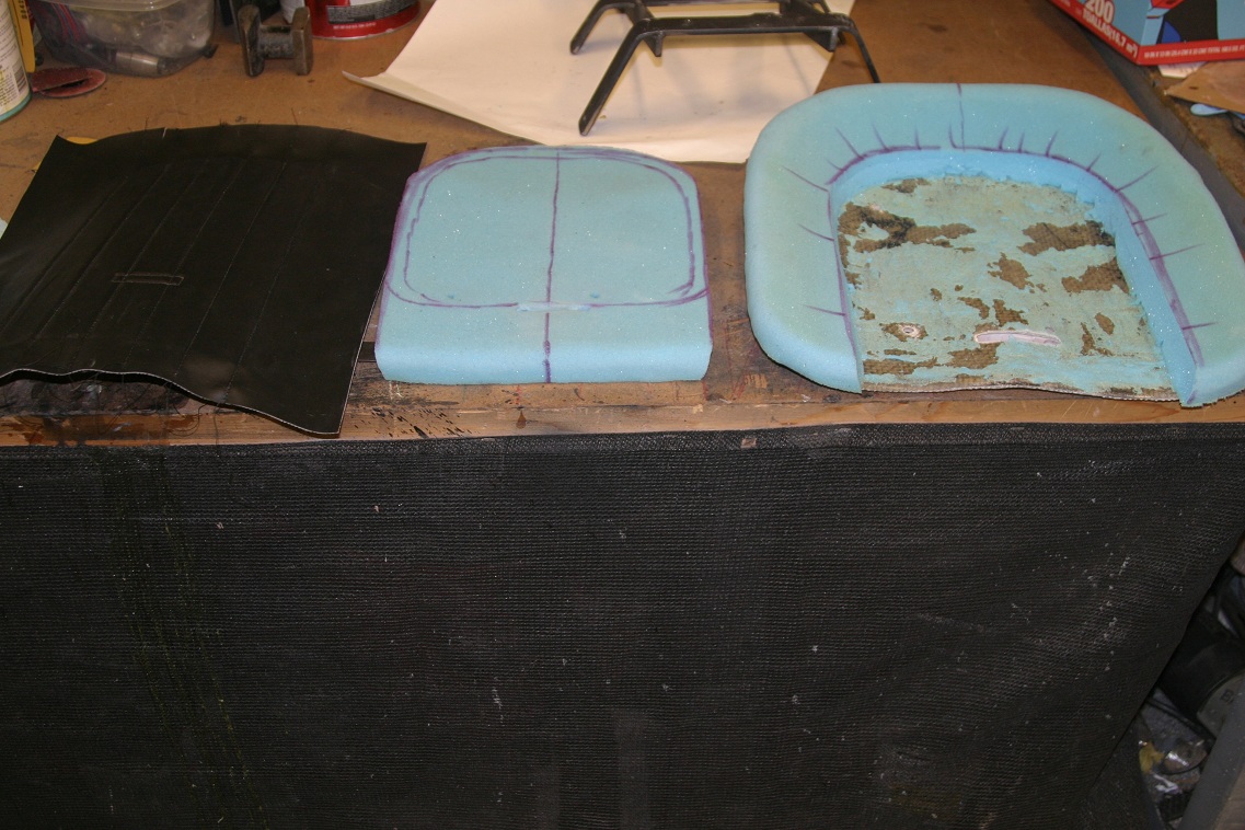

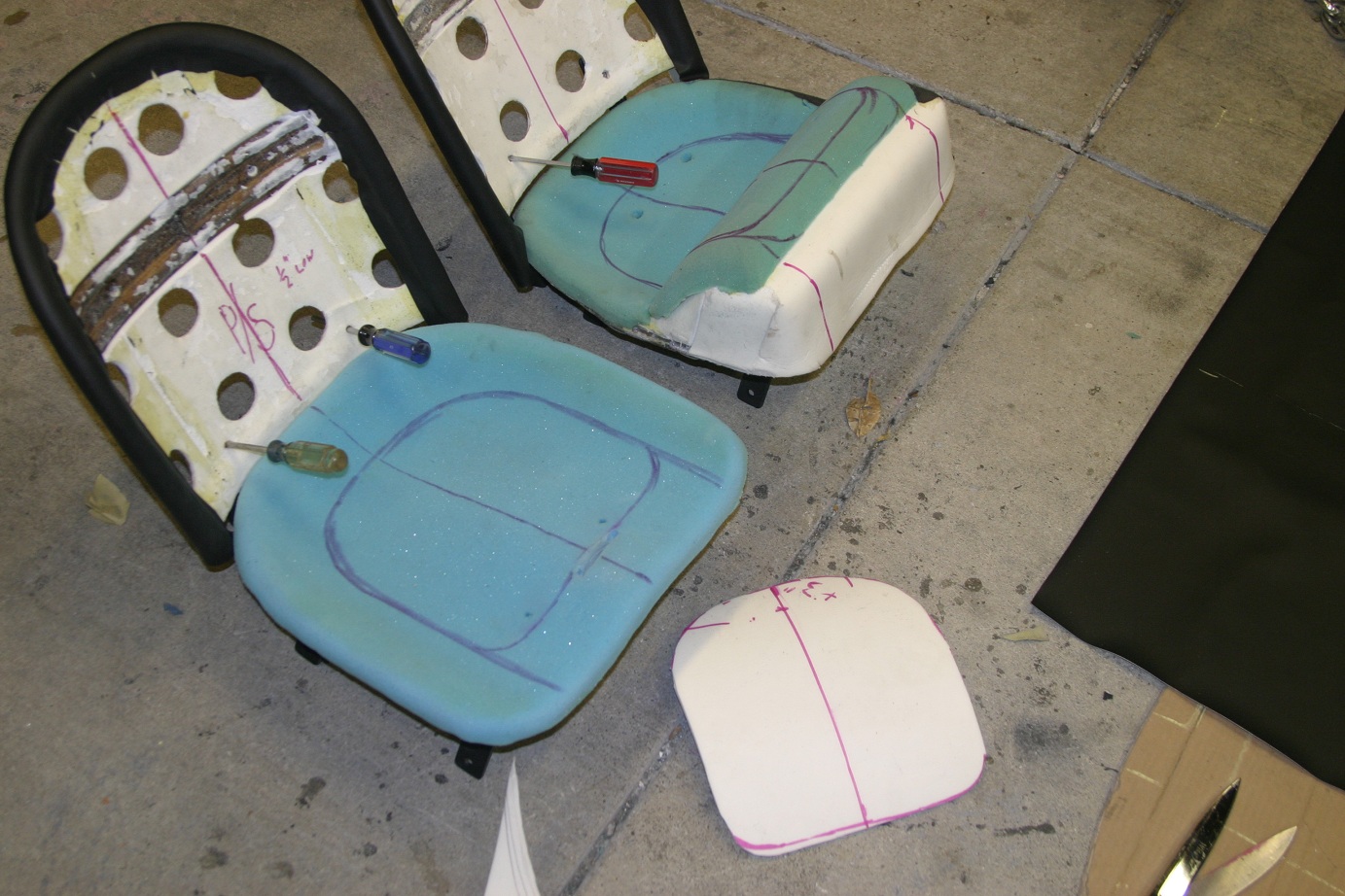

    some more seat stuff
    pic 1 on the left is what came with all the parts, on the right is the first level of change, I made a seat bottom and removed 6" out of the center of the seat back
    pic 2 I carved a seat from foam then fibergl***ed it and used it as a mold, then I pulled a part of out of that and took the part to a 3-d scanner and had it corrected from side to side then sent that file to a cnc foam cutter and got this large block of foam that I sanded and gl***ed and prepped to pull parts from
    pic 3 a seat bottom in the mold (the mold was actually made for another project of mine but I thought the seat design would work well with the minimalistic theme I was building this car by)
    pic 4 even after removing 6" from the center I then chopped off the "wrap around" parts of the seat backs and then added in steel rods around the edge and arcoss the back side for added strength
    pic 5 seat frame
    pic 6 I had some sound barrier remaining from a project I built for someone else... this material was used in black hawk helicopters ...
  12. Zoomer
    Joined: May 15, 2009
    Posts: 222
    Zoomer
    and more
    pic 1 thin foam applied over the sound barrier
    pic 2 seat upper with thin foam and edge wrapped with material
    pic 3 I built inserts with interior board, then glued foam to that, then material, then
    s***ched the pattern
    pic 4 aforementioned s***ches
    pic 5 the seat bottom.. I glued a thick blue foam then cut out the "insert" area, next to it you can see the material s***ched to a thin foam
    pic 6 both seats
    pic 7 seat bottom without insert getting wrapped

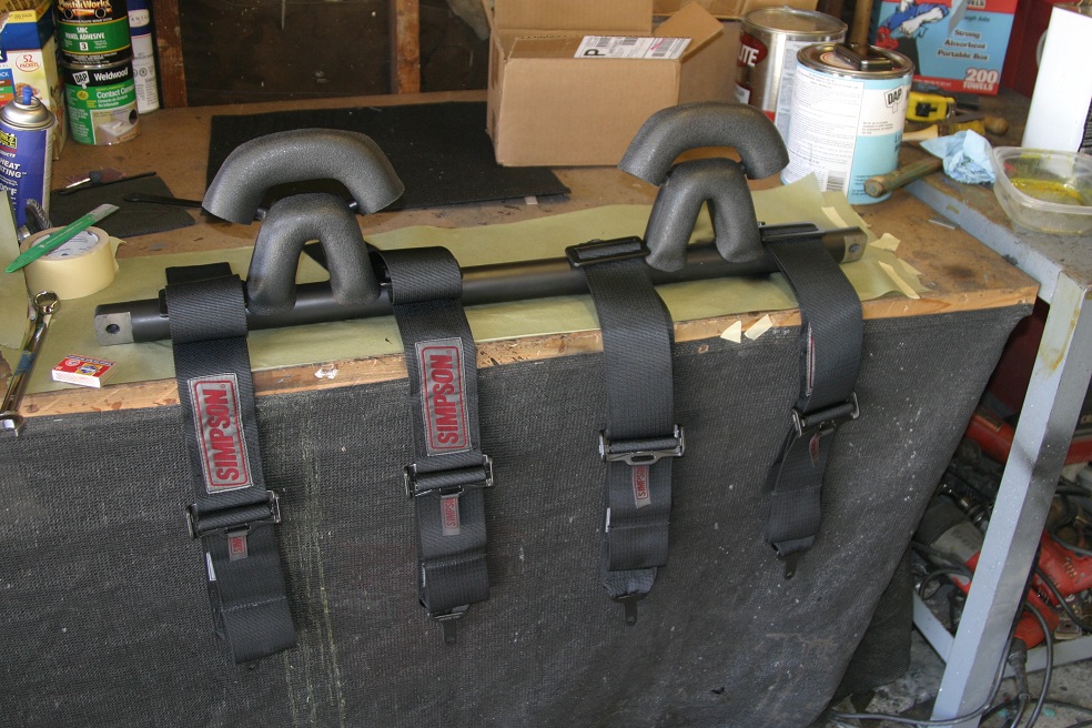

  13. Zoomer
    Posts: 222
    Zoomer
    yes yes more
    pic 1 uhhh yeah (delete)
    pic 2 this shows how the inserts pull out. the upper is wrapped under around to the back and then the back is carpeted, the bottom is wrapped under the front and the bottom is carpeted...
    having the inserts pull out like this alows me to hide the screws that hold the hard seat parts to the frame
    pic 3 p***enger seat finished, just need to adjust and trim harness lengths
    pic 4 I had to "adjust" the bright white of the simpson labels
    pic 5 head rest bar completed
    pic 6 dome lights : ) I have them on both side bars and under the dash on the p***enger side and they really light it up
    pic 7 this shows the first pad idea I was going with... never got it to work and never liked
    the look... always for a reason
    the only thing I had my interior guy do was run the straight s***ches in the seat pads, the steering wheel, and the door panels (which I don't have pics for as yet)
    I'm still not a fan of doing interior work

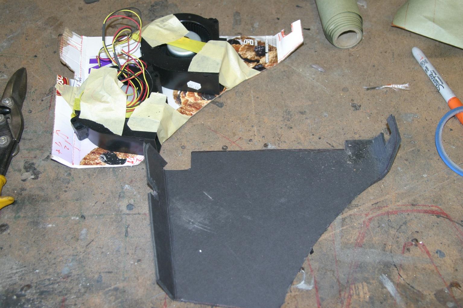

    the body panels near the headers are catching a bit of heat and I really don't want that to be an issue since I am now block sanding the car for another repaint.. sooooo I built some panels that hold little fans that blow right on the headers. They are on a switch in the center console that has power on both sides of the ignition switch... power and accessory.
    The electric water pump runs on power and accessory as well and the radiator fans have an override that also can be powered on accessory. This way I can shut the car off and run the radiator fans, water pump and header fans for 5 minutes and take the temp down from 175 to 100 in less than 5 minutes.
    pic 1 is the template with the fans taped for fit
    pic 2 is the fans mounted on sheet metal
    pic 3 is the panel mounted in place.. this is the pasenger side... firewall to the right side, valve cover to the left side, the bar above is the engine roll cage bar... I used the bolt that connects the engine cage to the rest of the cage for the top mount and the lower body to frame mount bolt for the lower mount.
    pic 4 is the same as pic 3 but farther back view, the distributor cap is at the bottom of the pic...
    bought high heat sheeting good for 2000 degrees to put on the inside of the panels and to cover the fans and the mounting plates, currently covered with aluminum foil for a few days.
    started block sanding the car today, figure I'll be done by the weekend and hopefully get it into the booth a couple of days next week. blinker arms and boxes are getting machined currently, ordered door mirrors today.
    ordered larger accelerator pump aquirters today along with a secondary balancing tube so the carbs reacts at exactly the same time. did some carb tuning snday in the garage and its much better, the squirter change ought to clear everything up that is left.

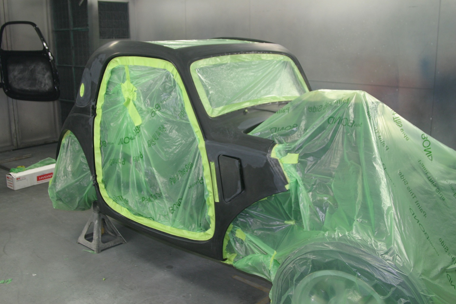

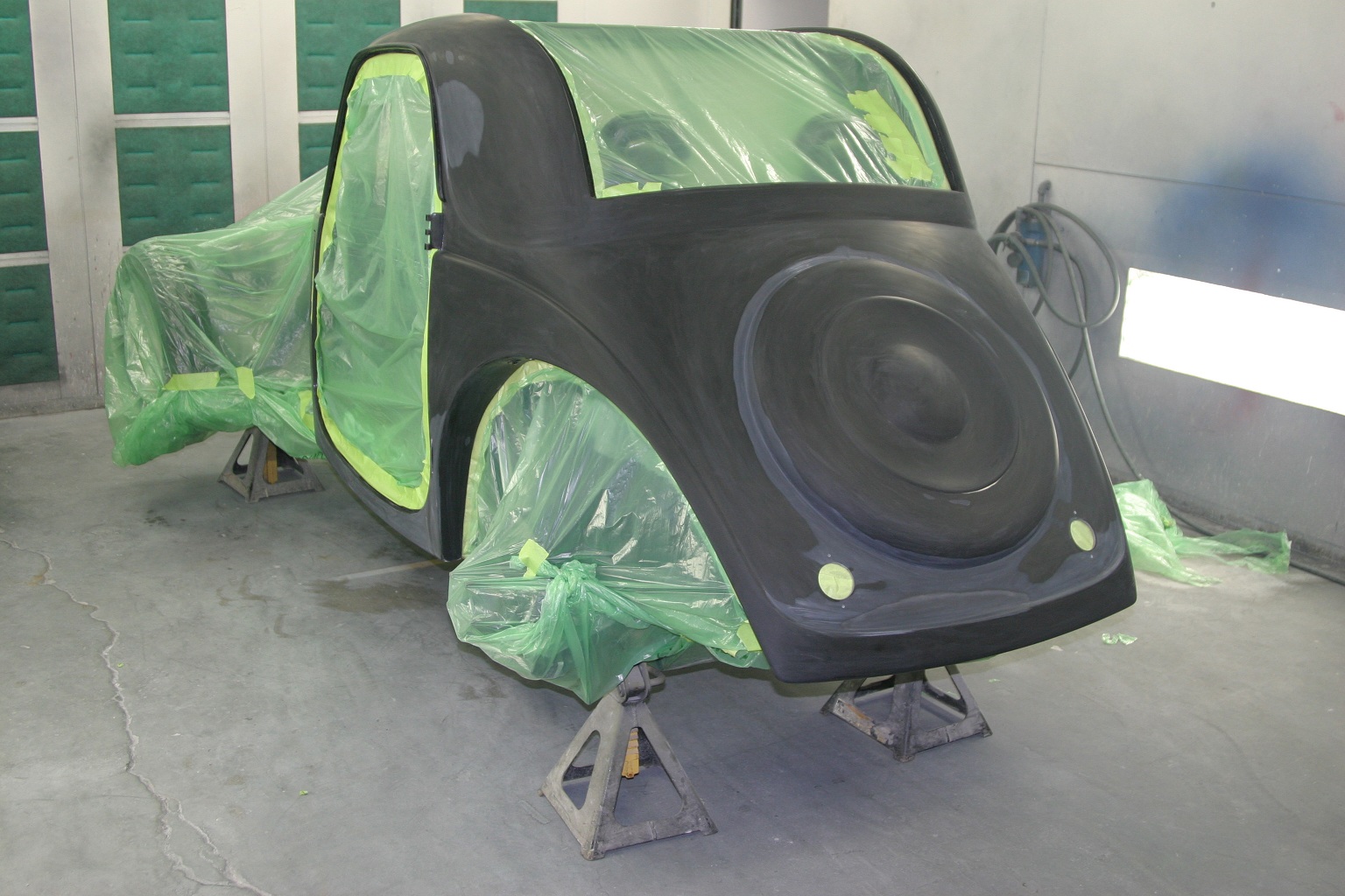

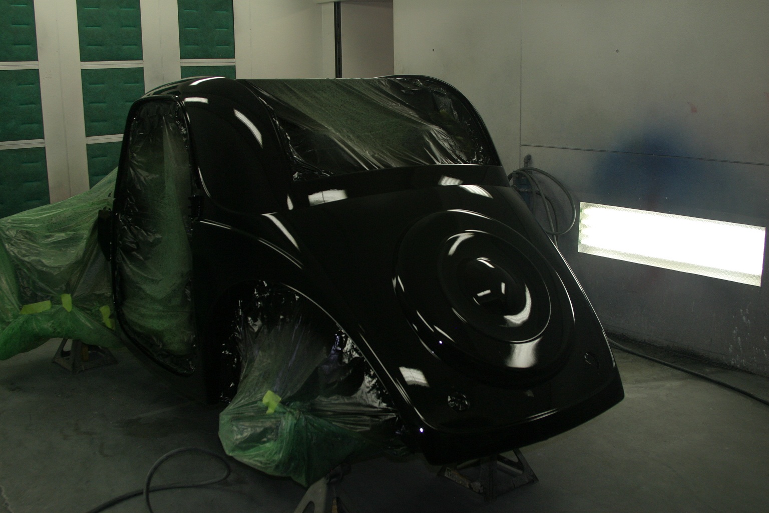

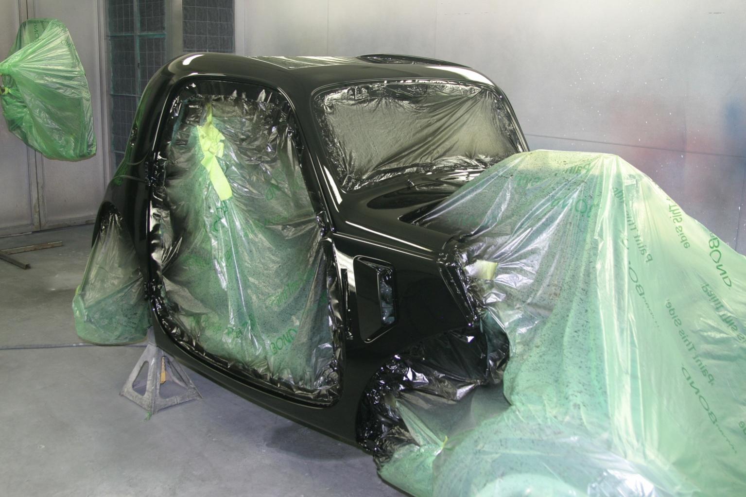

    I have always believed that once a car is being driven the work on it stops.... thus I always completely finish a project before I start cruising it.... does that qualify block sanding it to repaint it? again!
    the areas around the vent doors got wavy when we set the body because I turned a suspension nut/bolt around and blah blah blah... that plus adding in the gas door... regapping the door fitment a wee bit, and a small dent on the tail section and one on the cowl section made it seem like a reasonable course of action.
    still looking to have it finished this month... where have I heard that before?
    I'll get it in the booth next week, pull the wheels, doors, nose, scoop and start one of those 100% emmaculant masking jobs.... gotta love a challenge (actually it won't be difficult or complicated at all, time consuming yes but thats all)
    buying a decibel meter tomorrow to determine where the headers really are and if I need to make some.... adjustments : )

    Zoomer
    painted this week. the doors and nose, interior window trim, gas door, hood ornament, and grille trim was painted thursday.. I flatbeded the rod to the booth fri and shot it today.
    pic #1 is wrapped up in the booth. I layed plastic on the ground then slide the floor jack under it to lift it then set the stands under it so I could wrap it from the back to the front underneath and then up and over the engine to the cowl panel.
    pic #2 another angle
    pic #3 painted.... AGAIN!
    pic #4 another angle this time I shot with about 5# of air pressure to get maximum material on the body with little in the air and little to move the plastic around. acrylic enamel is not a fan of low pressure as it needs higher pressure to get a high shine and really smooth flow out. lower pressure gets you more orange peel and less shine but lots of material and since its getting colrsanded and polished the degree of shine at this point doesn't matter to me.
    pic# 5 is the hood ornament and the gas door ornament

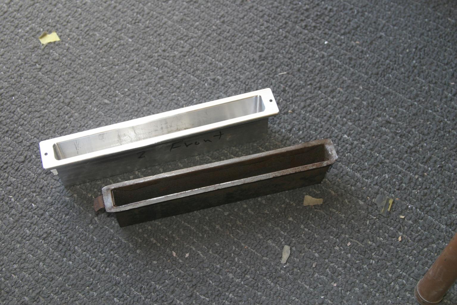

    pic #6 is the new and old blinker box.. (1 side) the steel ones were so beat up and the blinker arms were broken so I redesigned the arms and then the boxes to work with the changed arms.

    Wow, what can I say. It looks great and the new blinker boxes are very impressive. I have the same directionals for my Fiat but they are pretty rough also. I also never noticed the design of your gas cap, nice touch. wanted to ask you how come you chose to use acrylic enamel and not base clear? no offense to you about it I was just curious. I sprayed alot of enamel over the years with good results after a wet sand and polish.
    Let us know when you get it back together again.
