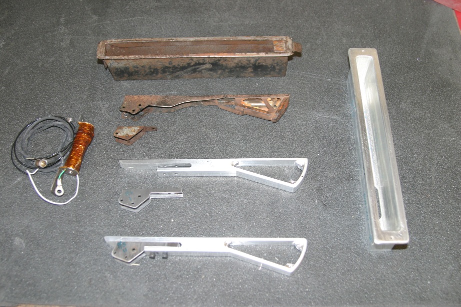

    just a few things to post...
    pic #1 one of the perks of being single... setting parts where ever you
    want
    pic #2 I pulled the header fans out when I painted the car and also to wrap them with a high temp reflective shielding, also put the shielding on the inside of the body panel around the vent doors

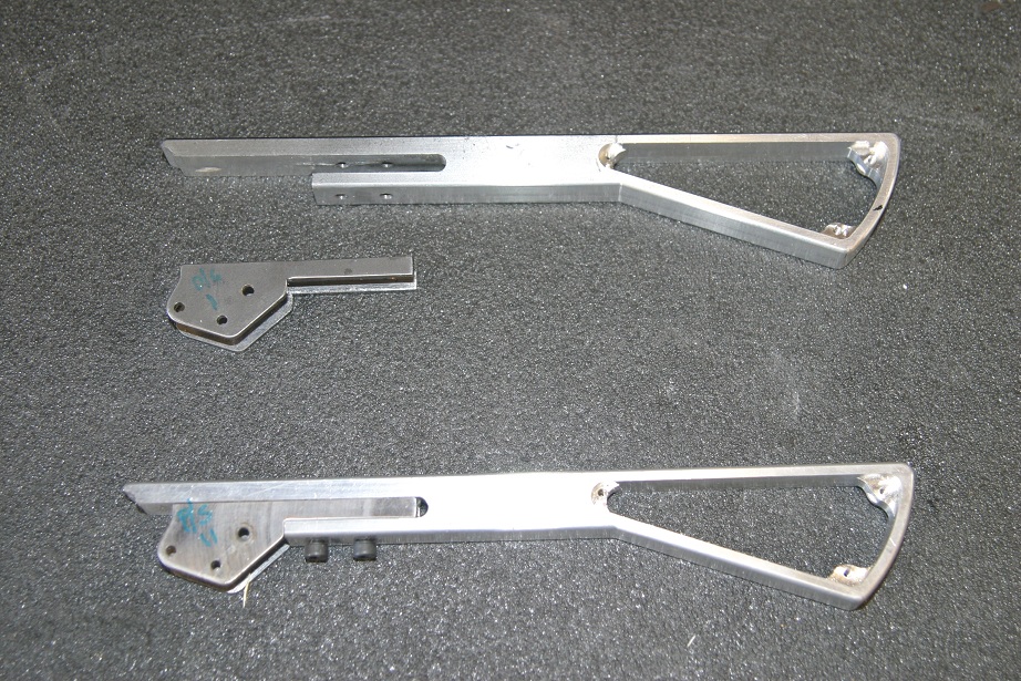

    pic #3 I've posted the new blinker boxes before, here's the rest of it. The old arms were steel that was folded and had a steel pivot arm inset...
    I decided to make the steel pivot a bit different and the arms out of aluminum and longer to fill in the box opening. (you can see the tab cover on the right end of the old box that covers 1/2" of the opening) The wires run internally and will power l.e.d. lights behind orange forward lenses and red rearward lenses. the pull soleniod was rebuilt and rewrapped for 12 volt... I guessed I would be into this little adventure for $1000 when it was all done... I was $15 off.
    pic #4 close up
    pic #5 just shiney stuff
    pic #6 more shiney stuff
    having the window lock rails machined currently... going to paint the window rails, blinker parts, door handles, and windows locks this weekend.
