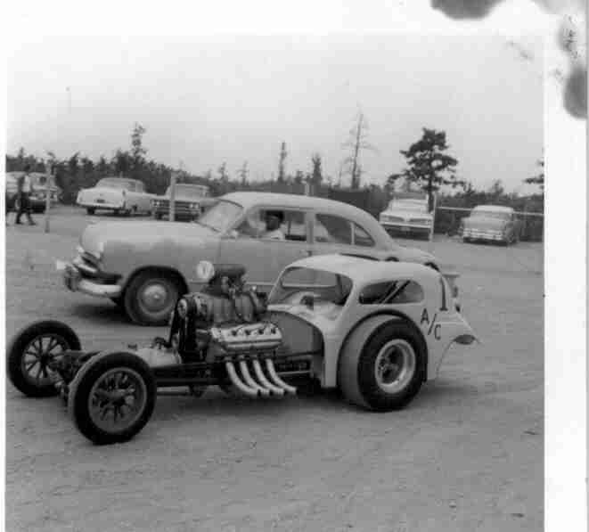

  2. Found a few more shots in another file...these are mostly early 60's

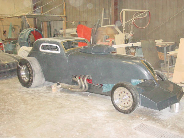

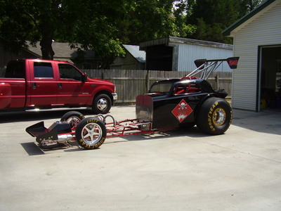

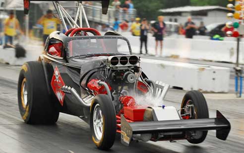

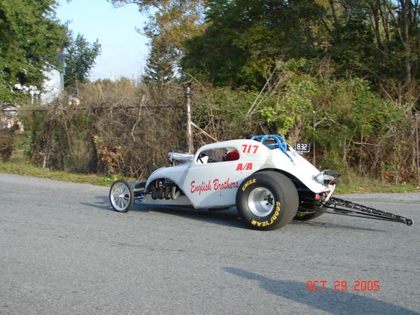

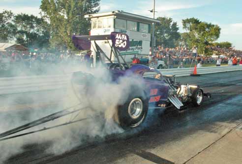

  5. Your daily dose of Italian excitement........
    The car on the salt is in Australia
    The woody is custom modified on a coupe shell
    The fuel altered belonged to one of the crew on the UPS flopper
    The last 2 are the body we did for the re-creation of Flamin Frank Pedregon comp coupe
    built by the late Pat Foster

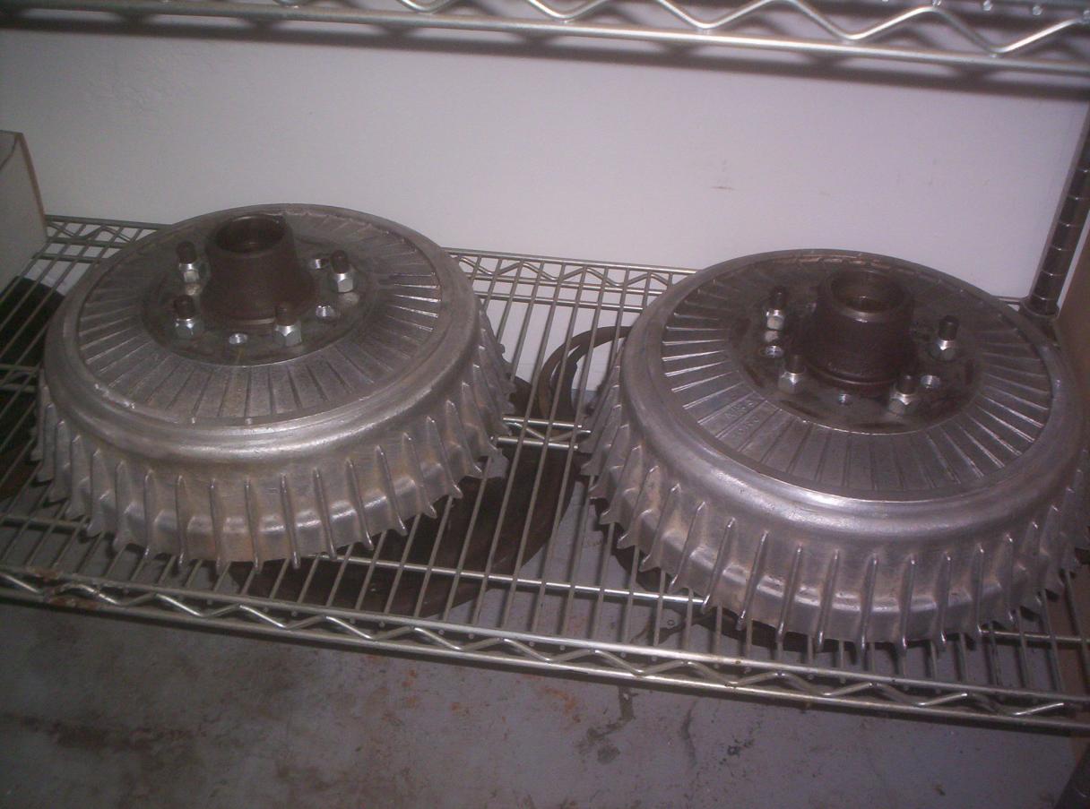

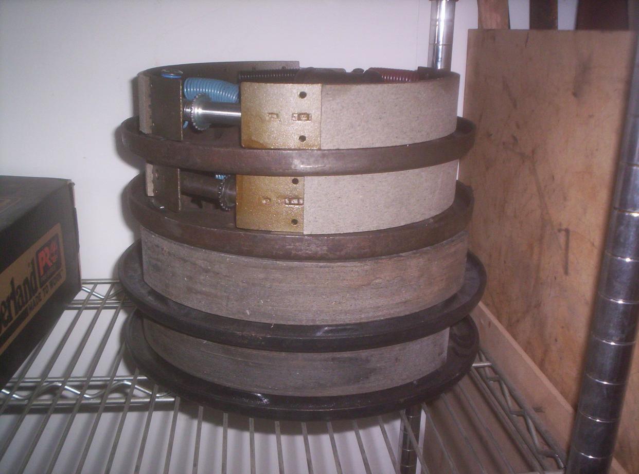

    I found the early Ford 12" backing plates and rebuilt them with self energizing brakes for the Buick drums. The drums are re-drilled for my front wheels.
    The rear 11" brakes for the 9" are also rebuilt and ready to go.

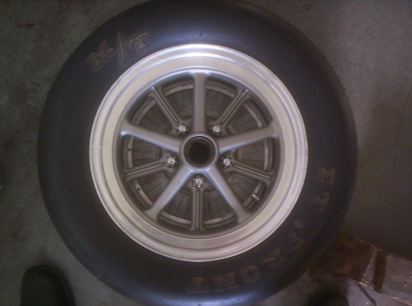

    Also scored a 31 spline trac-loc and some 31 spline axles.
    I have a 4" dropped axle and wishbones with spindles also ready to go.
    Scored some disks to hide the ugly rear wheels.

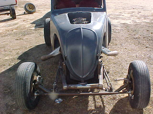

    Started on the frame. In and out of the car to make adjustments but not welded up yet, just tacked. Something tells me that I will be making more changes before its done. I tapered the front rails next to the motor just for looks. I put a cool Speedway sticker on it so everybody would know its made in China and its ****, I mean, the ****.

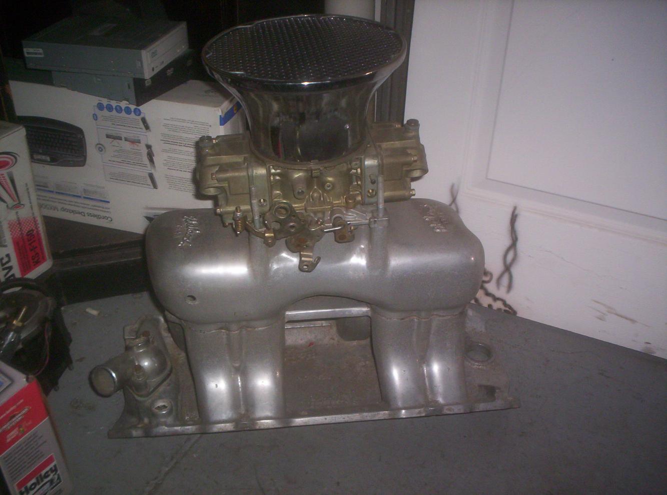

    Also got this old funky hi-rise intake. I have to use this because I dont have blower and something needs to stick up through the hood to obstruct my view, doesnt it?
    I tried my hand at shaping sheet metal for the rockers and it worked out great.
    You can also see my plan to put the radiator in the back. That should be fun.
