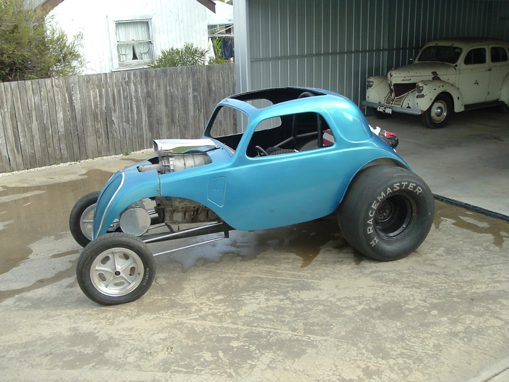

    The Blue topo (bottom left) is an Aussie car. Has plenty of race history and was made famous by Mark Georgette. These days it's owned by a guy in the country town I grew up in.
    He also owns this (a**** other things)
