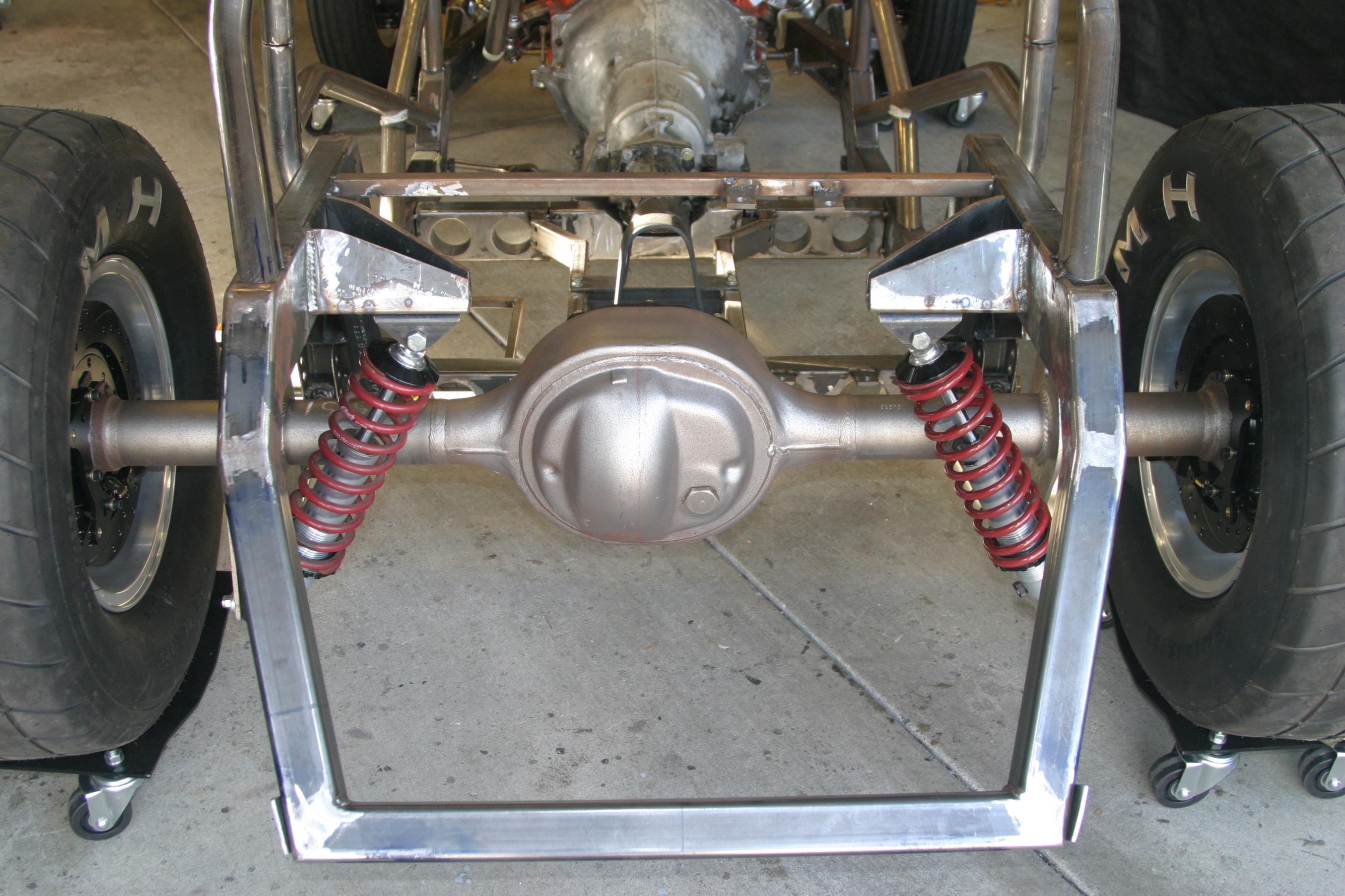

    The rear end went to Currie yesterday.... 4.11 detroit locker posi new tubes bearings seals narrowed 5" new axles 3" studs blah blah blah I'll tell the story of the salesman once I have the rear end back in my hands next week.

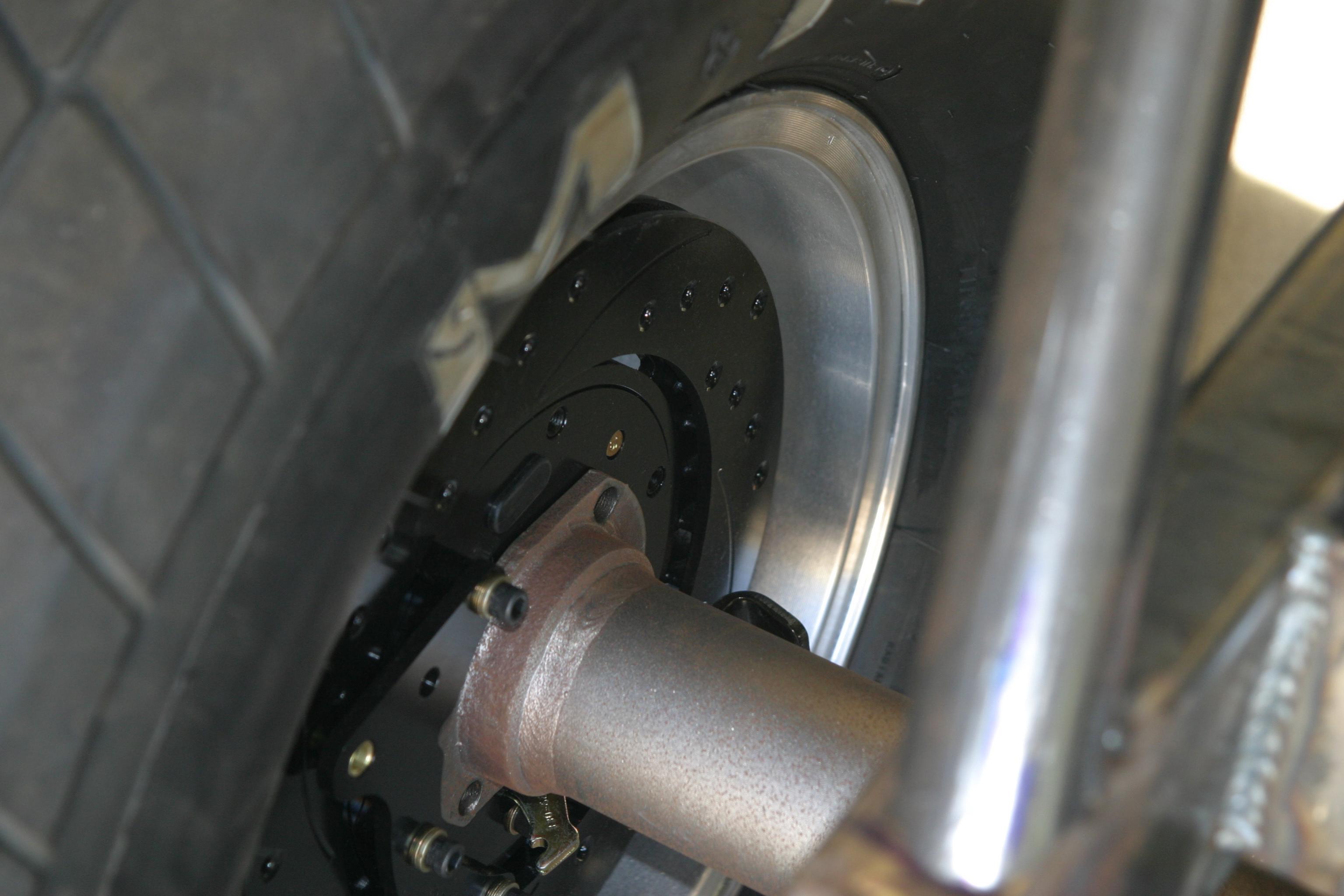

    I got the rear end back last week, SAAAAA WEEEETTTTT and . now I just ordered disc brakes for the rear. I was content with drums in the back as they actually work really well with much more surface contact etc, however I had to be honest with myself and with what runs thru my head every time I see a little hot rod that has DRUMS in the rear, ugh why did you stop there? "hello, Wilwood?" another $886 peeled off the money tree. A honest look is having the steering finished this week and the exhaust, if I can get the pan hard rods built great if not then that's my weekend project.

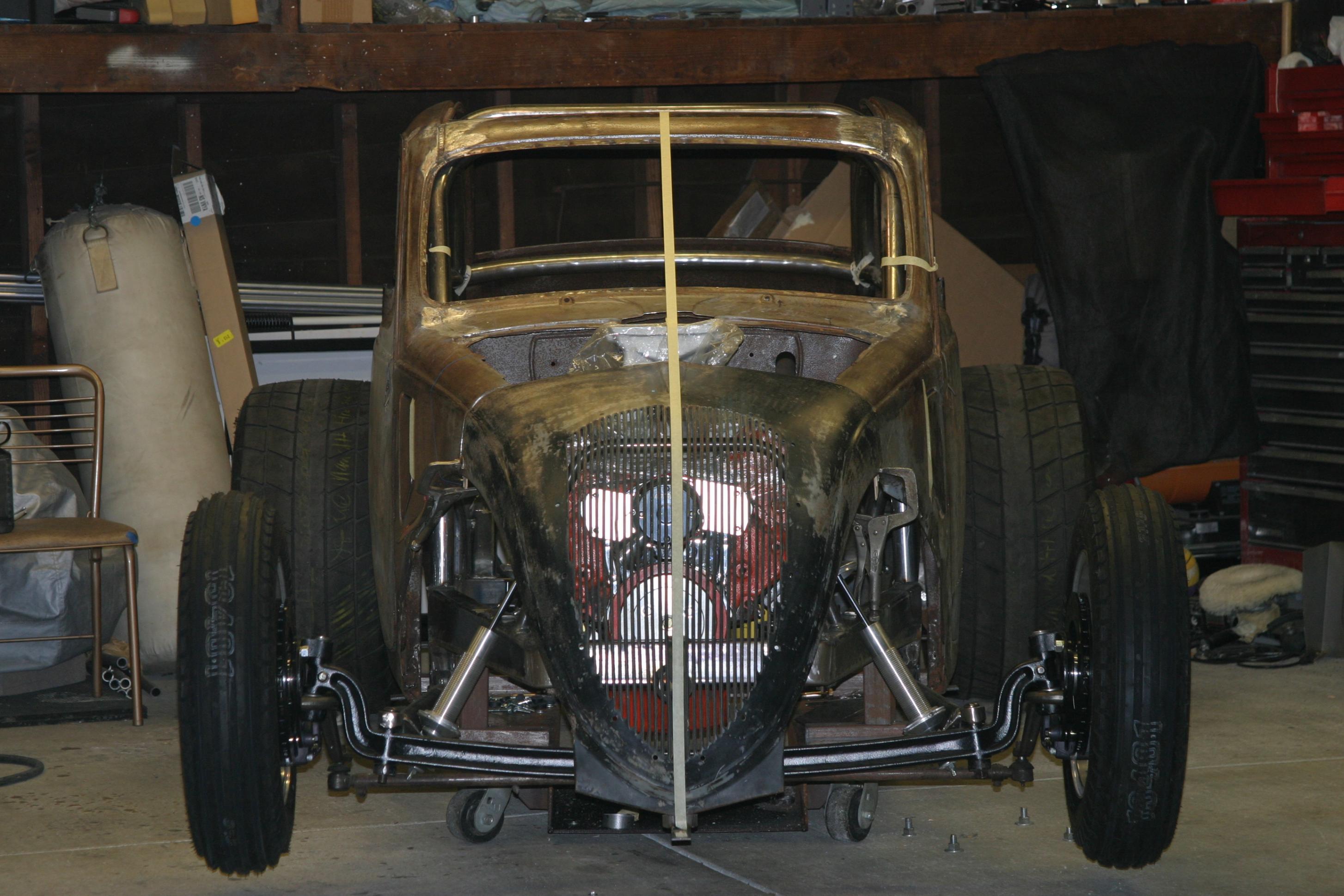

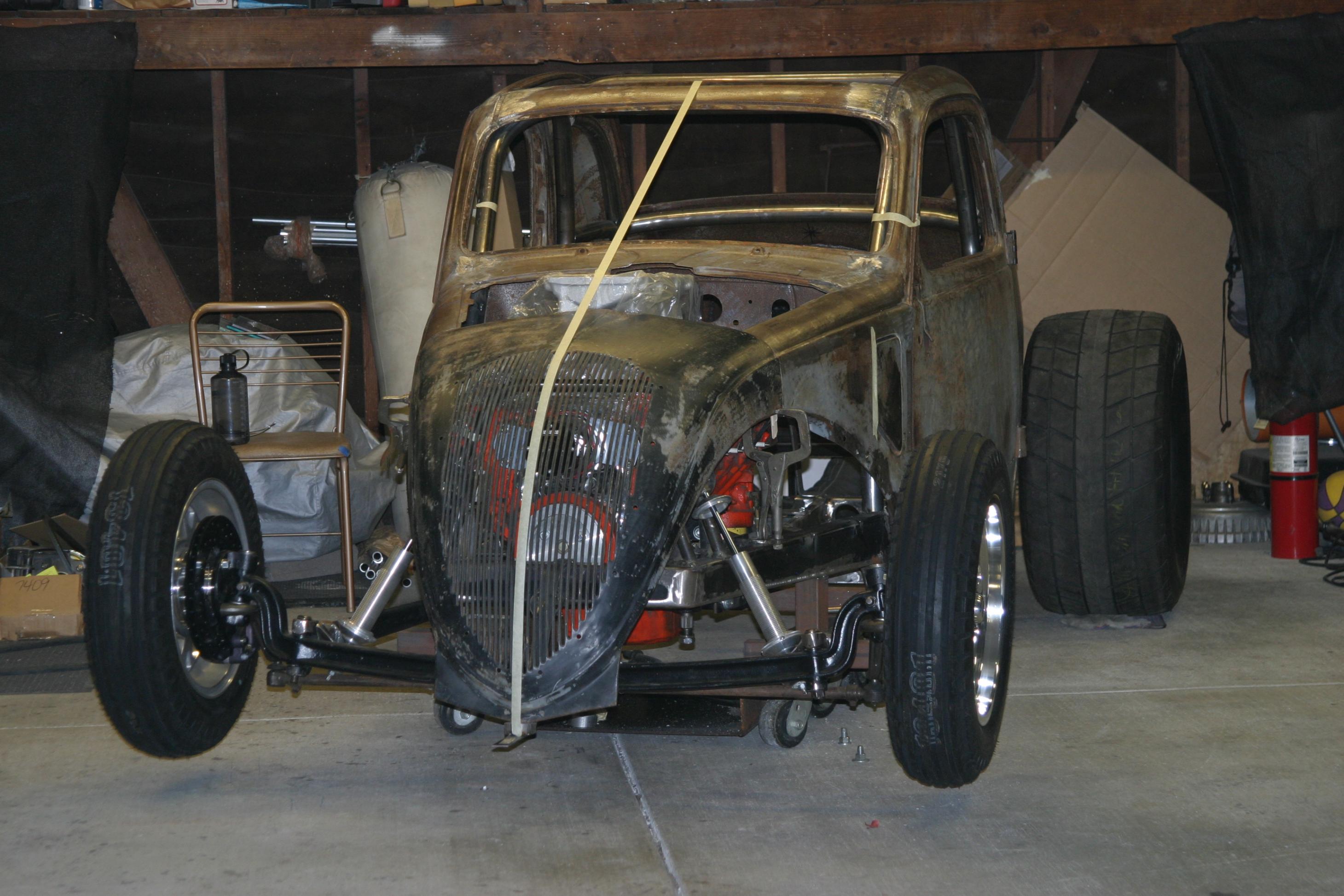

    body squared on frame, 10 body to frame mounts built, body now hanging from rafters.

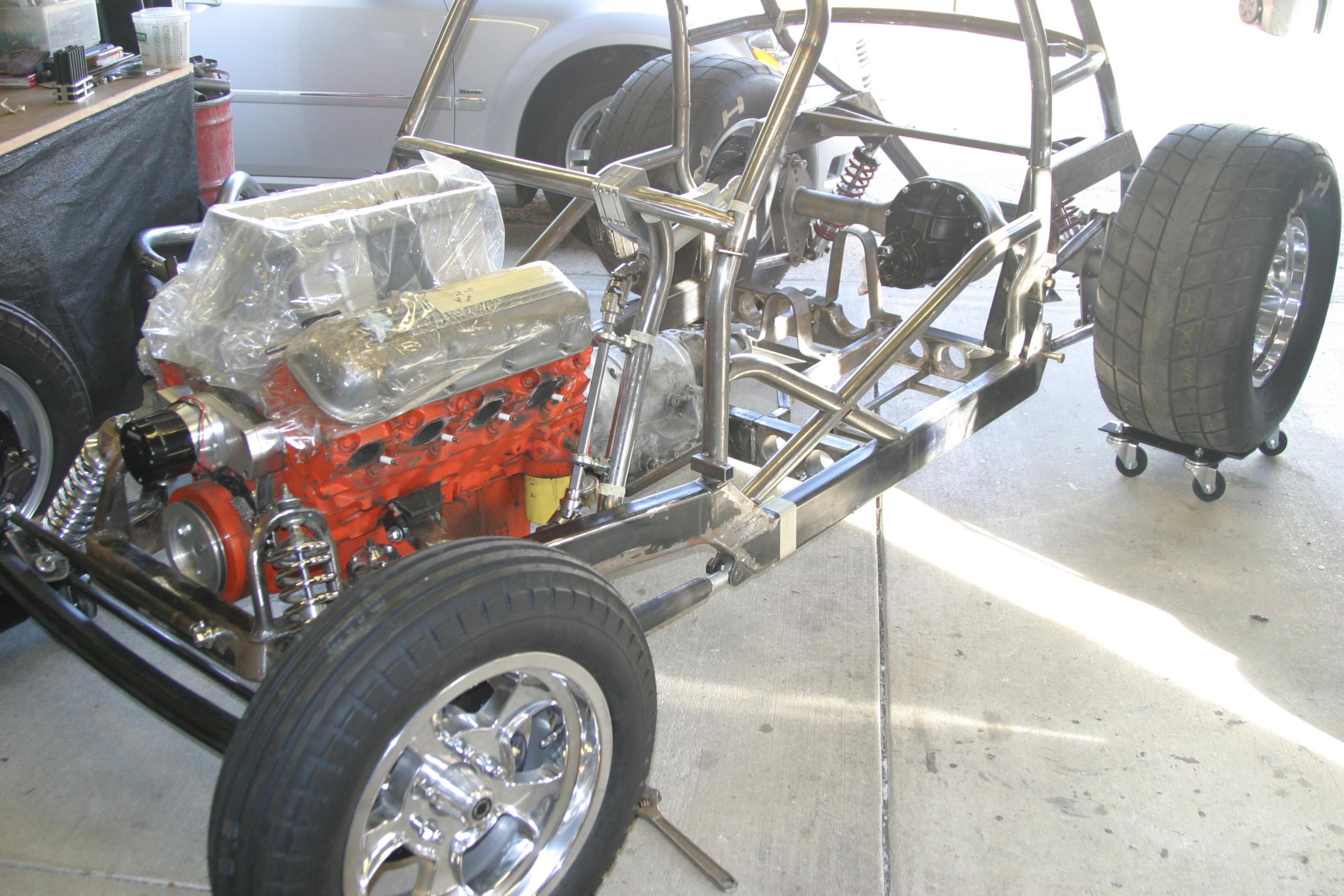

    front pan hard rod completed, front steering bar completed, front tie rod ends and bar completed (all machined bars and connection point) steering column support completed and installed, alternator brackets 50% completed. working this weekend to finish steering linkage from column to gearbox.
    next week; alternator, rear end, rear lower shock mounts, have driveshaft built, have fuel cell welded together.

    Here's a few pics... a 3/4 front shot of the frame with the body lifted. you can see the steering column and shaft in place (more pics to follow) and a rear view pic with the narrowed 9" in place, and.... the caliper is not mounted but I put wilwood disks on the rear.
