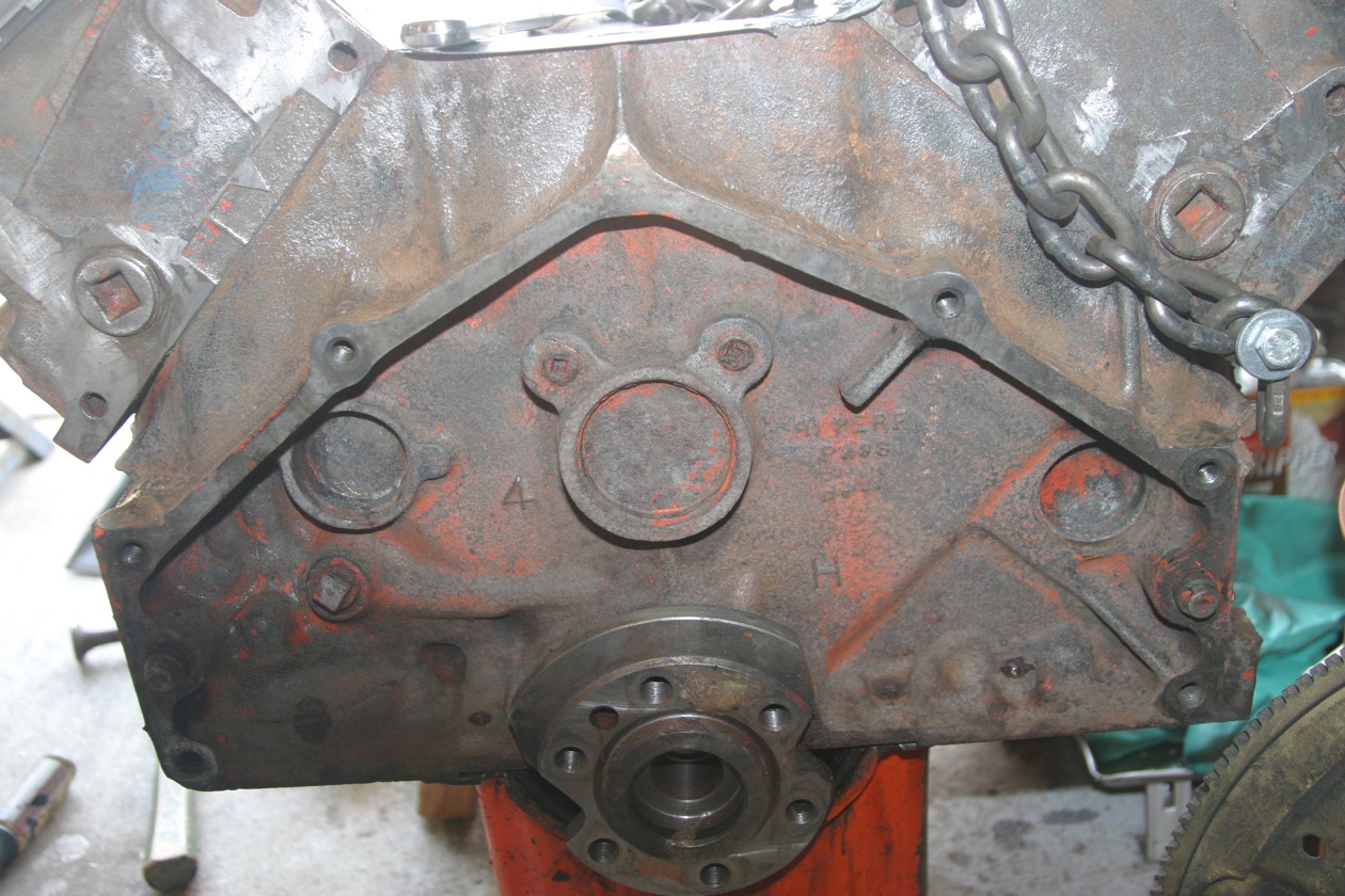

    pic #1 shows the original steel rear cam plug... all the freeze plugs on the sides of the block were pounded into place with a socket extension (almost dented clear thru the freeze plugs) I had the block dipped and ALL the plugs removed and replaced (even the tiny 3/16" ones)

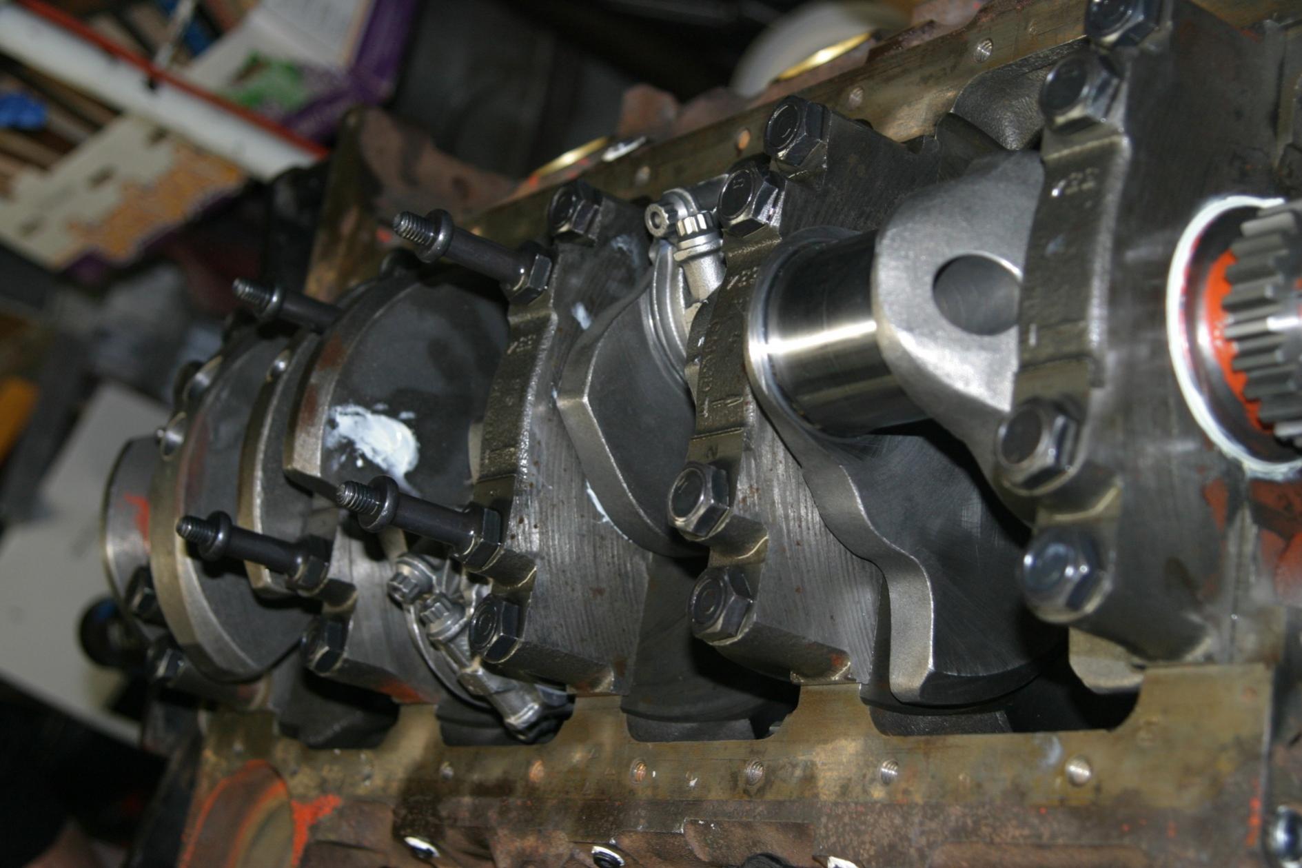

    During ***embly we also blueprinted the engine so we knew exactly how everything was fitting together.

    more pics for the last post..
    note the 4 bolt mains

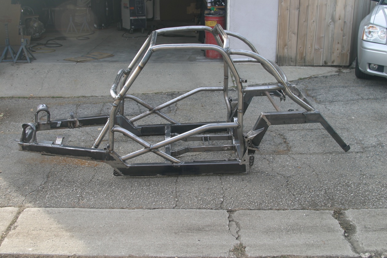

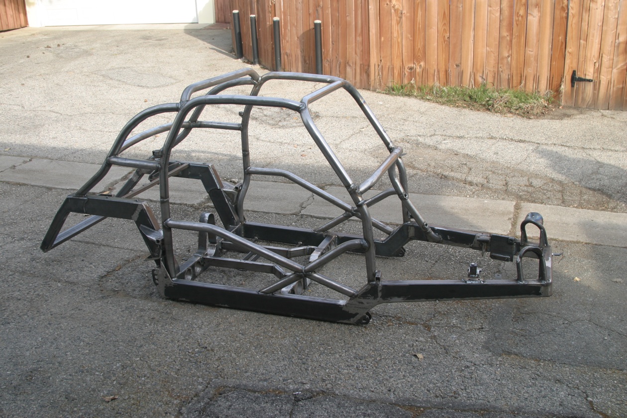

    and then there was the final welding of the frame.... after I had built the roll cage and changed a few things to the lower rails and had heavily tacked everything together making sure it all remained square I pulled my bro in for a day of welding as he is a certified frame welder.

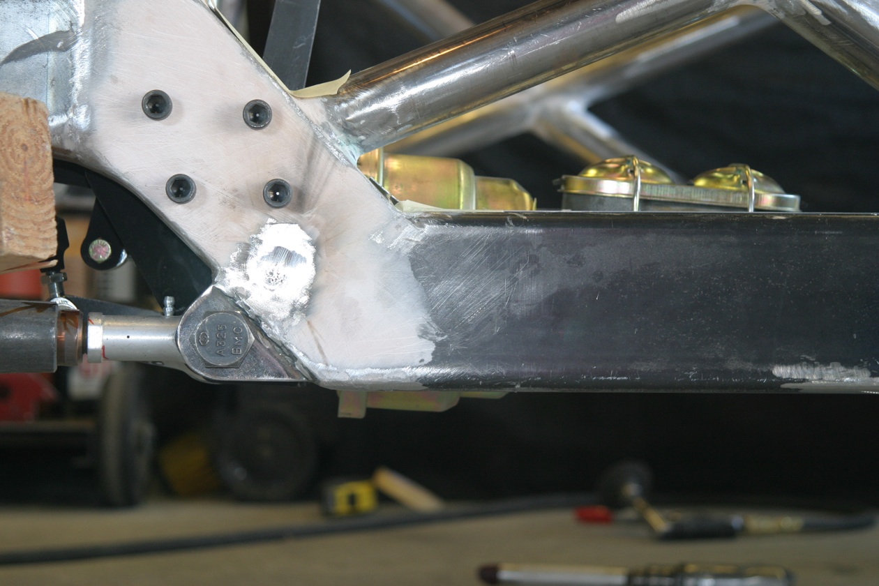

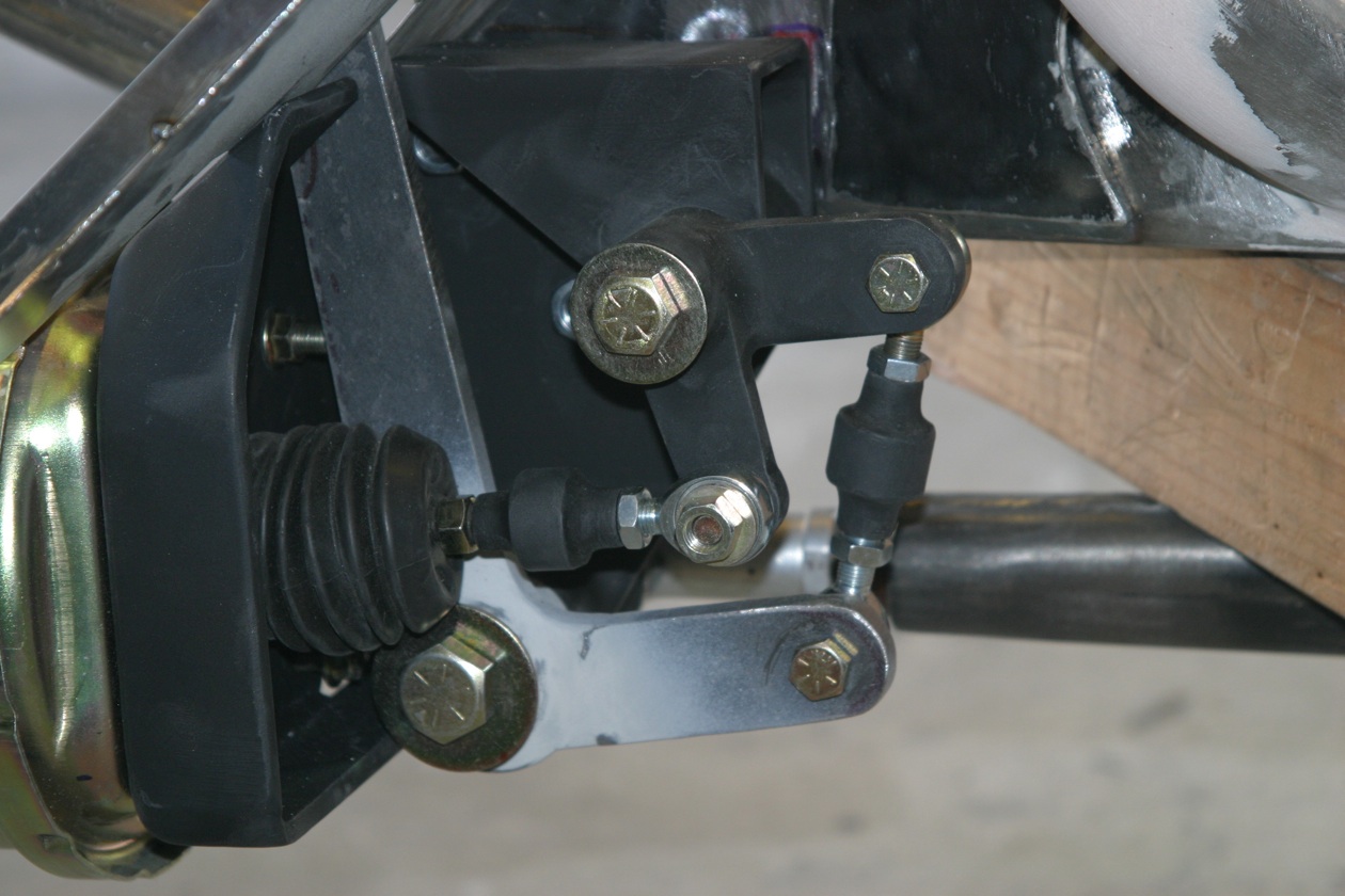

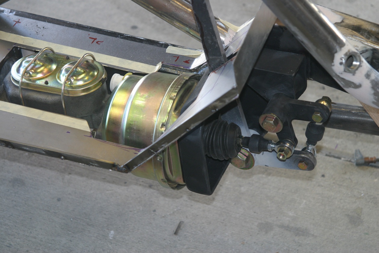

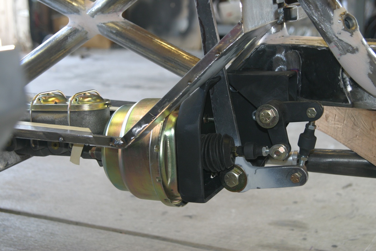

    lets talk brakes....
    pic #1 shows the booster master cylinder from outside the frame rail. this pic shows how little is hanging below the frame itself, I did bring it up into the floor to accomplish this however I'm happy with the balance of above and below.. not to mention I hate seeing boosters hanging down below a car... the four sockethead cap screws run thru the frame into the mount I built.
    pic #2 is a side view from inside the car with the trans tunnel (and trans) not installed. the floor panel IS inplace giving the "above and below" the floor view
    pic #3 is more of #2 from a diff angle
    pic #4 is the linkage I had to built... now here's what had to happen
    there are 5 bolts in this picture, two across the top, one in the middle, and two across the bottom... the main brake arm used to mount on the upper left side bolt, the problem was I needed a long arm for leverage but at that mounting point the brake pedal would have hit the dash... sooo I built a new arm lever that looks like an "L"... then built a lower pivot point which allows a long throw with a brake pedal at the right height in the car... the original pivot point has another small "L" pivot arm. when I press on the brake pedal the lower leg of the "L" moves down, which "pulls" the smaller "L" which "pushes" the the rod into the booster.
    I bought a booster master mount / pedal ***embly for a mid 50's Ford PU and then rebuilt it 3 times : ) the only remaining part is the flat plate that the booster actually bolts to.
    have to throw up one more pic at some point, the lower left bolt and the upper left bolt are now both speed wired to the booster mount frame... didn't want to allow for any movement.
