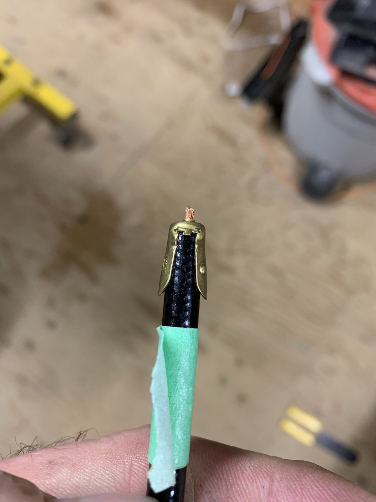

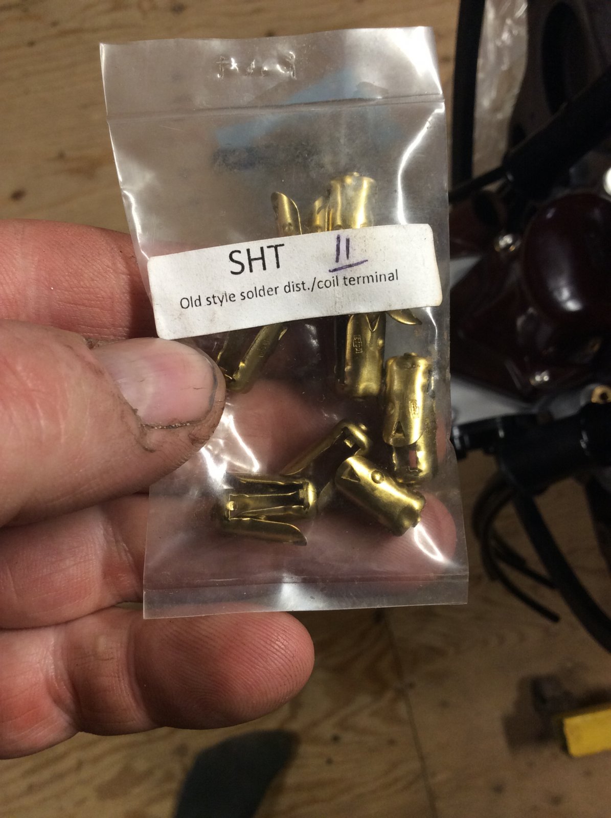

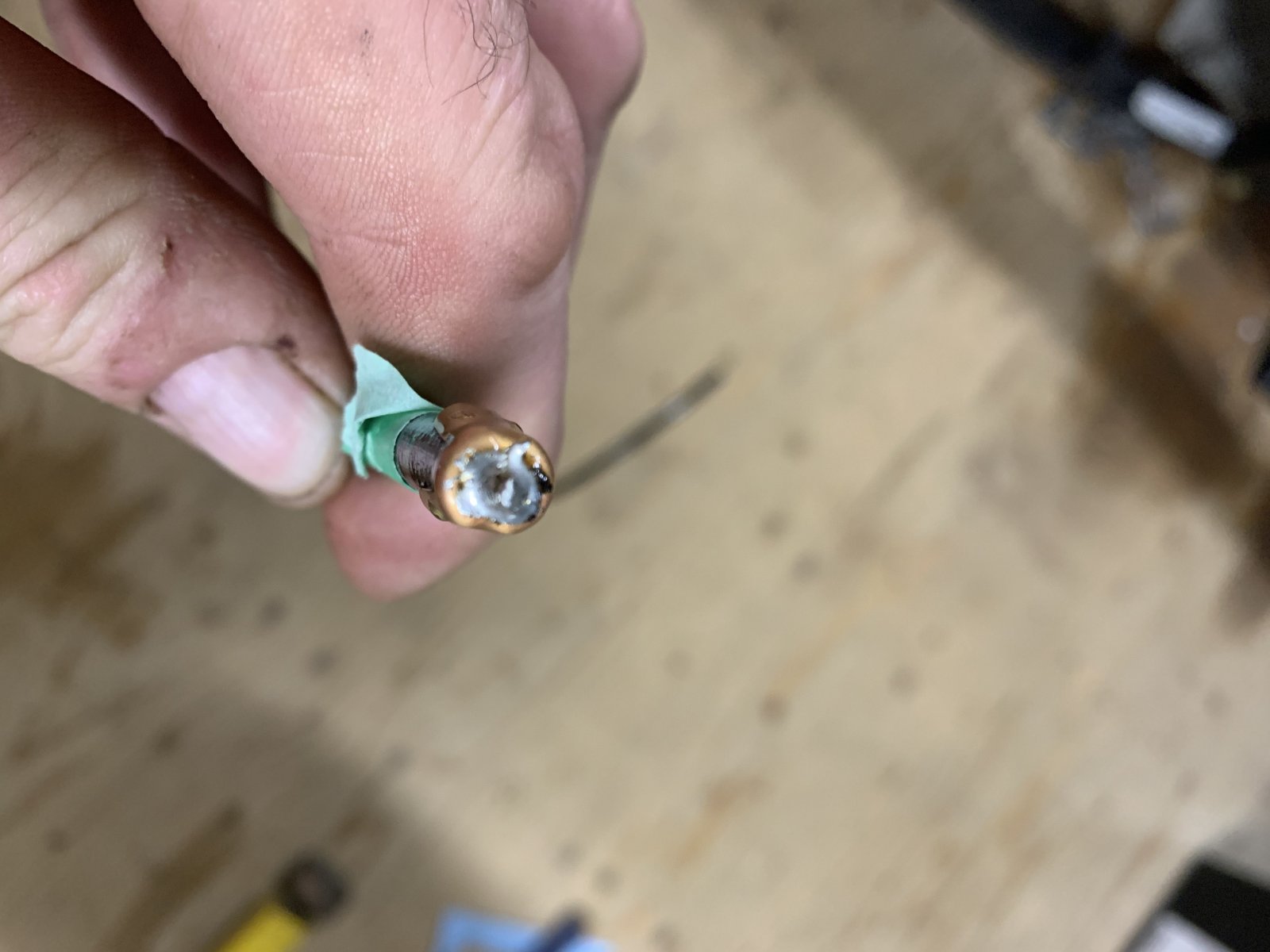

    Got all my spark plug wire stuff from Brillman. Got the stranded copper wire. One end already had the loop to go over the stud on the spark plug, and I crimped and soldered the terminal at the other for the dist cap.
