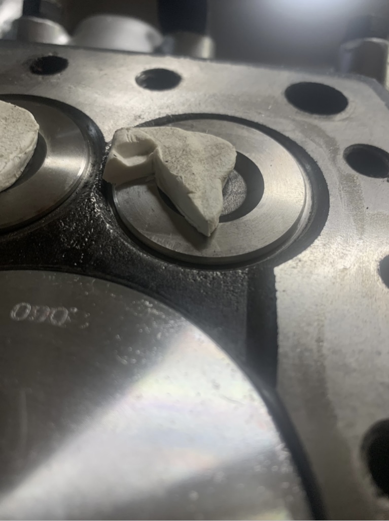

    When ***embling my C59A, I used putty to check piston to head clearance on cyl #1 at TDC. Also, noted the clearance to the plug and exh valve. Heads were stk cast iron, gasket was Felpro (0.055”), and plugs were NGK 3212. Clearance was about 0.128”.

    What kind of "putty"? I have been using foil balls, but I like your results better.
  5. Ziggster
    Joined: Aug 27, 2018
    Posts: 2,951
    Ziggster
    It might have been plasticine. Think I got it at “Michaels”, a craft store chain here in Canada.
