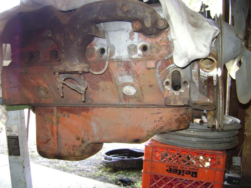

  9. WagonKiller
    Joined: Oct 27, 2008
    Posts: 252
    WagonKiller
    "new to me " engine thanks frank!

  10. biscaynes
    Joined: Mar 16, 2008
    Posts: 1,647
    biscaynes
    is that a '56 or '57 block?....has '57 ex manifolds. ;)

  12. WagonKiller
    Posts: 252
    WagonKiller
    56,Just what the Dr ordered!and it came from a drag racer dude!(altho not a racer of cars this old)Just something he picked up from someone who had it sitting around.he was going to s**** it,or give it to another 55-57 guy.Some friends were talking to him and said hey we know someone who can use that!
    Now all i need are heads and carbs,and to dig in and see whats in there cam wise!
    Pretty sure was F56F or something like that.
    :cool:

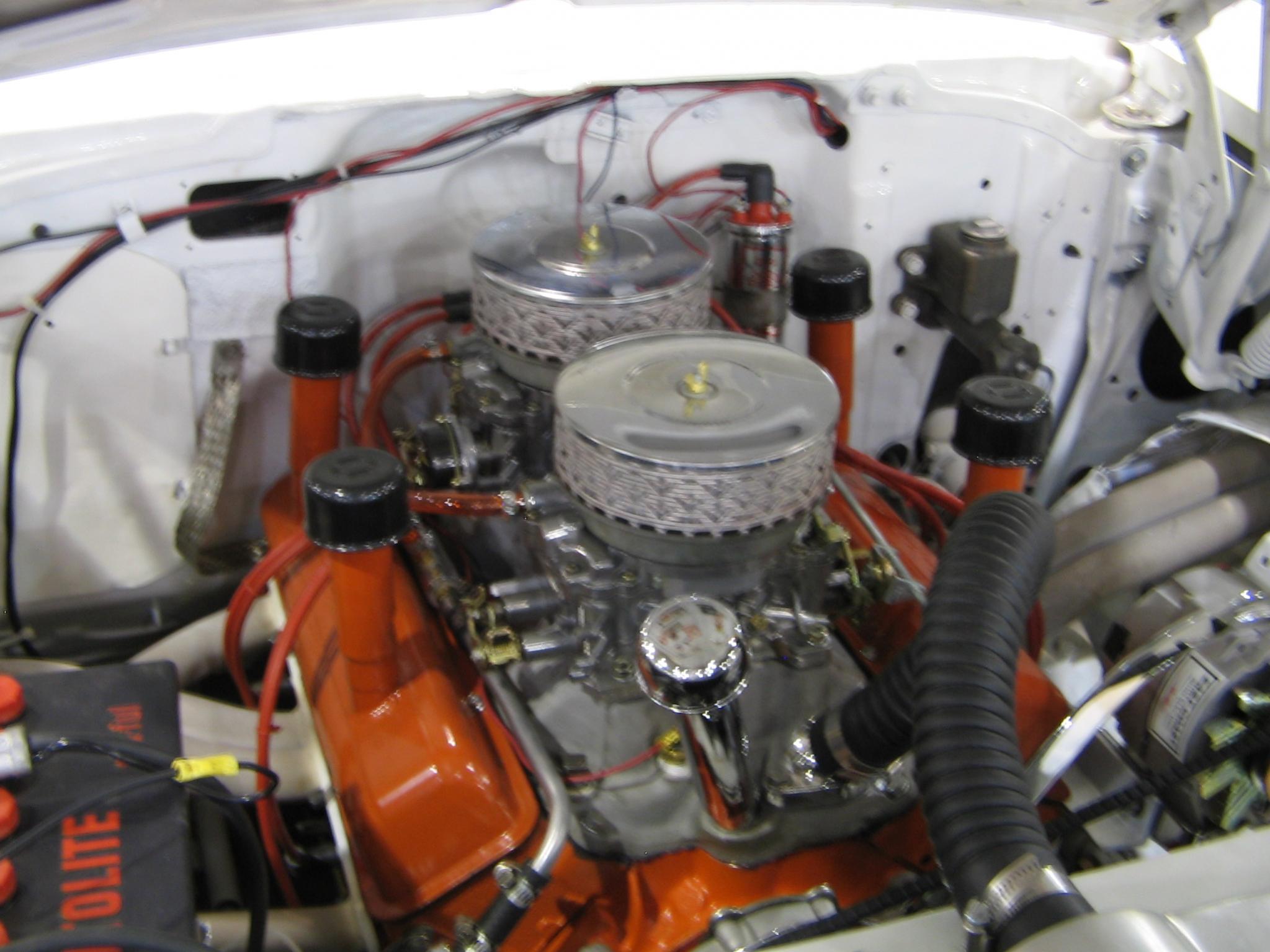

    Hi I have a question. If i put a set of Stahl headers on my street driven Jr Stocker will i lose the use of my fresh air vents Thank You Keith
  14. No the headers will exit under the fresh air vents (this is a '57?). You will have to cut the inner fenderwells. We removed our vents for weight but they were not in the way.
    -Dean

    Early 57 Corvettes had 56 carbs on the 245hp 283. 56 and early 57 245hp carbs had air adjusting screws on the drivers side of the baseplate while the other WCFBs didn't. 270 hp 283 carbs are different. Here is a pic of what you are looking for.
    If you were allowed to run replacemnt carbs the later 270hp versions will flow more air.
    I thought you could use the service replacement heads in Jr. Stock which would allow you to use the 520 castings.

    If you're building a "period correct" Junior Stocker, the #520 heads would be preferable. We went to great lengths to find good 520 heads that had not been subjected to a prior valve job. I bought a set of new 520 castings as late as 1970.
    Up until about '59 the valve cover bolt holes were staggered, i.e., the upper holes, closest to the carburetors, were closer together than the ones nearest the exhaust ports. All the 520 heads that I've seen had the upper and lower holes aligned. Because of this cosmetic difference, I would suspect that a pure restoration of a '56 would be expected to use the staggered valve cover configuration.
