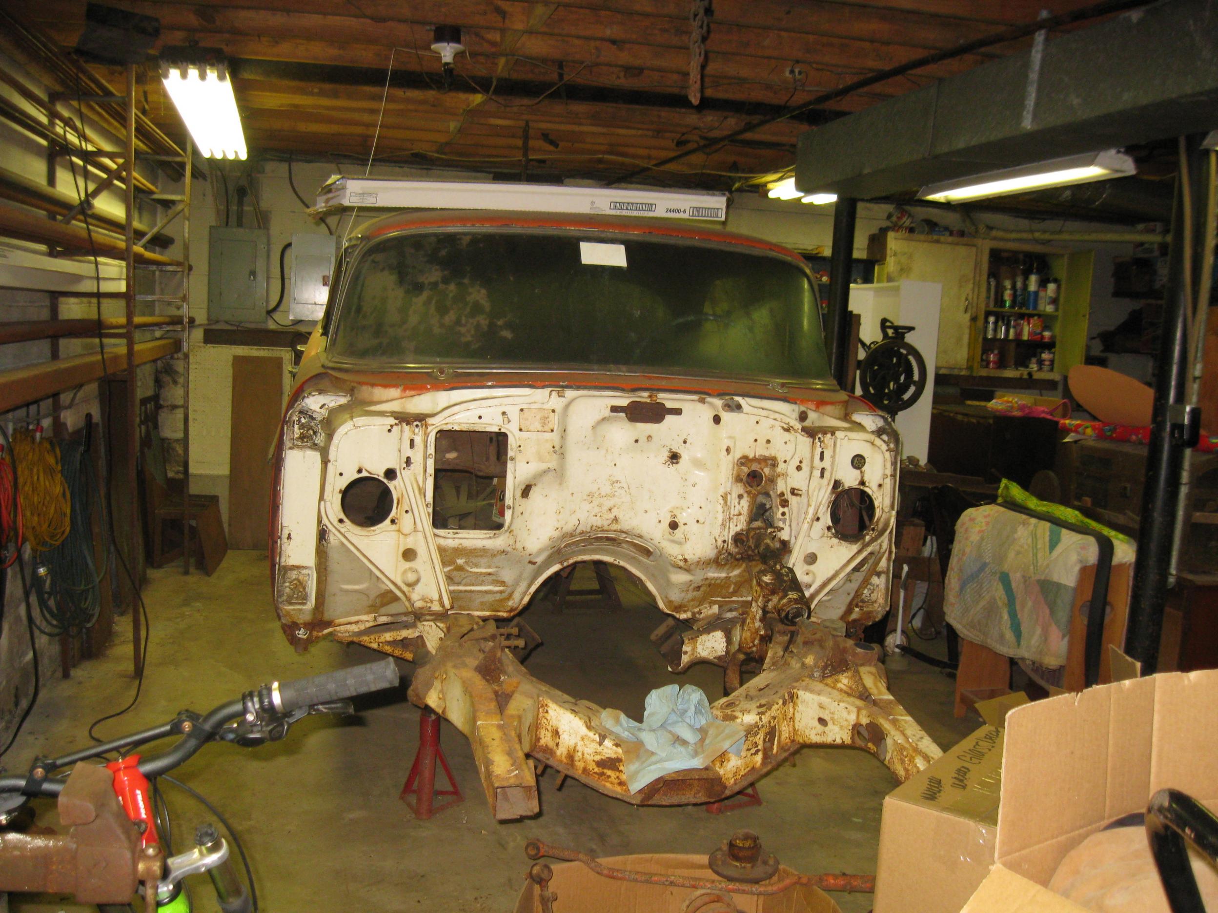

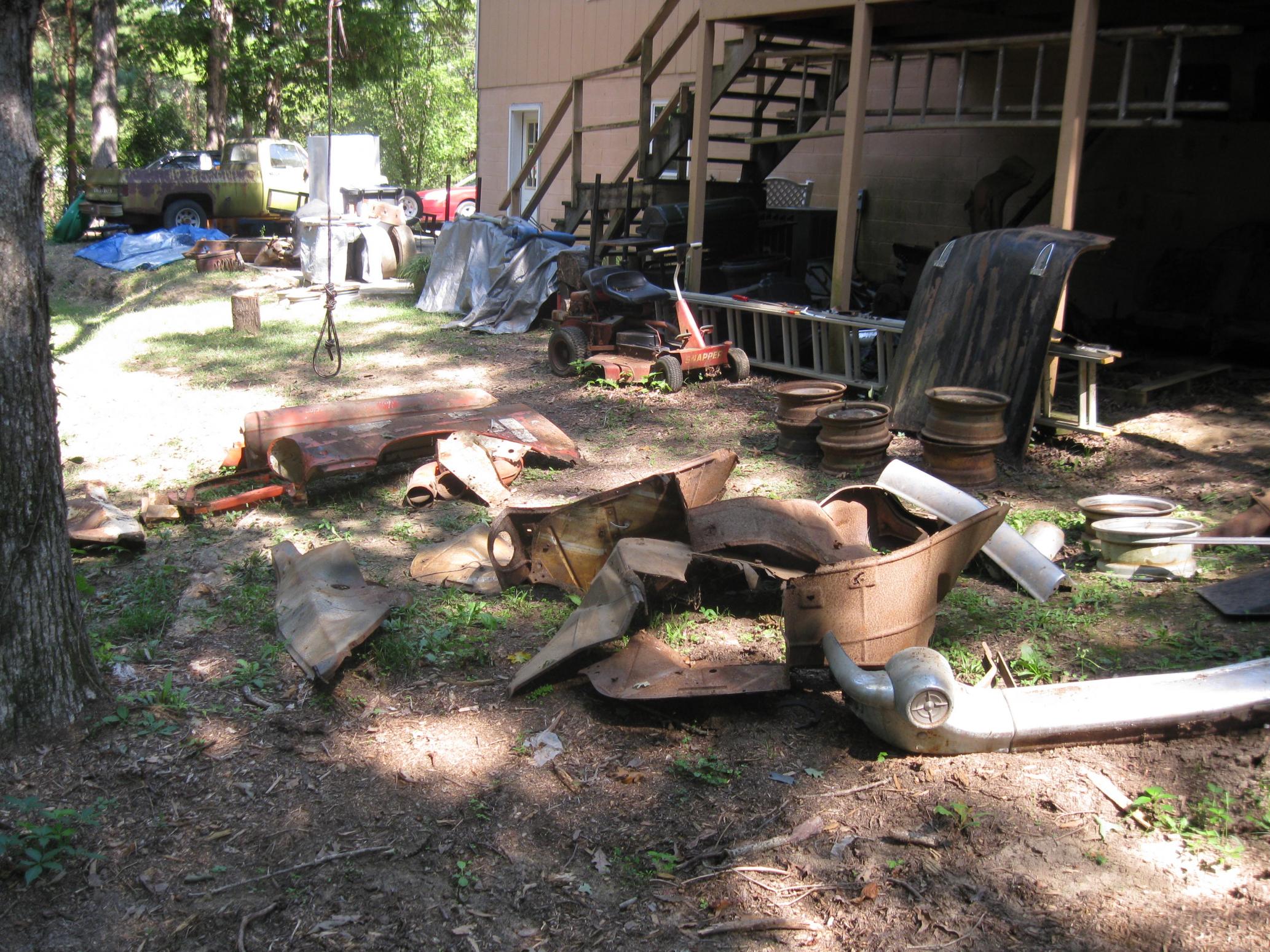

    Well guys, here it is. Looks like I have my work cut out for me. Will need all the encouragement I can get. Thanks to Al for the Dougs fenderwell headers. That was my first purchase. Thank goodness, wife is excited too. Hopes it will keep me out of her hair for the winter.

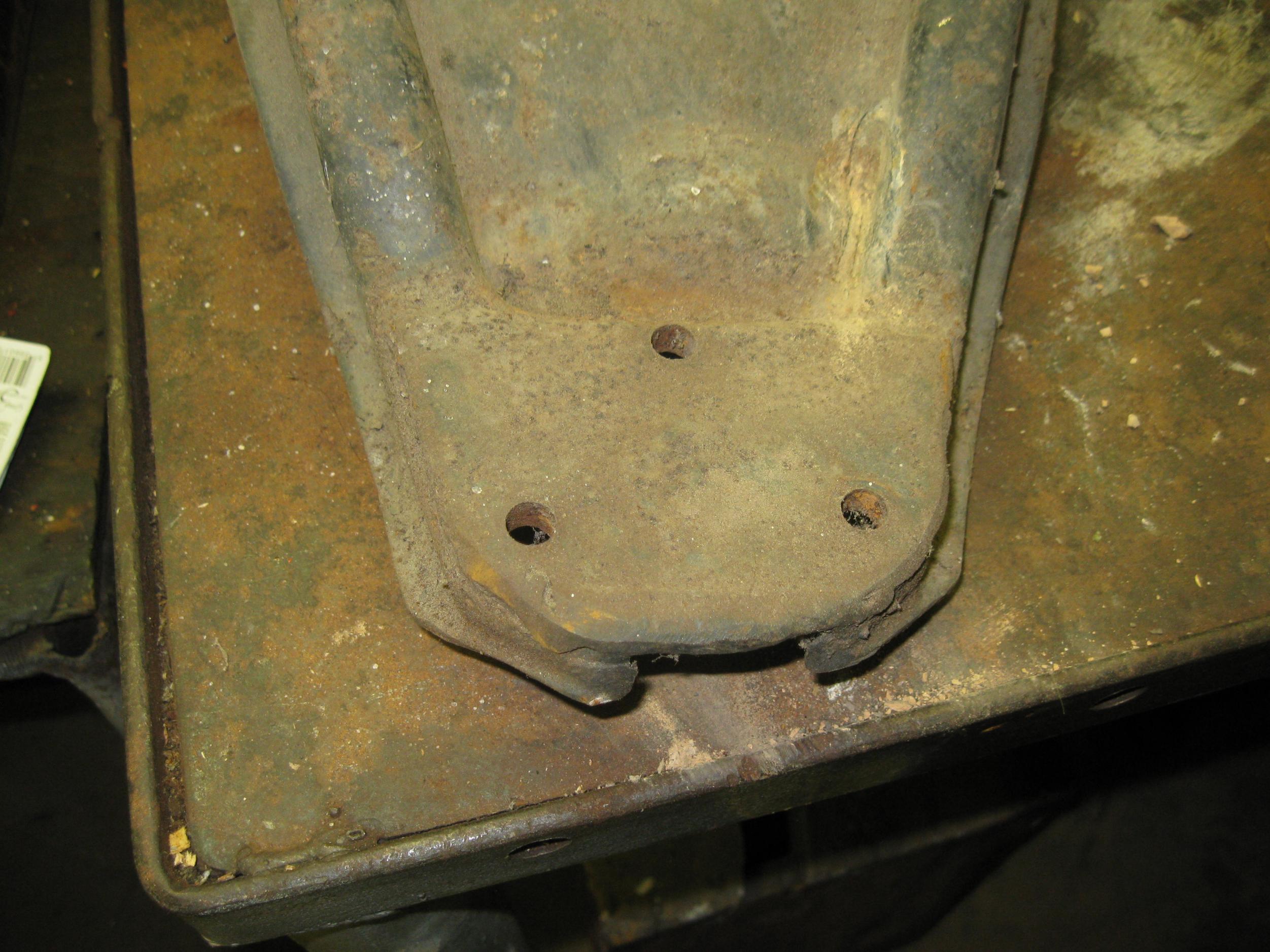

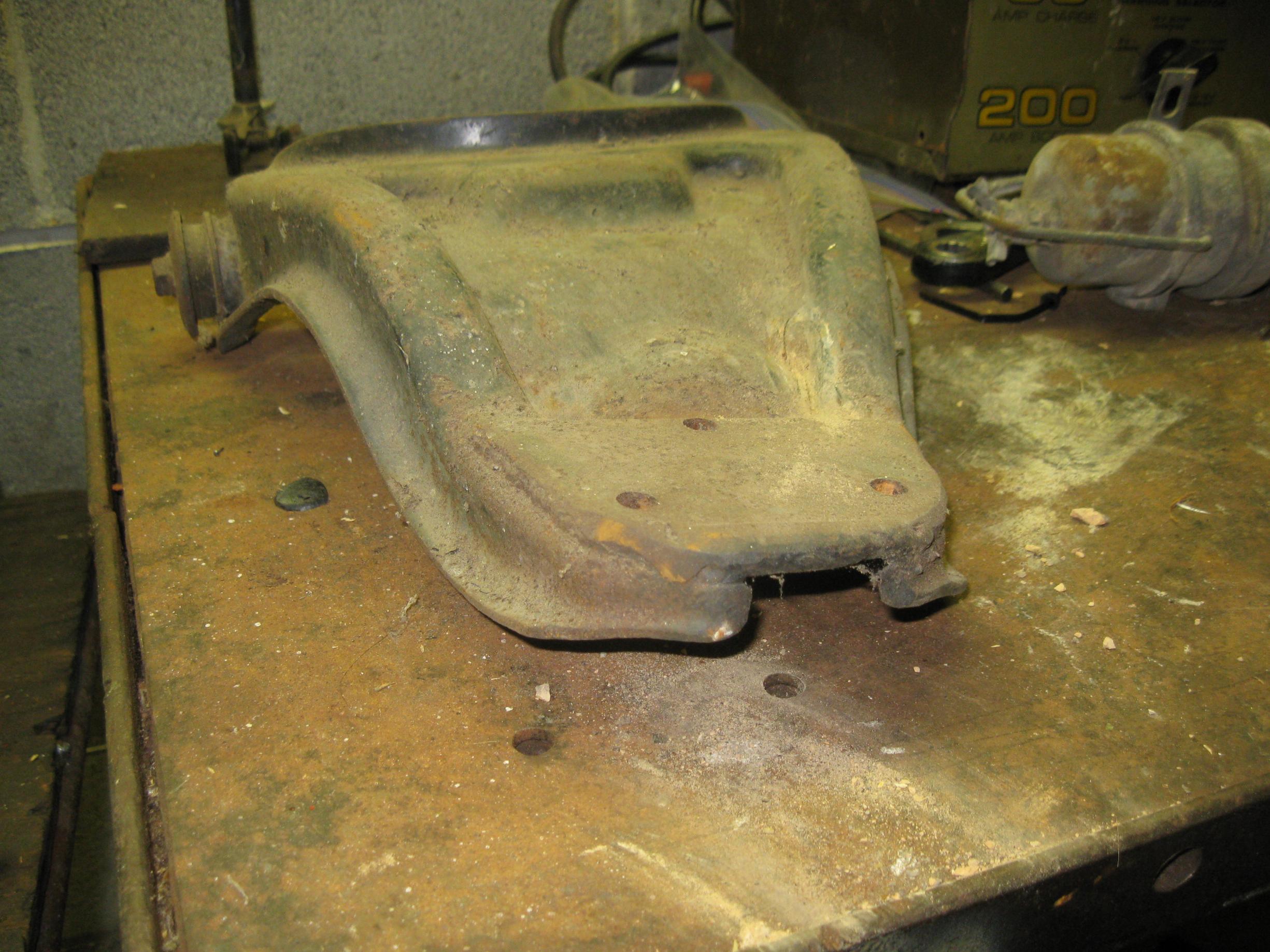

    These are the upper control arms from the "Cart". They were reinforced with 3/16" plate welded to the top of them IMG_5872.jpg

    That car appears to be remarkably complete and in reasonably good condition. Looks like a day or two with a bead blaster on the small parts and a trip to the sand blaster for the frame and you'll have made a real dent in the project. Don't forget to prime any blasted parts immediately to avoid surface rust. My brother lives in Park City and he reported that he had a very wet August followed by a relatively dry September so who knows what the weatherman has in store for you this winter. It will be cold, I'm sure.
    Good luck with the project.

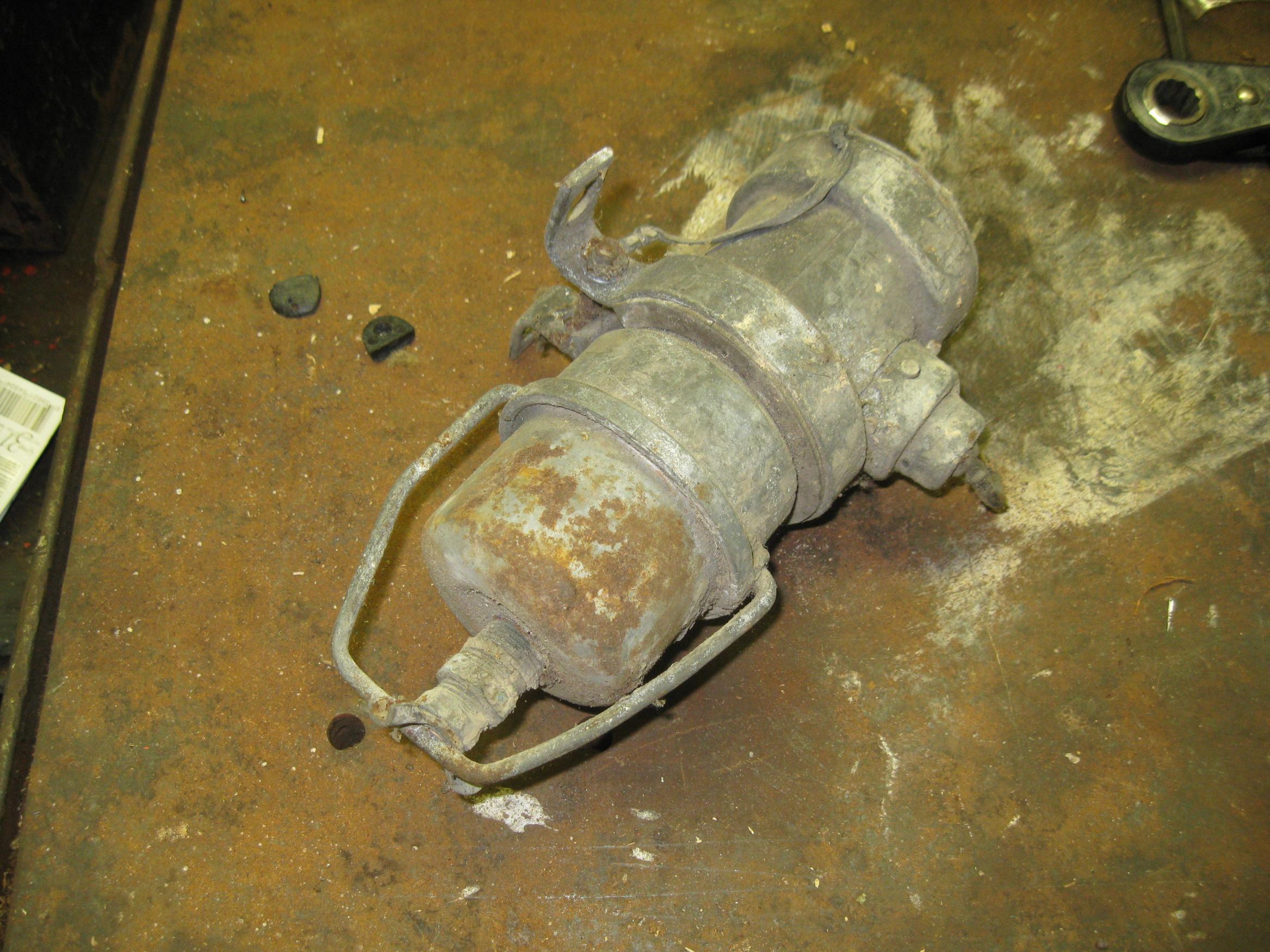

    looks like an old 240 electric stewart warner laying on bench next to control arm. how would you grease upper ball joint with no access to grease fitting? :confused:

    Grease?!? To quote the poet, "We don't need no stinking grease!"
    On the serious side, ball joints were shipped pre-packed with enough grease to run 10 or 20,000 street miles and, after all, it was a drag race car. How many times would that ball joint flex in five seasons of racing in comparison to daily driving in "normal" usage? You gave it a shot with your trusty grease gun when you put it in, ditched the zerk, and you were ready to go.
    I apologize if my response seems off-the-wall. The statement was not meant to come off as any more of a smart-ass than my reputation can already justify but in those days we were all about getting the job done as expeditiously as possible with as little wasted motion as possible. We were on a continuous mission to find as many weak links as we could and resolve them as quickly and cheaply as possible in order to be back at the track the next weekend. A good percentage of the cars were built with the expectation that they would probably only see a couple of seasons of use before they were obsoleted by a wild record-setting session at a mine-shaft track like Fremont or Atco in March or enough funding could be located to move to something newer. Most racers were not as emotionally devoted to our cars in 1969 as are the readers of this thread in 2013. One of the first really thorough jobs of prepping a tri-five Chevy on the west coast was done by Joe Allread and, after the magazine articles appeared, a little more attention was given to cosmetics but, for the most part, function trumped form for guys who were working full-time jobs and raising families as well.

    The ones I studied had the bracing steel follow the A-arm and the ball joint spacers had a hole in them to access the zerk

    No offense taken Chuck. You are right did not worry about greasing them, that grease lasted longer than the vaseline used for wheel bearings. Yes, that is the original SW fuel pump. After seeing prices for new ones, I am hoping to rebuild (see photo). Also of interest is the photo of Forgedtrue with 4 ring groves. Had a local machine cut for the latest dykes setup. Engine was originally build by Lee Crupi. I purchased from Jerry Hallman. Cam box in photo contains what I assume is GK#7, as a G stamped on the end. Did not run as good as #5 but sounded like it should.
