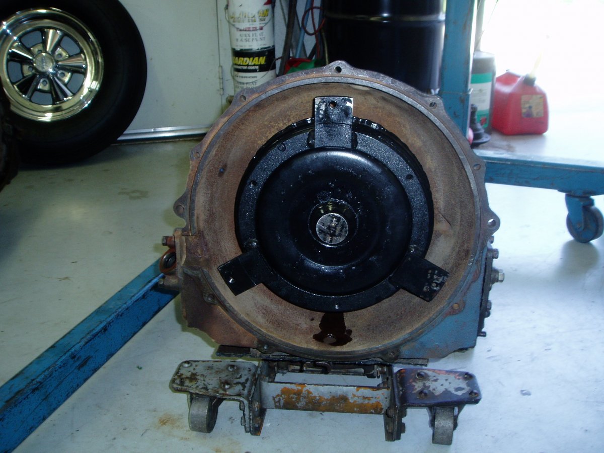

    The convertor in Kyle Marshall"s car is out of a Cortina I think he told me. Had it built by some guy in Indy.

    Small English Ford
  22. It's a 9" core from an English Ford that came with the 1600 Ford (Kent ) pushrod engine, later used in the very first Pintos. Pre-dates the 8" Opel by a year or so. Used to build the original B&M Mopar J converters.
    Modern 9" cores include the GM 245 mm, and the Toyota unit .(slightly bigger than the Opel, but usually equipped with an Opel style stator for racing applications.

    Thanks Mark, yes it is a 9". Here's a picture of the one in the Marshall car when I had the trans out.

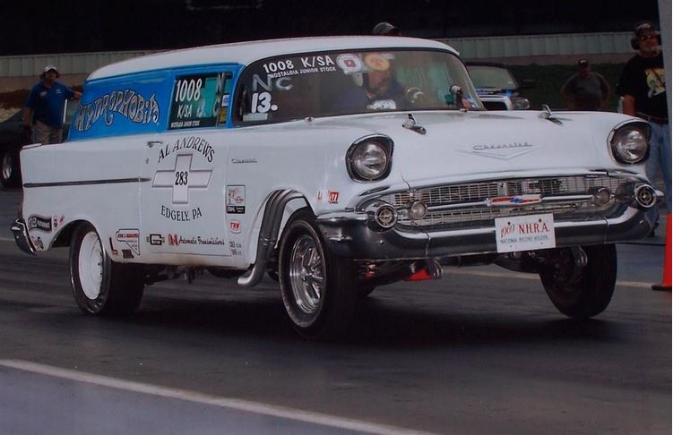

    New Hydrophobia

    LB - Any more of the new Hydrophobia? Ultra sano, tow tabs & left front about to touch off the ground!

    I will keep an eye out had some but in some shots not HAMB friendly

    My good friend Al Andrews owned that car for many years.He just sold it recent ly . He put it together with all rare period correct parts.You are right the car was sweet. I am still kicking myself for not buying it.

    I just had never heard of a cortina, but not much into British cars or fords for that matter.. just a joke!! Thanks for the converter lesson. I remember back in the day when people bought up all the vega conv around. They ran a TH spline in the powerglide input. In 73 went to a TH ******. What is the difference in a iron glide conv. and alum glide conv. as far as splines, snout etc. I have never built or even seen a iron glide. I don't imagine they make a tunable conv for them. So got go with the tell them what u got & what u r going do, hope for the best ,option. No disrespect to conv builders most work ok, but there's some junk out there. When u get 1 that is so lose it biilds so much heat it smokes everything in a ****** u just built for a guy, well u know. I'm sure they have problems with ****** builders to. Thanks for any info.
